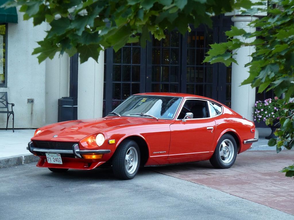

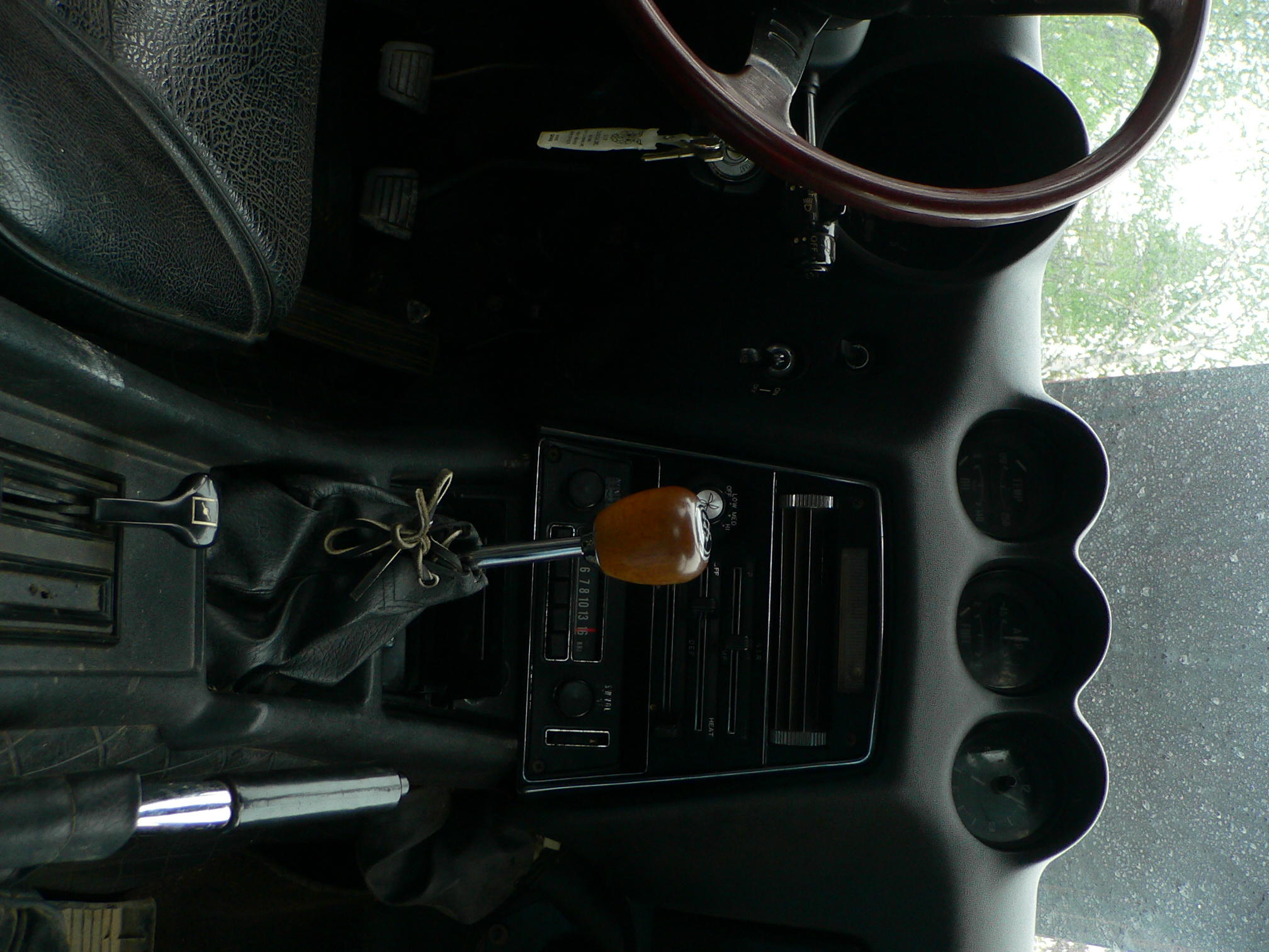

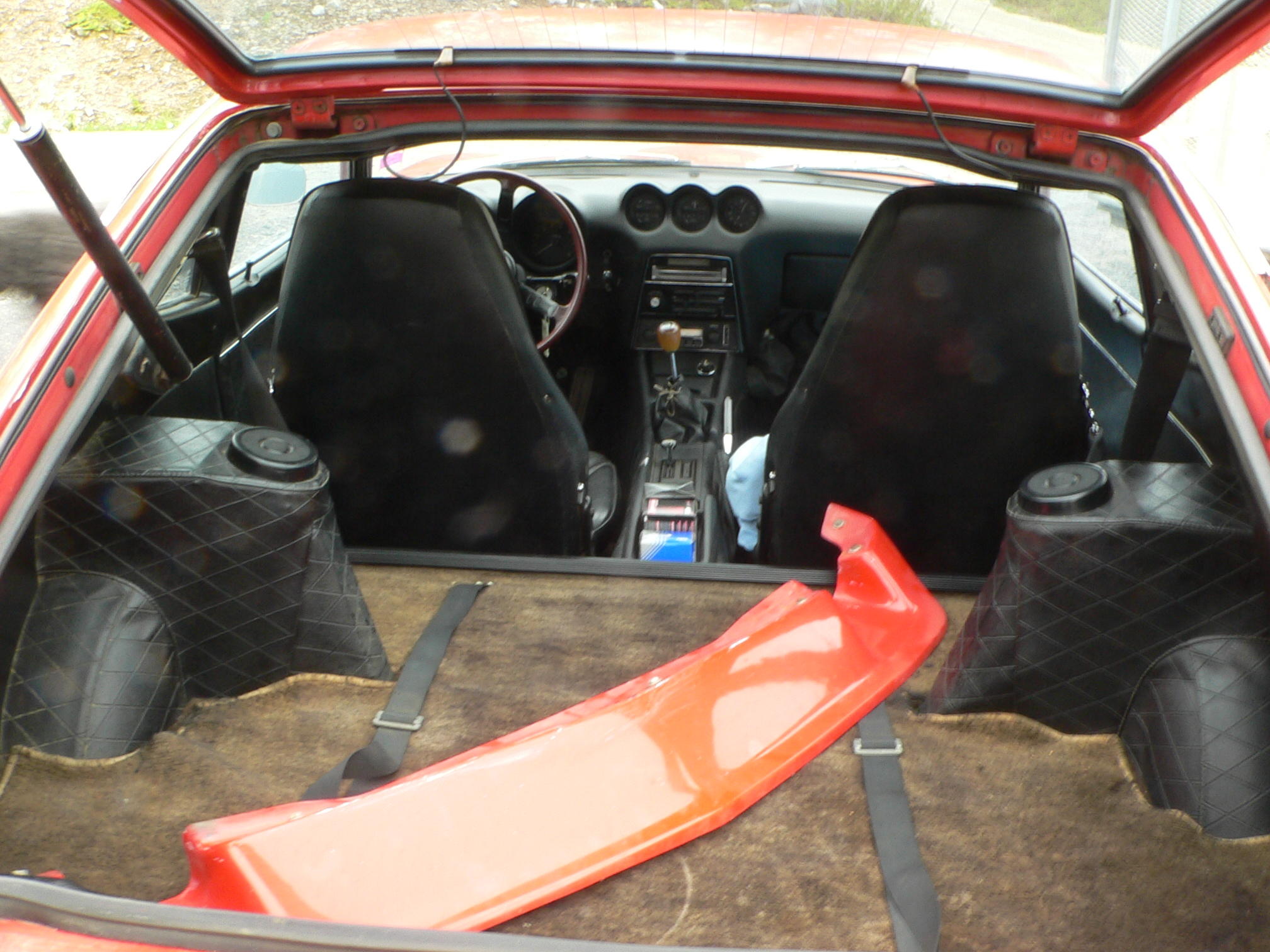

March 12, 20204 yr comment_594198 I agree, it may have been replaced. Here are some photos: @Dr. 240Z is the owner. He bought it in 1971! Link to comment https://www.classiczcars.com/forums/topic/63689-early-vs-late-series-i-240zs/#findComment-594198 Share on other sites More sharing options...

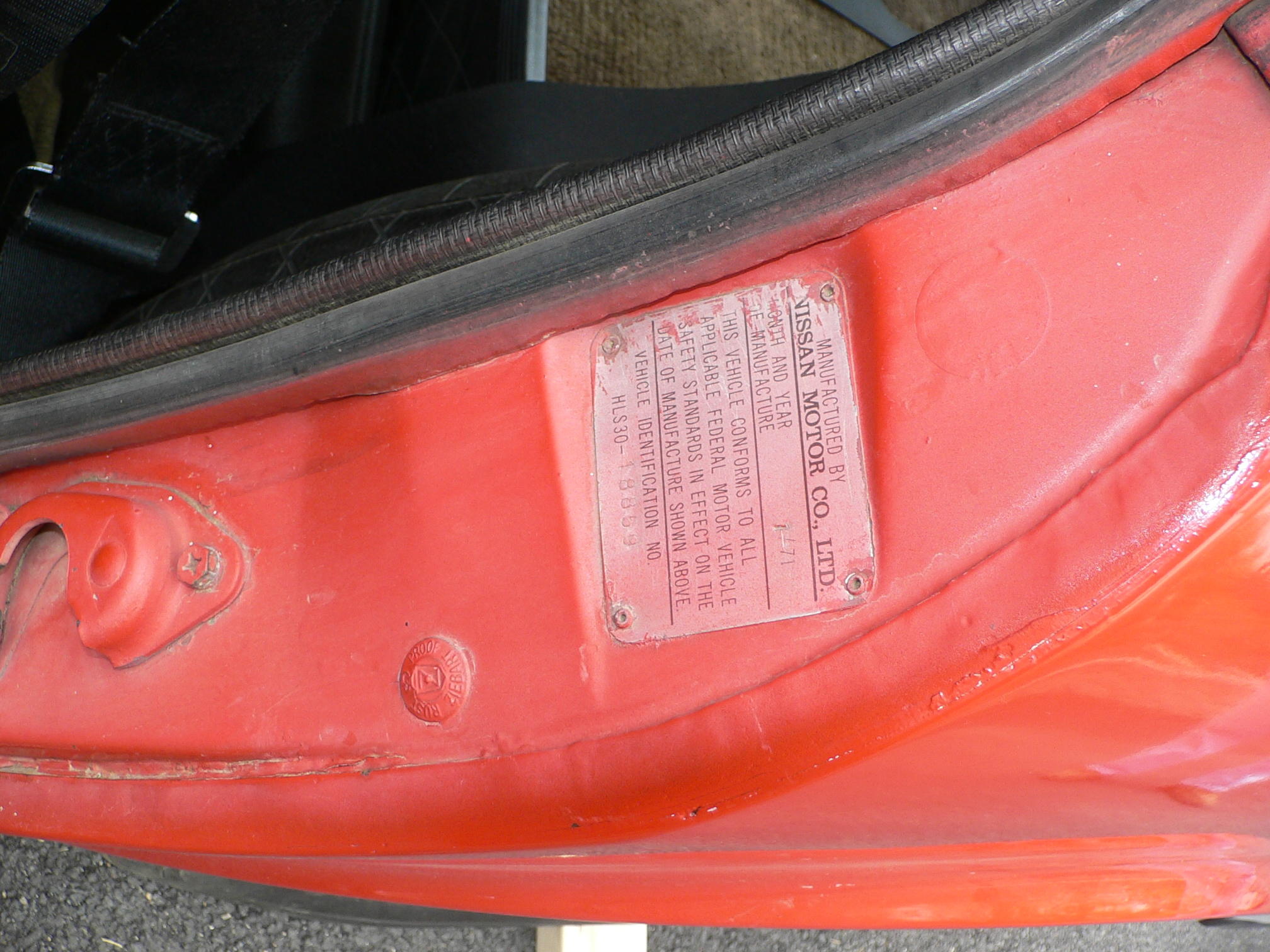

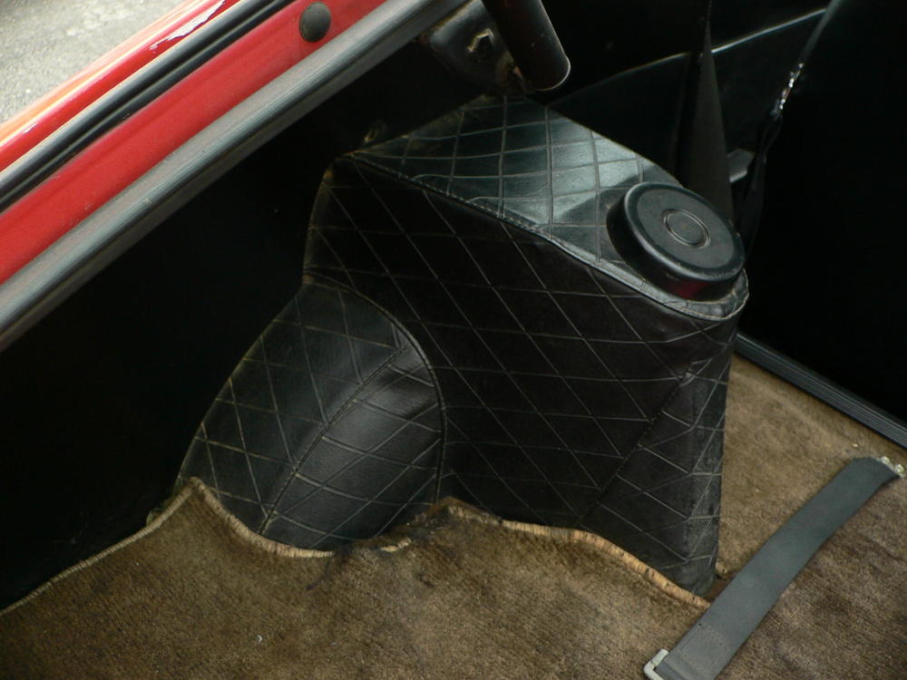

March 12, 20204 yr comment_594199 My 2/71 HLS30 23471 IZCC #7130had: Vertical defrost side vents not hatch vents OHC Valve cover Fuel door latch/knob missing air cleaner and radio when I acquired it seat belts different from earlier cars interior PS rear panel for smaller overflow tank early seats Link to comment https://www.classiczcars.com/forums/topic/63689-early-vs-late-series-i-240zs/#findComment-594199 Share on other sites More sharing options...
March 12, 20204 yr Author comment_594200 240260280, very nice transformation after clean up. 7tooZ, I think given your VIN#, you may have a very early Series II car. I believe the series one cars ended somewhere around 21,000. The way it's equipped would seem to suggest that. Link to comment https://www.classiczcars.com/forums/topic/63689-early-vs-late-series-i-240zs/#findComment-594200 Share on other sites More sharing options...

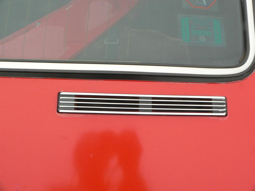

March 12, 20204 yr comment_594201 3 hours ago, 26th-Z said: I can help you with one thing in particular. If your 'C-Pillar' badges are 240Z emblems, the hatch has vents below the glass. If your badges are round and you have holes in the side of the 'C-Pillar', then the hatch does not have vents. Ahem... Link to comment https://www.classiczcars.com/forums/topic/63689-early-vs-late-series-i-240zs/#findComment-594201 Share on other sites More sharing options...
