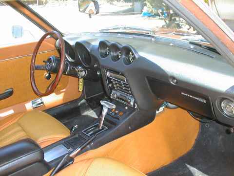

Posted December 31, 200123 yr comment_1643 i got a 73 240z and have recently put in a stereo. After i got it all in i found out that the heater blower motor wont come on. I did clean up some of the wiring in there when putting in the stereo but dont think i disconnected anything. I was wondering if anyone new what wires to check? I think once before the ground wire came off the motor a mechanic told me but i dont know which wire that is? Anyone got a clue? anything else i could check? It really suck driving in the winter withourt a window defroster. Also i noticed that my rear defroster still works but takes forever to defrost the window. Is there a way to put a little more juice in it to defrost the windows quicker? Any ideas on that? Let me know if anyone has run into these types of problems. Thanks a bunch.... I sure love my Z and once before with a previous car without the defroster i hit a parked car cause i couldnt see. I sure dont want that to happen again... Suntadz:confused: Link to comment https://www.classiczcars.com/forums/topic/637-240z-heater-blower-inop/ Share on other sites More sharing options...

January 4, 200223 yr comment_1688 My defroster bites as well. This might sound retarded but when something electrical stops working in my car i usually just give a little tap to the fuse box and whatever wasnt working usually kicks in.. Doubt that's yer problem, but give it a try. I need to take out my whole fuse box and either replace or repair it.And your car looks Very Nice BTW.. from what i can see in the pic. Link to comment https://www.classiczcars.com/forums/topic/637-240z-heater-blower-inop/#findComment-1688 Share on other sites More sharing options...
