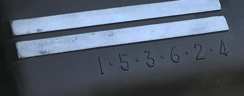

March 26, 20205 yr comment_595484 If you put writing on it.. be sure to include: 1-5-3-6-2-4 Link to comment https://www.classiczcars.com/forums/topic/63749-new-product-idea-distributor-timing-plate-re-design/?&page=2#findComment-595484 Share on other sites More sharing options...
March 26, 20205 yr comment_595502 1 hour ago, 240260280 said: 1-5-3-6-2-4 This could be the name. 153624 distributor mounting plate. Link to comment https://www.classiczcars.com/forums/topic/63749-new-product-idea-distributor-timing-plate-re-design/?&page=2#findComment-595502 Share on other sites More sharing options...

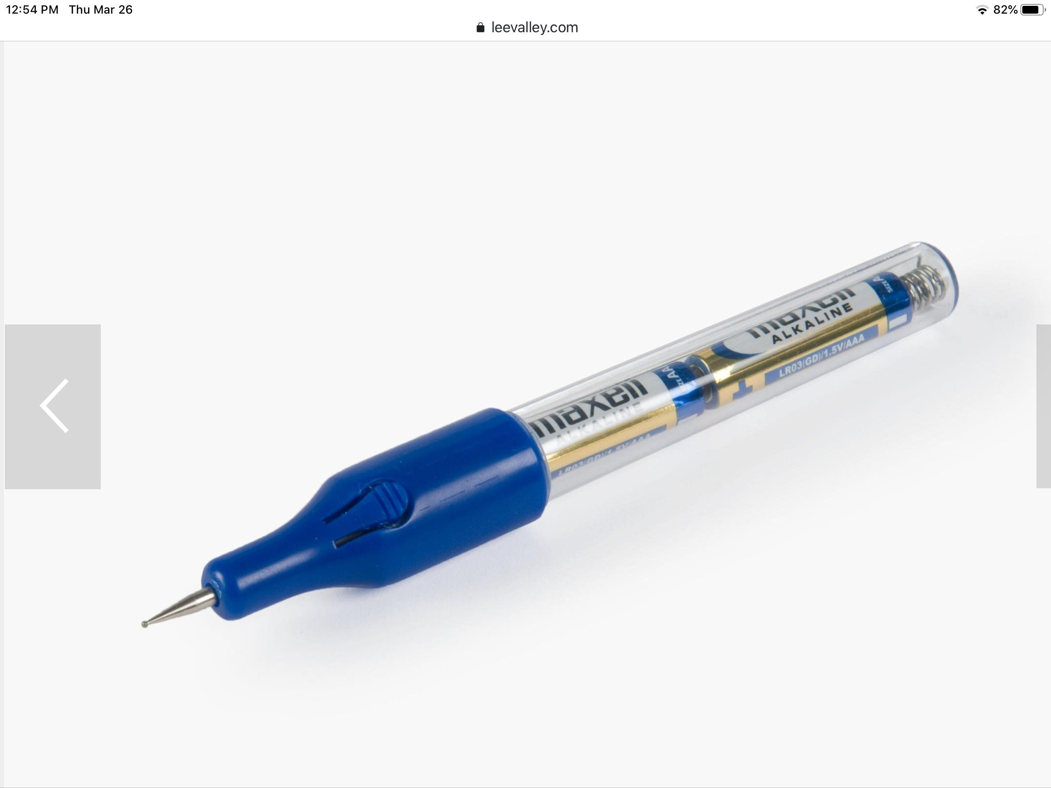

March 26, 20205 yr Author comment_595517 21 minutes ago, Zed Head said: A stamp should work. Even an ink stamp. There's some good inks out there that will hold up. And the stamped side would be the obvious "up" side. I like that idea. A quick browse of laser engravers that can do steel are out of the price range of practicality and $$. I may be able to find a service that does it that makes the per item cost reasonable. I know! I’ll hand engrave and sign each one. Harder to knock off. I have one of these. Edited March 26, 20205 yr by zKars Link to comment https://www.classiczcars.com/forums/topic/63749-new-product-idea-distributor-timing-plate-re-design/?&page=2#findComment-595517 Share on other sites More sharing options...
