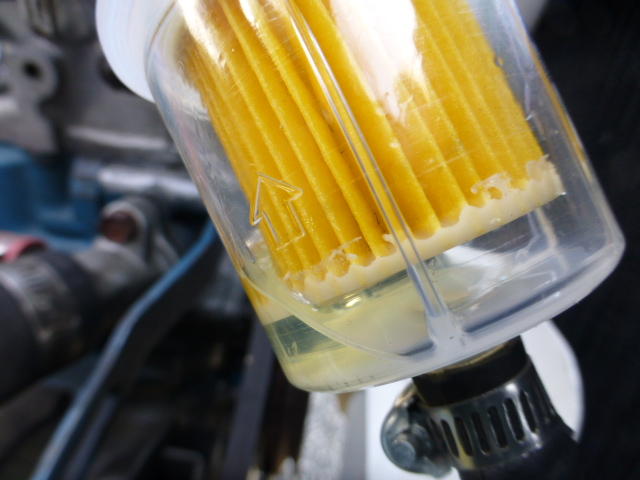

Posted March 26, 20204 yr comment_595492 I'm trying to get my early-'71 all dialed in, and had noticed some running issues. It would sputter under load when I tried to move it while cold. It felt boggy when revving, and would backfire on the overrun. I drained and cleaned out the tank. The supply and return lines are clear. I pumped air through the supply, return, and fuel rail. I also used a vacuum pump to draw fuel through the supply line, and it seems to come readily. I bought a new fuel filter, and upon installing it, it filler up to about 4/5 of capacity, but the running issue remained. After re-checking the lines and adding a bit of timing adv. the car started running well, but the filter is now nearly empty. I also ran the car off of a small glass jar (9oz)of fuel, and while running, it drained that bottle in less than 10 seconds at idle, so it seems like the pump is returning fuel to the tank just fine. Right now, while warm, the car revs freely, with no backfires on overrun. I'm not sure what it'll do after it cools off (will check later), but wonder is anyone knows what's up with that filter. I'd feel better if it filled normally. Link to comment https://www.classiczcars.com/forums/topic/63753-near-empty-fuel-filter/ Share on other sites More sharing options...

March 27, 20204 yr comment_595612 Is the arrow in the picture correct? And the orientation while driving is as shown? And is the picture taken with the engine running? There's no fuel even at the outlet of the filter, to pass through to the carbs. You can get a bubble in the filter if it's on its side, but fuel will still get through, like Mark implies, if the filter outlet is covered. The carb's float bowls will fill until the float valve seals. Try to separate your filter problem from the running problem. They might not be related. Link to comment https://www.classiczcars.com/forums/topic/63753-near-empty-fuel-filter/#findComment-595612 Share on other sites More sharing options...
