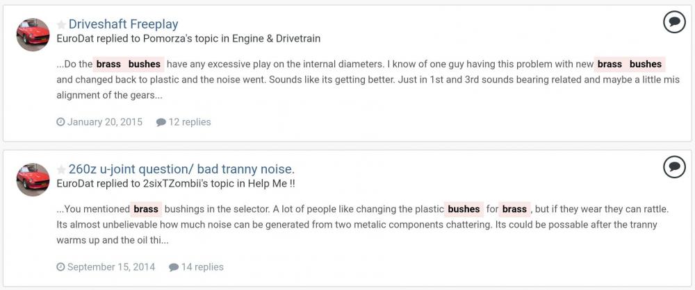

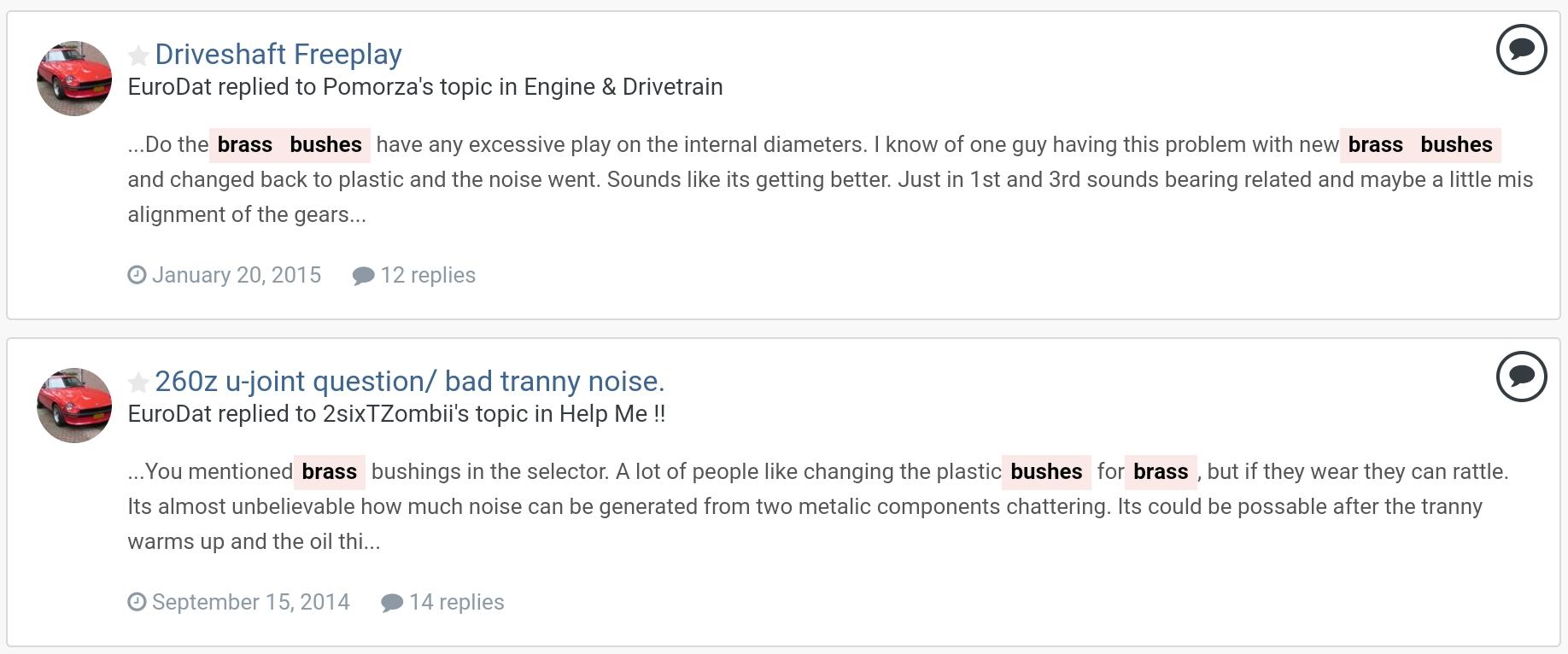

Btw. The brass bushes will rattle if you have play in the pin. That is why I don't reccomend them.

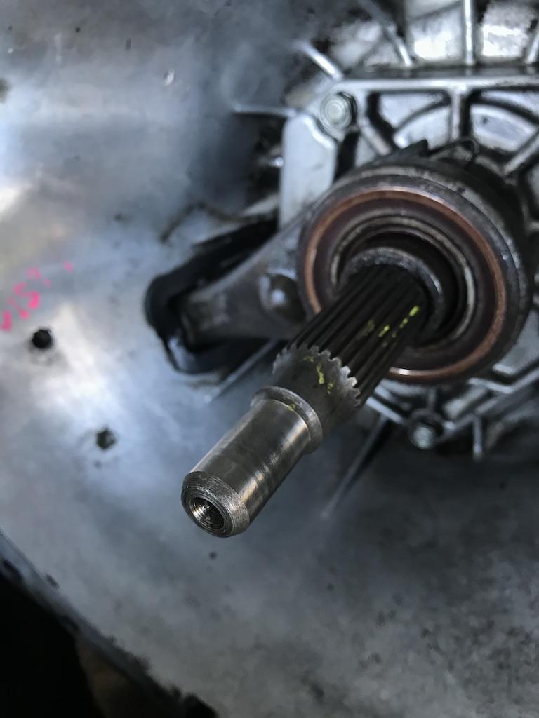

I remembered why I did not take out the ujoints, it feels like there is no play in the joint, but perhaps by hand is one thing, but load of the motor is another.

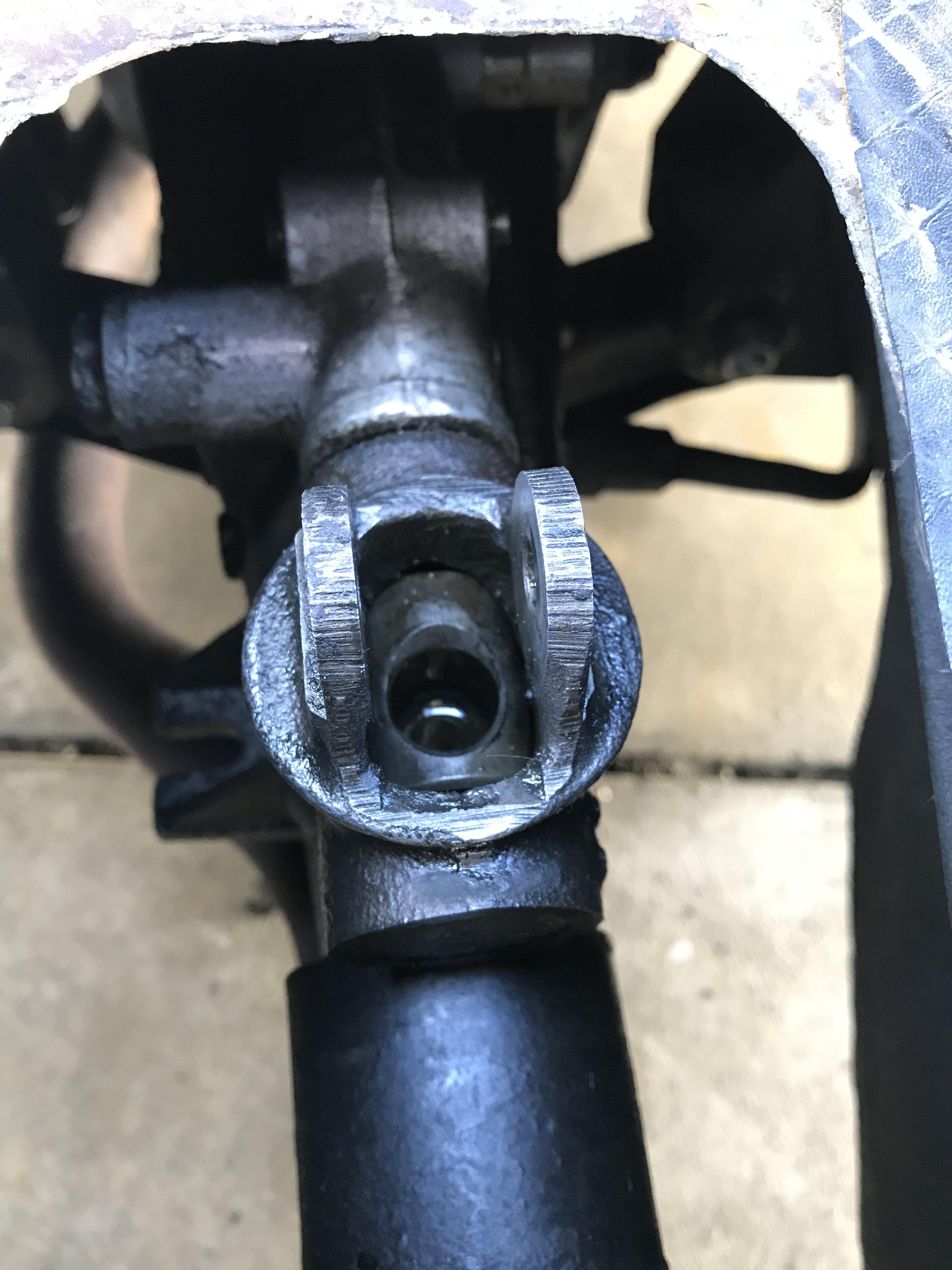

@Dave WM @EuroDat i don’t feel side to side movement of the driveshaft in the tail end of the gearbox, but I’ll inspect again when it’s out of the car, anything else to inspect?
the OEM rear sway bar location for an early 260z is not good, the damn thing is always in the way of the 12mm bolts for the driveshaft. I wonder if there are relocation kits to move it to the back of the support brackets that hold the rear of the control arms.

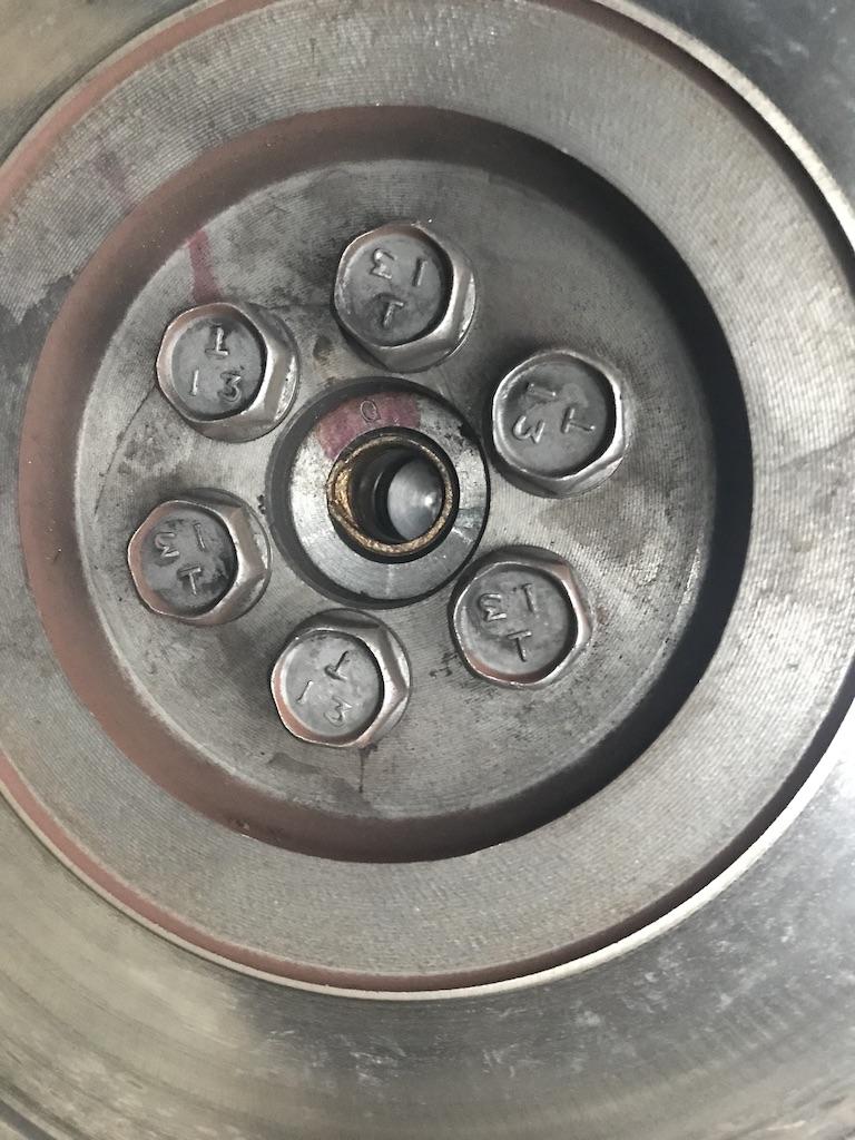

I pulled the clutch out today, i noticed this on what looks like is the brass crank bearing. I dont see any marking on the shaft of the gearbox, I checked for endplay of the driveshaft  and i did not notice anything.
I was going to use the 1983 FSM to help guide me tear the gearbox down. http://xenonzcar.com/s130/FSM/1983/MT.php
Being that this is a close-ratio gearbox I would think it would be the applicable manual to use. Are there any known problems/incorrect directions with the service manual?
