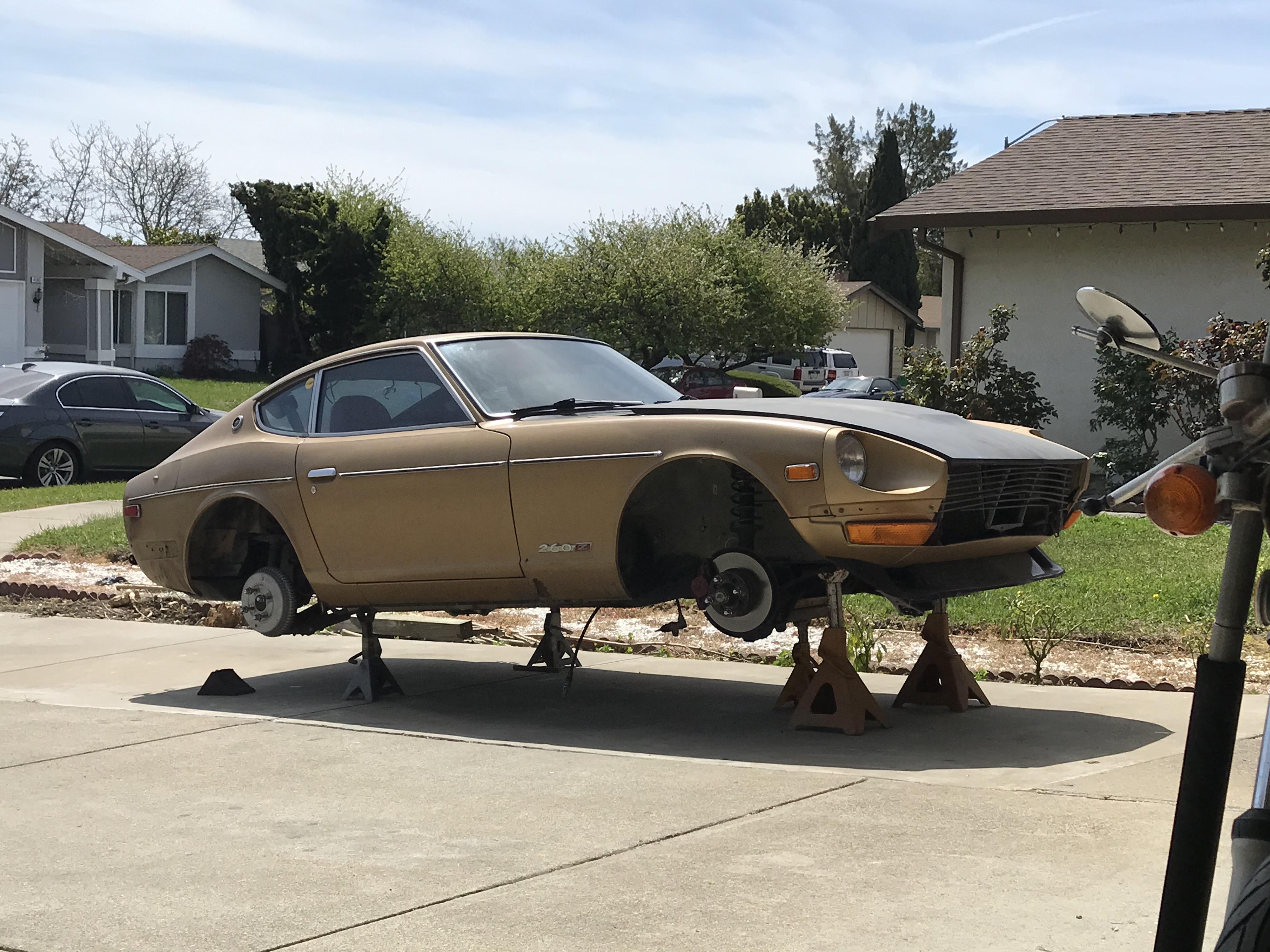

April 11, 20213 yr Author comment_619587 Oh ya. I’d thought I’d share how the car looks on stands.... >.> Link to comment https://www.classiczcars.com/forums/topic/63795-shifter-rattle/?&page=4#findComment-619587 Share on other sites More sharing options...

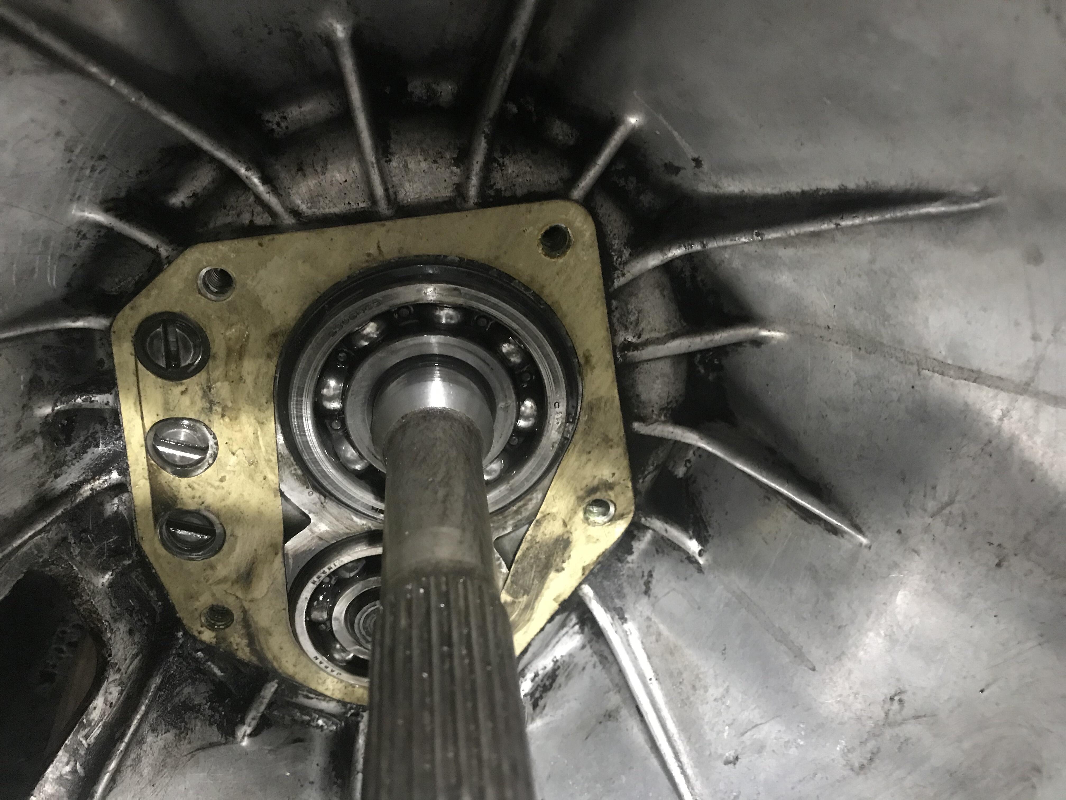

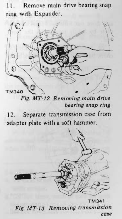

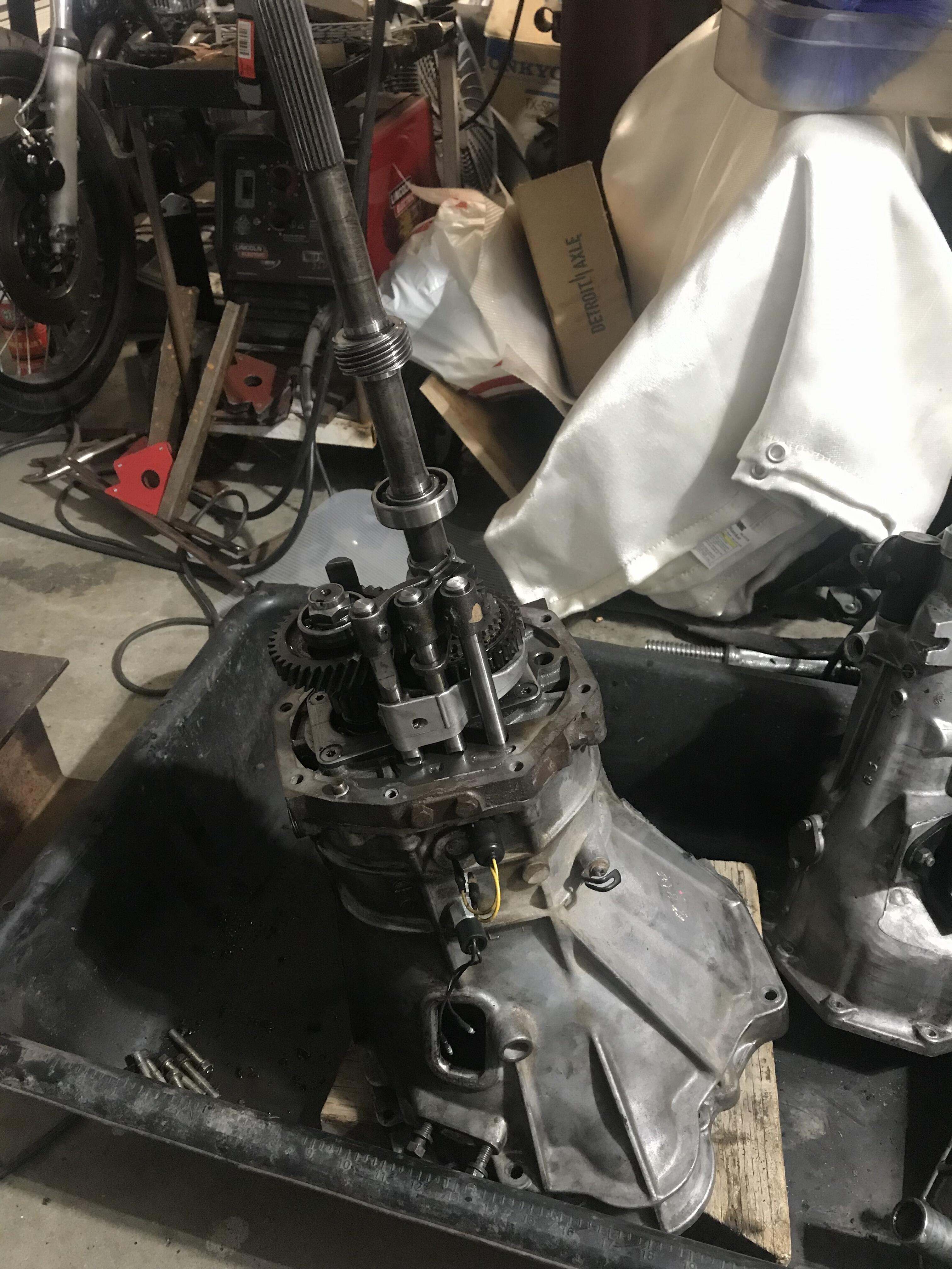

May 19, 20222 yr Author comment_640542 Another year and the Z is on stands with the gearbox out... The car drove good for a while, then recently started to make noises when the car was idling in neutral (and in gear, with little load), depressing the clutch caused it to go away. I looked around and it seems like the counter-shaft bearing is the common culprit of this issue. I was able to remove the snap ring off the input shaft but am not able to get the bellhousing separated, is there a trick to this? I'm reluctant to beat on the casing too hard, i dont want to break anything. There is a ring that goes around the OD of the bearing that can be seen in the second image, is this to be removed as well? Link to comment https://www.classiczcars.com/forums/topic/63795-shifter-rattle/?&page=4#findComment-640542 Share on other sites More sharing options...
May 19, 20222 yr comment_640550 8 hours ago, heyitsrama said: There is a ring that goes around the OD of the bearing that can be seen in the second image, is this to be removed as well? Link to comment https://www.classiczcars.com/forums/topic/63795-shifter-rattle/?&page=4#findComment-640550 Share on other sites More sharing options...
May 19, 20222 yr comment_640571 23 hours ago, heyitsrama said: There is a ring that goes around the OD of the bearing that can be seen in the second image, is this to be removed as well? Yes, you MUST remove the circlip. The input shaft will not come off with the bellhousing because the input shaft spur gear (gear teeth for the 3rd/4th hub) is larger than the gear and hits the front cluster shaft gear. Once you remove the bellhousing, you can remove the front cluster shaft bearing and gear with a puller and some heat and then the input shaft will come free. Edited May 20, 20222 yr by EuroDat Typo Link to comment https://www.classiczcars.com/forums/topic/63795-shifter-rattle/?&page=4#findComment-640571 Share on other sites More sharing options...

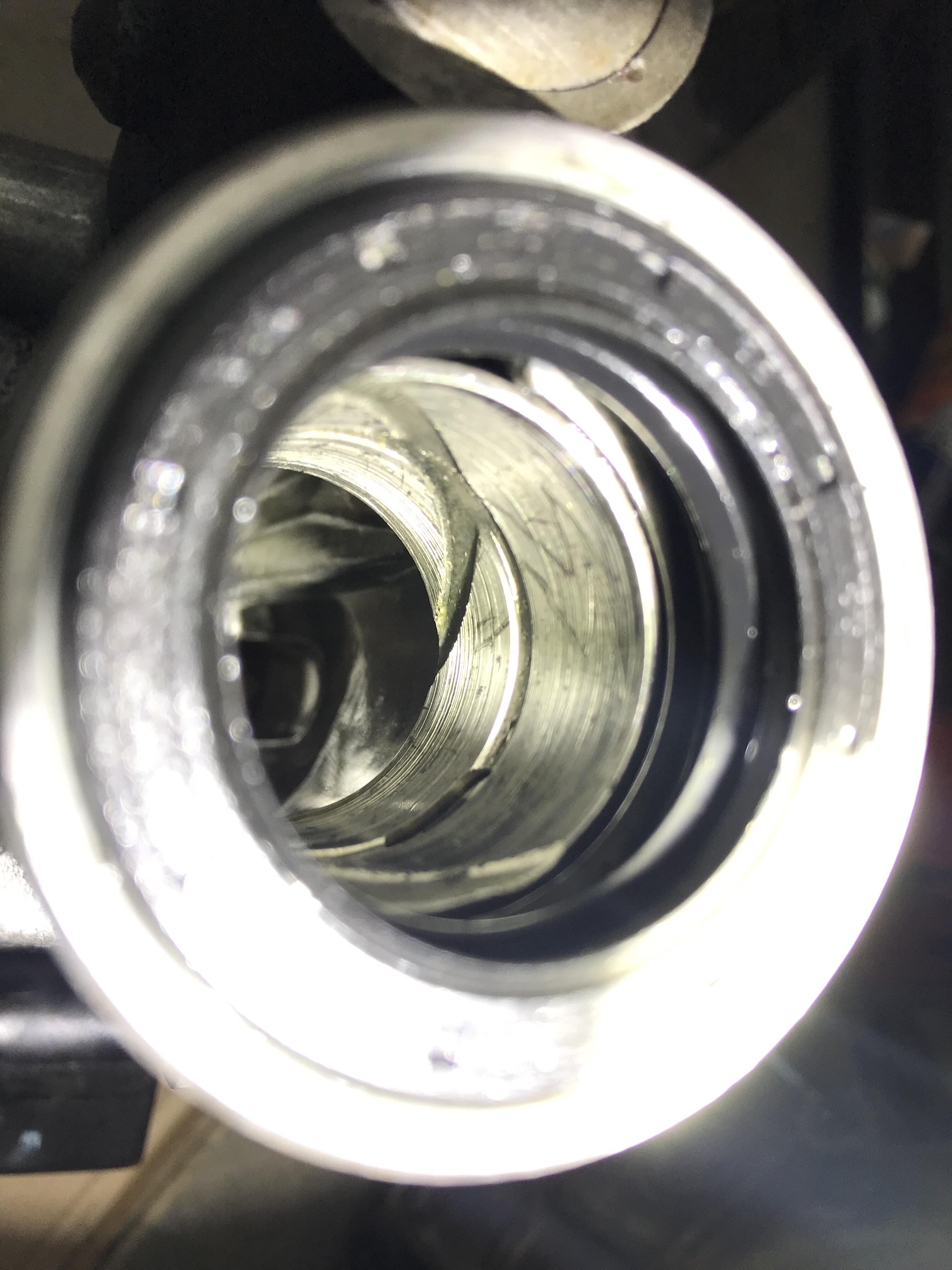

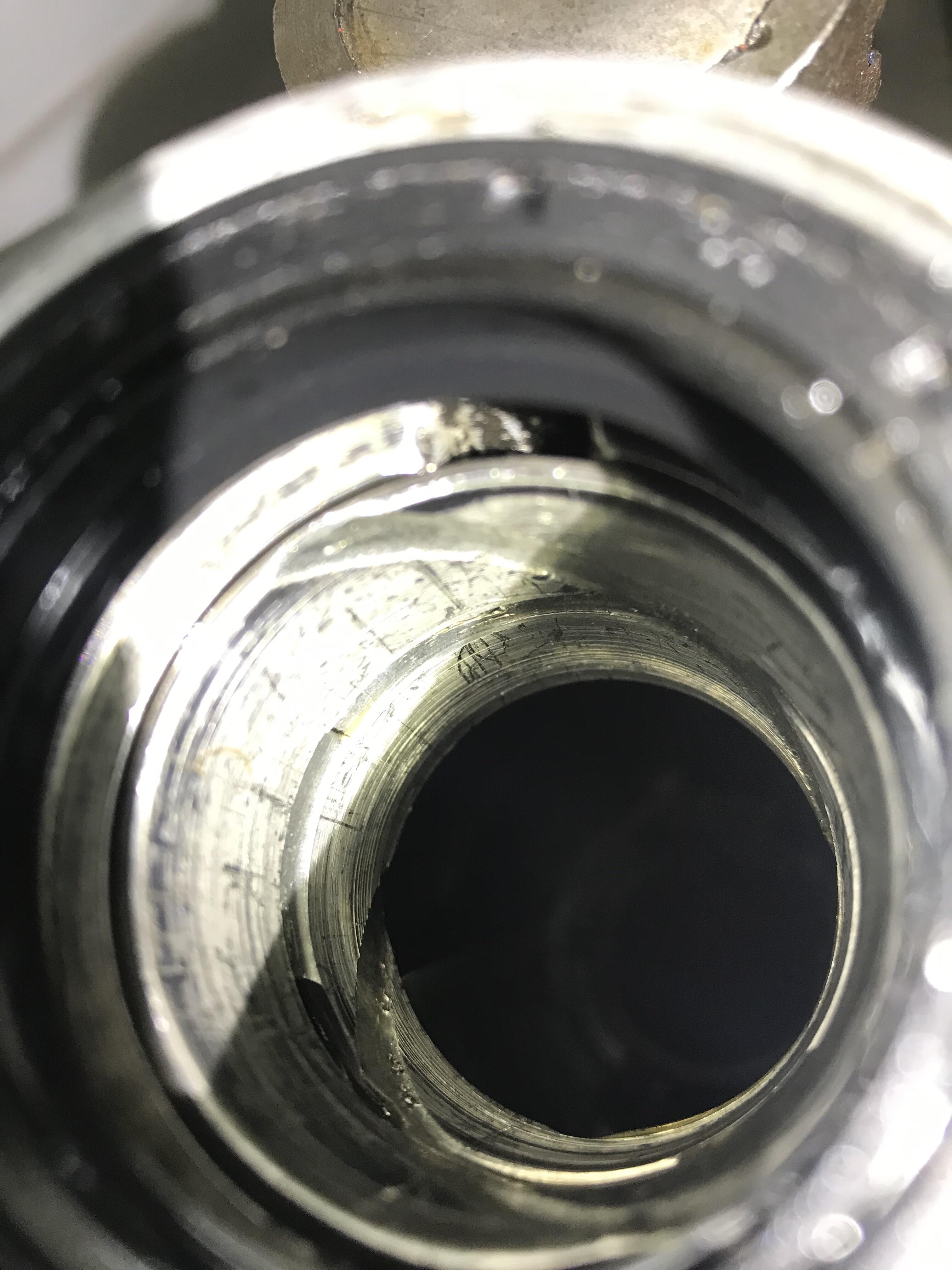

May 21, 20222 yr Author comment_640640 On 3/26/2021 at 5:33 PM, Dave WM said: you may want to take a hard look at the tail housing bushing while you are in there. Check for side to side play in the drive shaft where it goes into the trans. I failed to take this advise last time and now I'm doing all this work over again... On 3/26/2021 at 11:19 PM, EuroDat said: Like Dave said, check the play in the rear bush before you do anything with the transmission. Nissan don't sell them, but you can order a replacement through Omega Machine & Tool p/n:71411. Thanks for the part number to reference @EuroDat This bushing certainly looks beat up, I'll order a replacement. I got the gearbox on a vise this morning, whats weird is that the bearings visually look (and from spinning the input shaft) fine, i don't notice much play in any of the bearings, all the retainers are still present between the ball bearings. Before I pulled the gearbox out, the same shifter rattle was getting louder in 3rd gear... I noticed one of the nuts was loose on the backside (still staked down though). Link to comment https://www.classiczcars.com/forums/topic/63795-shifter-rattle/?&page=4#findComment-640640 Share on other sites More sharing options...
