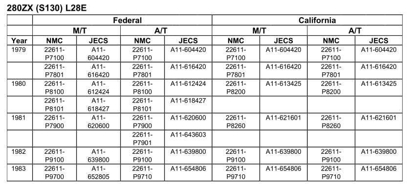

Posted April 7, 20205 yr comment_596572 So I believe the ECU on my 1980 280zx went bad, so I ordered a new one off of ebay to test it. But there was a problem: they sent me one for an for a 1981 280zx. I was going to send it back, but before I did that I thought I'd ask; would it work on my car? I did some research online and found that it should, but I didn't get anything definite. Does anyone know if the one year difference in the make of the ECU will affect that car? The plugin looks the same if that makes any difference. The part number I got was A11-618-427. I believe the part number I need A11-604-420 Edited April 7, 20205 yr by 12meese Link to comment https://www.classiczcars.com/forums/topic/63812-1980-280zx-ecu-swap-dilemma/ Share on other sites More sharing options...

April 7, 20205 yr comment_596576 420 shows as a 79 ECU. Many of the ECU changesĀ seem to be more for emissions reasons, I think.Ā It probably won't hurt to try it just to see if the ECU is your problem.Ā The main inputs will be the same, there's really nothing to damage. Link to comment https://www.classiczcars.com/forums/topic/63812-1980-280zx-ecu-swap-dilemma/#findComment-596576 Share on other sites More sharing options...

April 7, 20205 yr comment_596585 I think it shows that the computer number doesn't matter that much.Ā Nissan probably switched over as inventory ran out.Ā Your 1980 is probably an early build date 1980 so it got the last of the "1979" ECU's. Link to comment https://www.classiczcars.com/forums/topic/63812-1980-280zx-ecu-swap-dilemma/#findComment-596585 Share on other sites More sharing options...

April 22, 20204 yr Author comment_597739 19 minutes ago, Zed Head said: Which ECU? A11-618-427 is the computer replacement that fixed the over fueling problemĀ ? Edited April 22, 20204 yr by 12meese Link to comment https://www.classiczcars.com/forums/topic/63812-1980-280zx-ecu-swap-dilemma/#findComment-597739 Share on other sites More sharing options...
