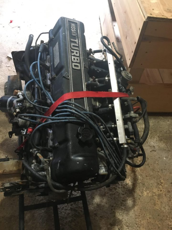

I know I said I didn't want to go turbo, but I found a great deal. I recently acquired a L28ET. It's in pretty great condition. It came with another 5speed, harness ecu, and everything just to drop it i  n. Here is a picture of the motor.
104419984_303114357386645_38777498809312

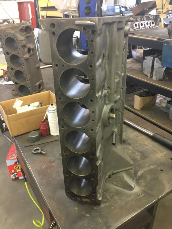

That is a F54 block. Here is my block from the engine shop, a N42.image0.jpg
Anyways, my question is would it be okay if I swapped blocks? What is the difference between the F54 and N42? The N42 block I was building is bored 3 over, with brand new dished pistons and it's balanced. It's almost ready to be put together.
Could I use the N42 block, and the P90 head and run it? Would I run into any problems with the N42? Thanks again for helping me guys. BTW @heyitsrama I discovered I did want a turbo, XD
I'm not on the notify list, but feel compelled to say that there will be little to no benefit from swapping blocks.  Besides that, you'd need new pistons, rings, etc. to fit the "3" overbore (is that mm").  It could get expensive and if the turbo engine is in good shape you're probably best off to leave it alone.
Although his option was not requested, i would listen to @Zed Head , hes never led me astray.
All jokes aside,
I think you would be better off running the turbo motor as is.
from https://datsunzgarage.us/engine/
`The F54 has "siamesed" cylinders meaning that instead of coolant flowing between all the cylinders as on earlier models they are connected between 1-2, 3-4, 5-6 with cast webbing for more rigidity. In addition there isn't a special "turbo block", all Datsun did to make the F54 a turbo motor was to replace the flattop pistons with dished ones to lower compression and add a turbo head. `
but you know you said you did not want a turbo motor, so its better to just send it to one of us and continue your NA build :rolleyes:

I agree with what's been noted above. The F54 siamesed block is an upgrade from the N42. Nissan wouldn't do that for nothing, there has to be an advantage.

The thing is, the N42 block is already built. The picture is old, but all new bearings, pistons, rings, everything. So, if there is no difference would it be better to just put the P90 head on it and run it?  Yes it's .030 btw. So the F54 block has siamesed cylinders? Is that the only advantage? I may just build the NA motor and drop it into a 240z or something. We'll see.
