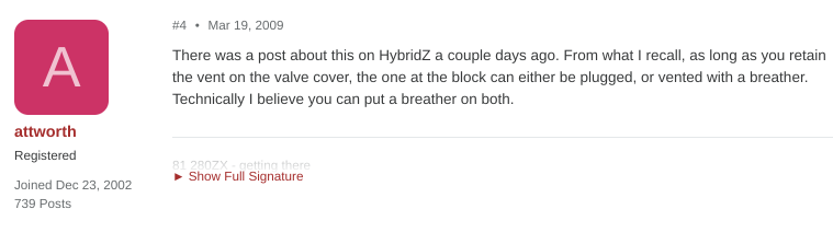

Okay. As long as it's not hurting anything, I'll leave it alone for now and eventually fix it back to stock. It has around 120k miles on it. And yeah ik i wasted money haha. Cuz with the breather blocked off on the block, now I have to block the pcv too cuz it's just sucking in air. One more thing, I've attached a screenshot from another forum... Is this accurate? Like I said, I thought it was one or the other.. Kinda thinking that having two openings is gonna mess up the idle if it idles at all.image.png
