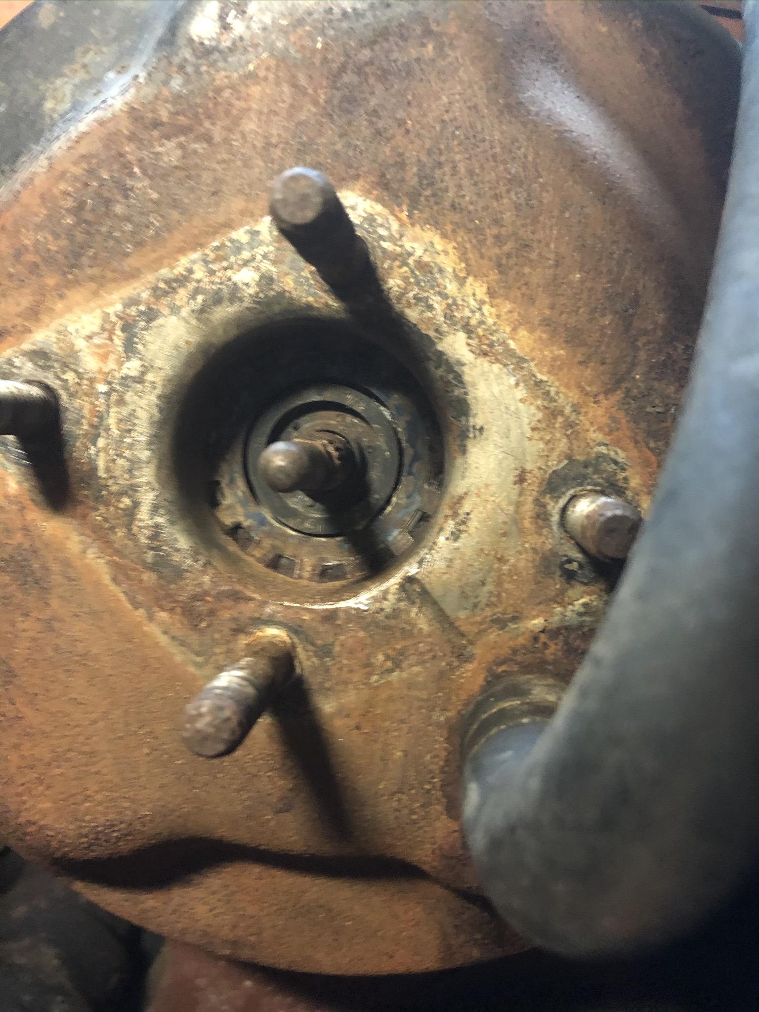

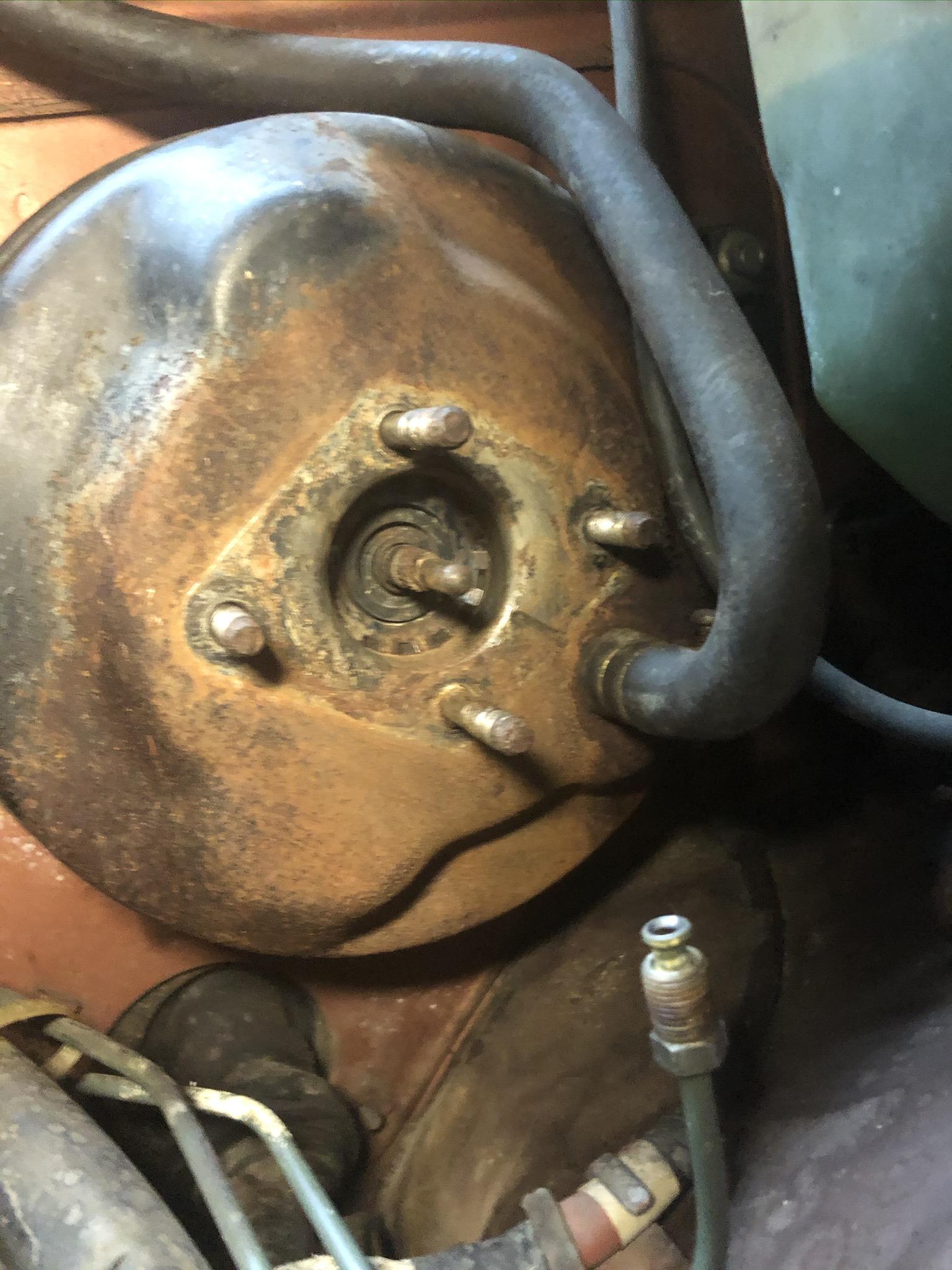

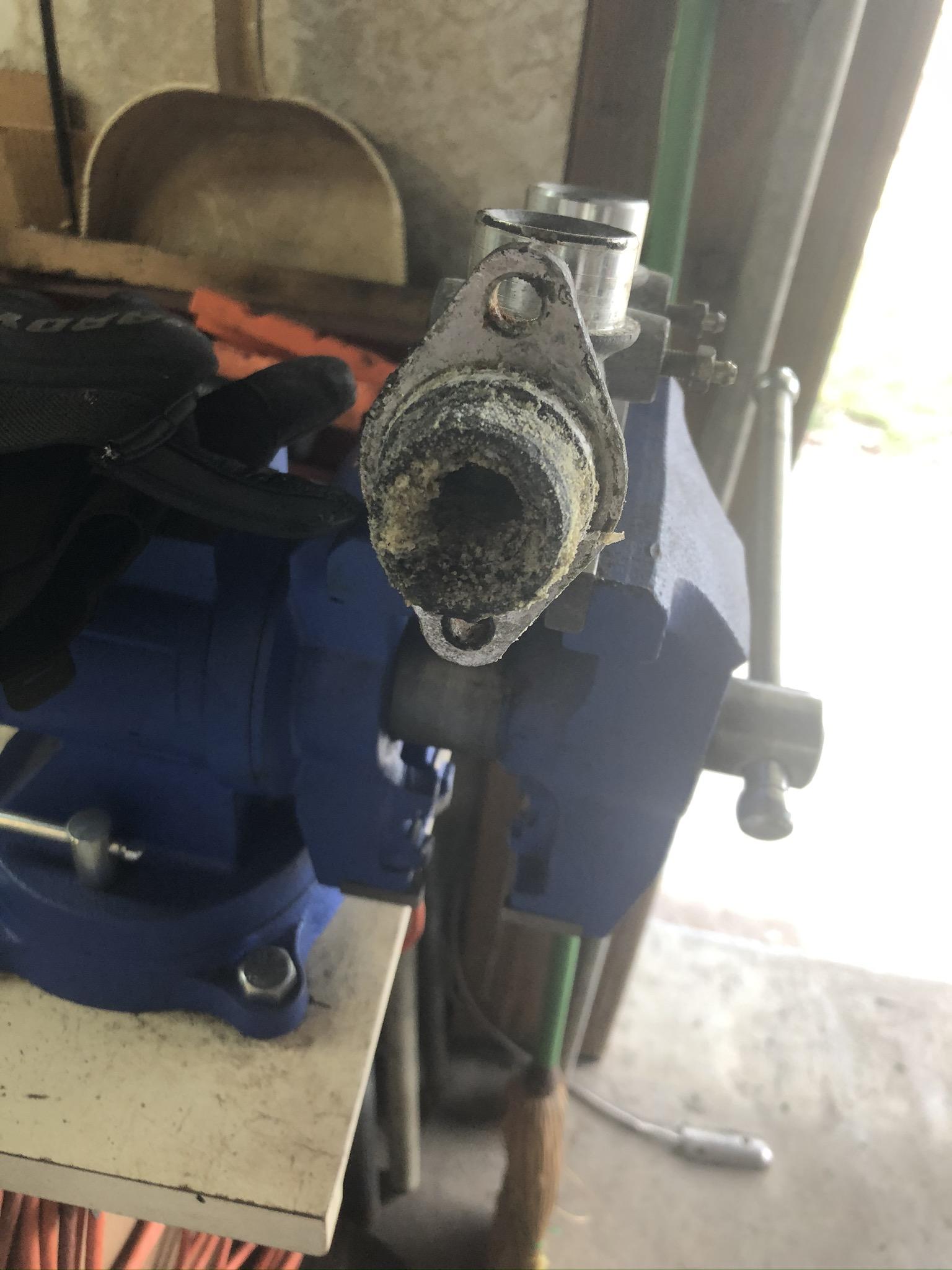

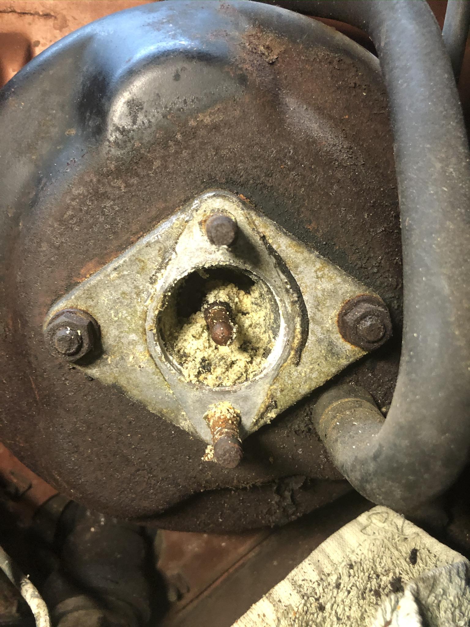

Went to replace the master cylinder this afternoon. Car has not been driven for 12 years or so. The master cylinder  was frozen. There are signs of fluid leaking on the front of the booster over time. Here are some pics of what I found after removing the master cylinder. The booster makes a light swooshing sound when the pedal is pressed up and down. I would assume the booster is shot. Any advice much appreciated. Thanks

Here's a common problem with that whooshing sound your hearing.

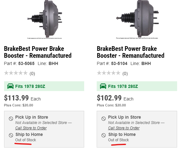

Check your local auto parts stores first.  You never what old dusty parts they have that have been waiting just for you.  Wasn't that long ago that you could get a reman booster at OReilly Auto.
People have reported problems with quality but might be worth a look.
OReilly's not looking good though...
