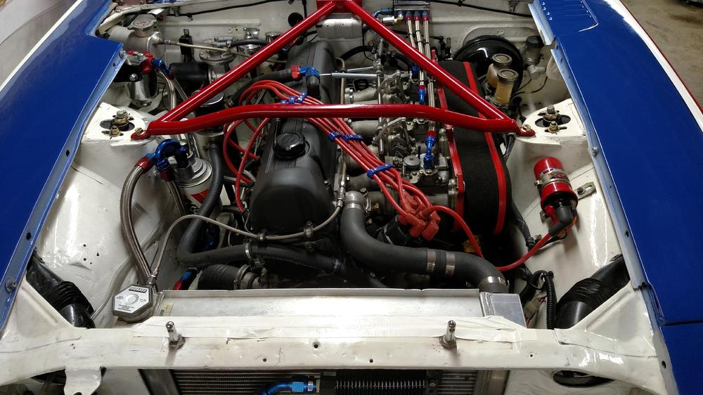

For the 280zx drivers..  i had a 280zx 2+2 and they break a lot of windscreens.. due to flex.. (especially the T-bar chassis ones)  and i made a triangular one in the front that also meets the firewall (near the lock) and it helps a lot!

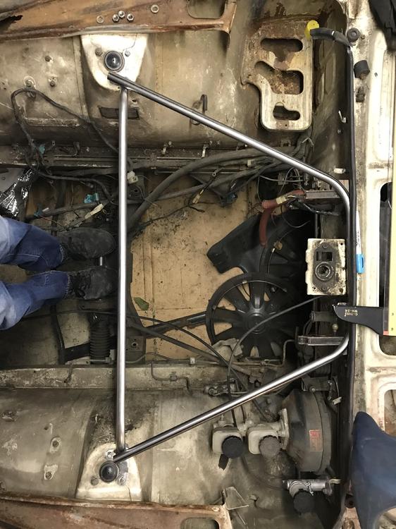

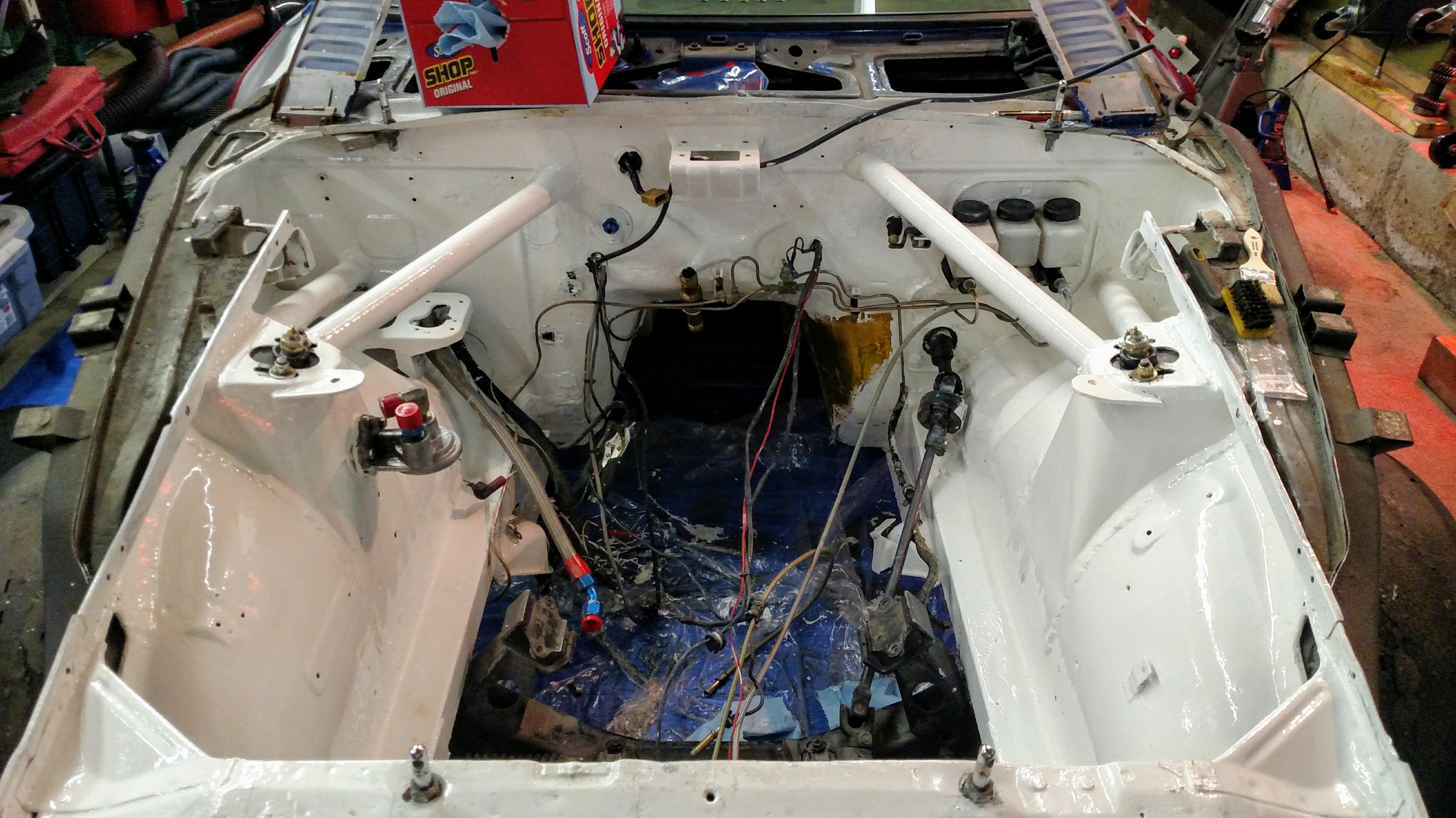

I put in triangulated braces front and back and they do make a noticeable difference when pushing the car and the rear helps a bit for squeaks but what eliminated the squeaks for good was stitch welding all the seams in the car. That noise drove me crazy too, I didn't stitch weld the seams for that reason but it was a pleasant surprise when the car was all put back together.

Not to thread hijack, but @grannyknot do you have pictures of your setup? I was working on it last night, I just wanted to see how the bars form around the strut brace. What’s the diameter of the tube used?
I think I made the brace a bit wide at the firewall compared to the TEP mount.

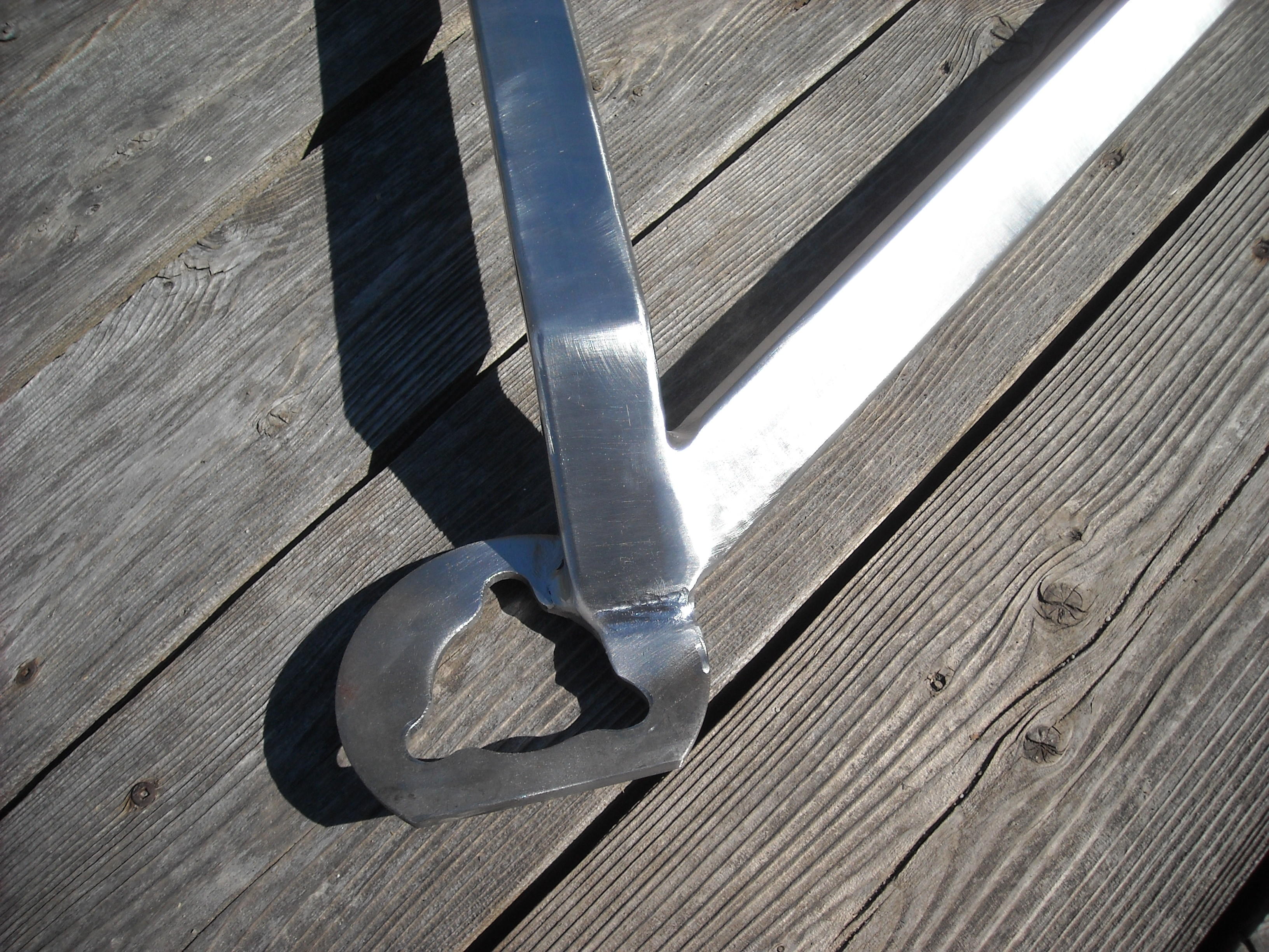

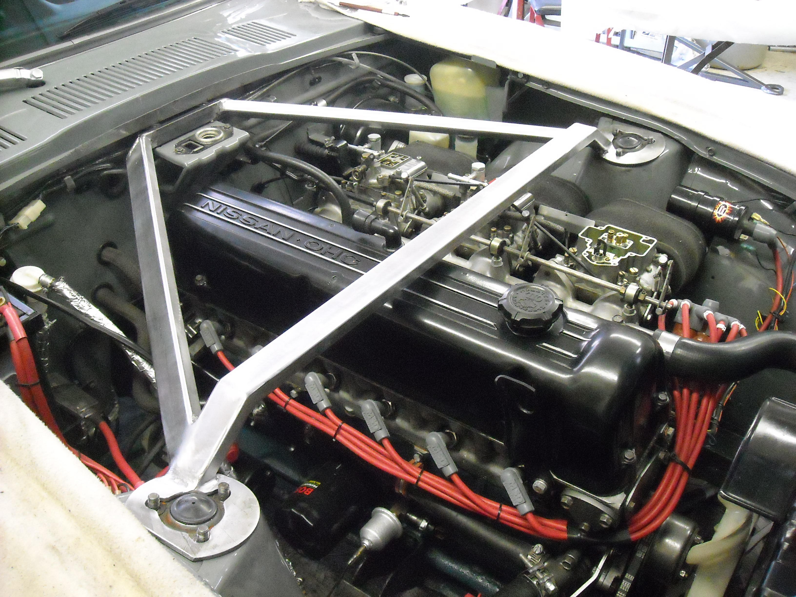

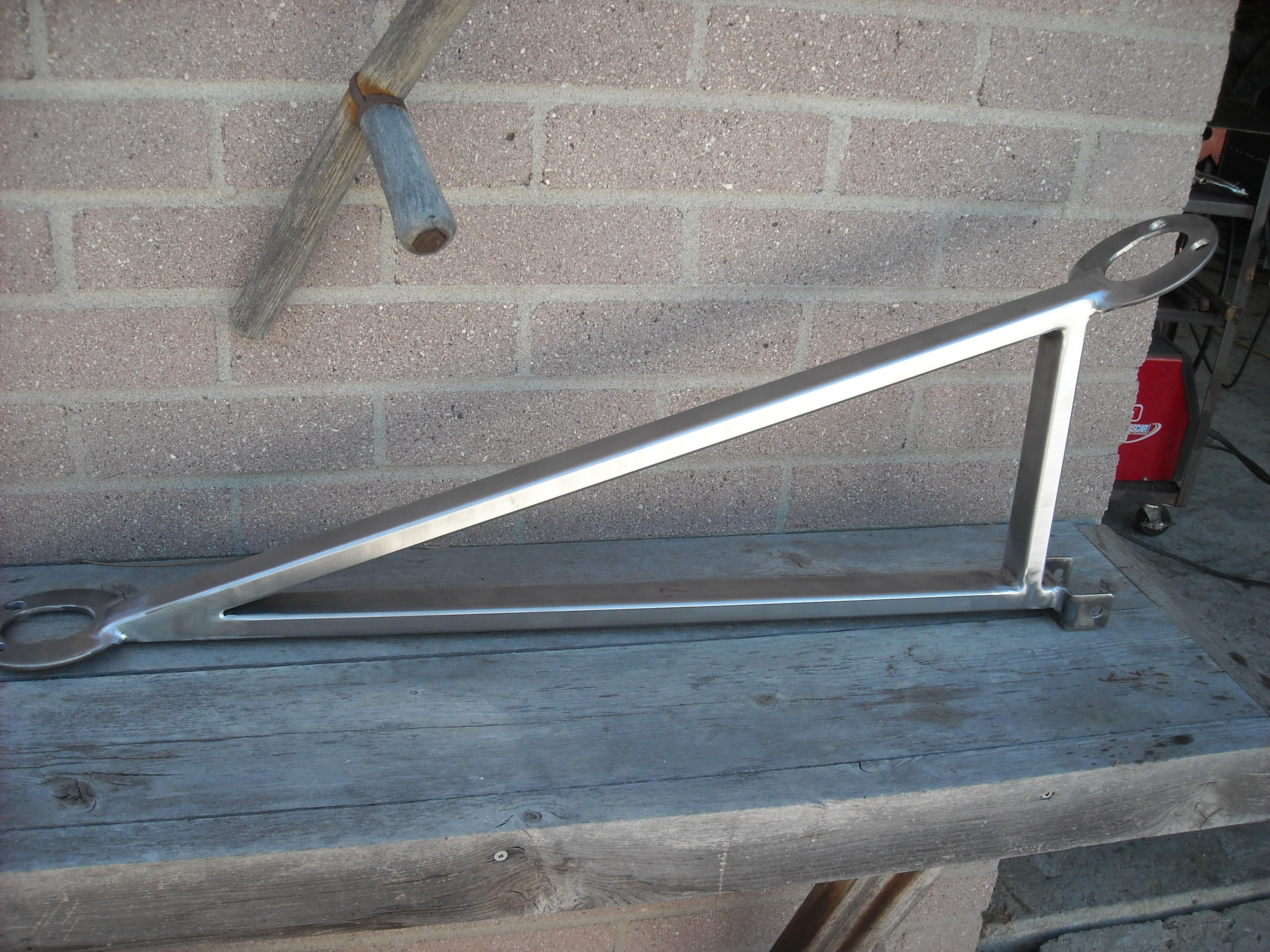

Here you go,  I don't care for round tube so much so this rectangle tube worked for me.

Nice looking parts.  How did you tie the front brace into the cowl?
