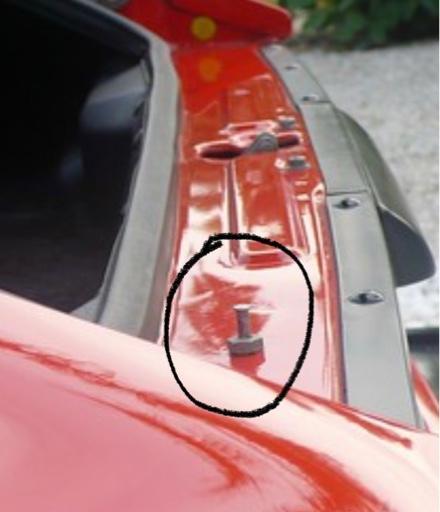

Posted April 19, 20204 yr comment_597483 I have only ever seen it in pictures of super low mileage 280z. I have not seen one in person so not sure what it does I don’t think it’s electrical Sent from my iPhone using Tapatalk Link to comment https://www.classiczcars.com/forums/topic/63867-what-is-this-part/ Share on other sites More sharing options...
April 19, 20204 yr comment_597485 interior light switch? Link to comment https://www.classiczcars.com/forums/topic/63867-what-is-this-part/#findComment-597485 Share on other sites More sharing options...

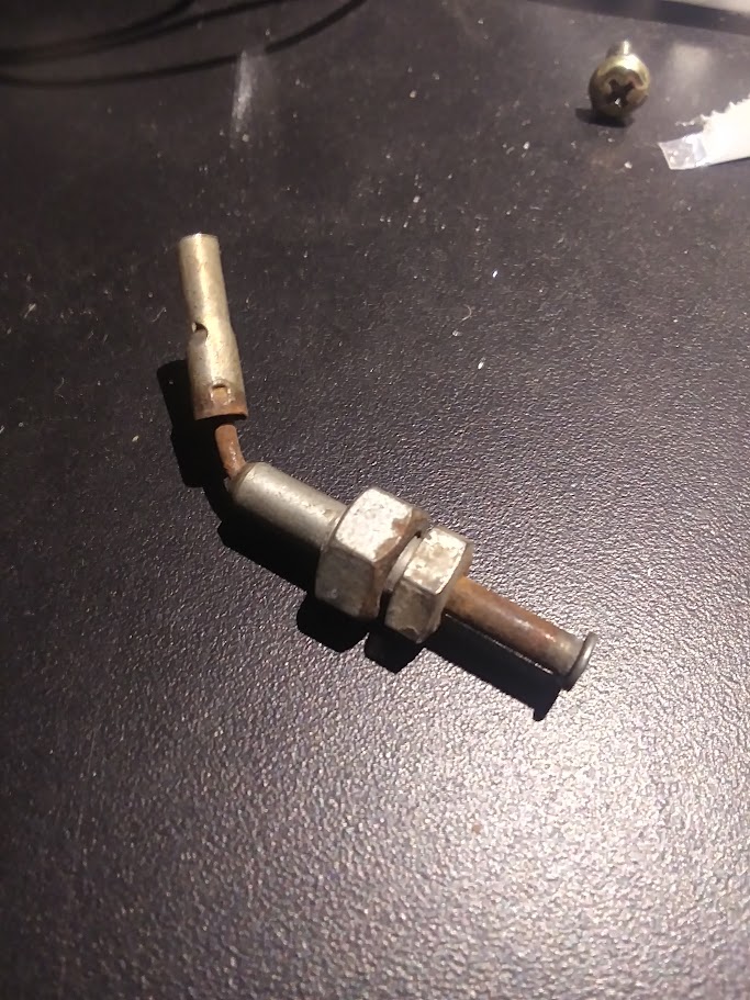

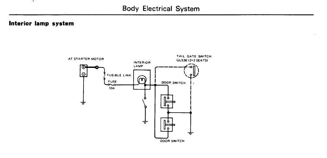

April 19, 20204 yr Author comment_597487 Your right I just found that in the electrical diagram... now does anyone sell this part?Sent from my iPhone using Tapatalk Link to comment https://www.classiczcars.com/forums/topic/63867-what-is-this-part/#findComment-597487 Share on other sites More sharing options...
April 19, 20204 yr comment_597490 According to the diagrams, that switch was used on the 2+2s. Present in 76, but not in 74. Don't know about 75. Link to comment https://www.classiczcars.com/forums/topic/63867-what-is-this-part/#findComment-597490 Share on other sites More sharing options...

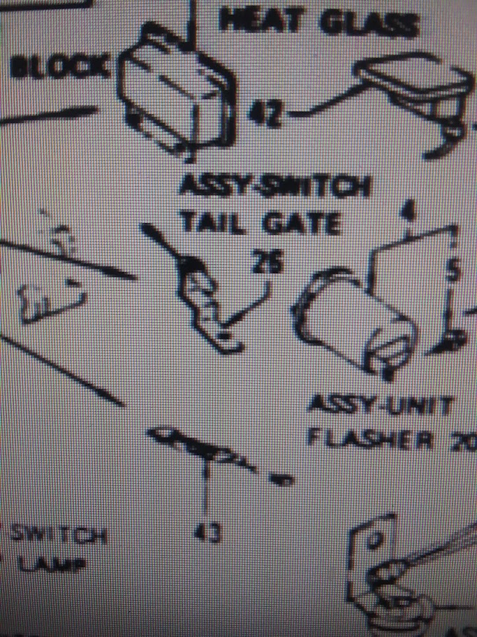

April 19, 20204 yr comment_597496 Cool. My pic is from the 78 FSM: Link to comment https://www.classiczcars.com/forums/topic/63867-what-is-this-part/#findComment-597496 Share on other sites More sharing options...
April 19, 20204 yr comment_597497 I'm thinking that either someone added that to a car that didn't leave the factory with one, or the documentation is wrong and they put those on all the 78 cars regardless if they were 2+2 or coupe. Maybe they were offering that as an option in 78? Dealer installed? Link to comment https://www.classiczcars.com/forums/topic/63867-what-is-this-part/#findComment-597497 Share on other sites More sharing options...

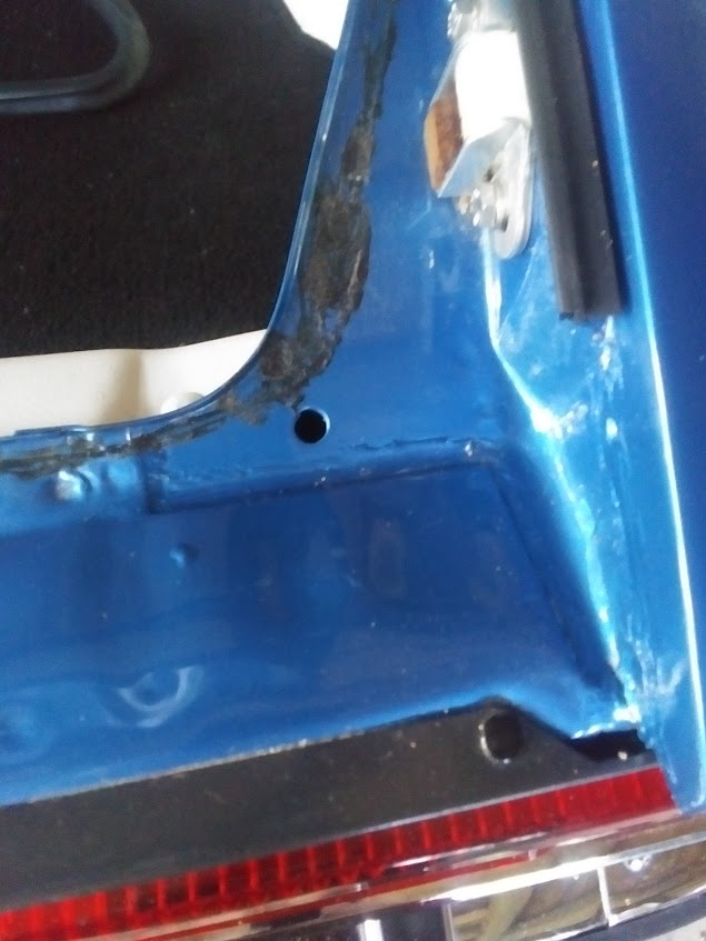

May 19, 20231 yr comment_653742 I have one of those switches on the hatch jamb of my 73. The hole is in the lower right corner. I find a part number of 36011-89901 for a "Tail Gate Switch" in CarPartsManual.com..but I don't believe it to be the same. I can confirm that my car DID have an alarm system installed by Chapman Alarms, as the original owner (a friend of mine's wife) worked for them and they installed the system for half-price. Seems like it would have been a nice feature to have the dome light come on when the hatch was opened if it were an original switch for that purpose. As the parts diagram shows a switch for the "tail gate", I am going to check the wiring harness to see if provisions were made for such an animal (wiring was provided for an electric fuel pump, so it is possible) and what it would take to reinstall the switch I have. I'm way late for this thread, but was curious about the switch I found in my box of tricks...Ryals Link to comment https://www.classiczcars.com/forums/topic/63867-what-is-this-part/#findComment-653742 Share on other sites More sharing options...
