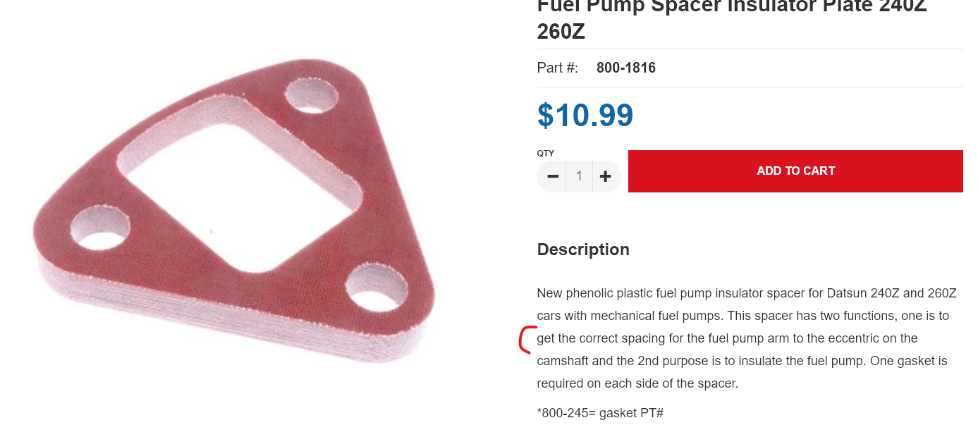

April 24, 20205 yr comment_597926 The videos work fine on my Windows 10 machine. The second one shows the filter body filing with gasoline,with a clicking noise in the background. The first video shows the pump arm moving on the eccentric as somebody spins the engine. Can you connect the two videos with some words? Were you moving the pump arm by hand in the second video? And you didn't show the actually mounting of the pump. I know that there are typically phenolic spacers that sit under the pump. Maybe your pump is too far from the eccentric. That's my at-the-moment guess. The pump is sitting too far from the eccentric. Link to comment https://www.classiczcars.com/forums/topic/63901-delphi-mechanical-fuel-pump-stops-pumping-fuel/#findComment-597926 Share on other sites More sharing options...

April 24, 20205 yr comment_597928 There are only two videos, the first two you describe, then your voltmeter needle moving with your flashers after those. But I get it now.  Still, wondering about the mounting of the pump. https://zcardepot.com/products/fuel-pump-spacer-plate-240z-260z Link to comment https://www.classiczcars.com/forums/topic/63901-delphi-mechanical-fuel-pump-stops-pumping-fuel/#findComment-597928 Share on other sites More sharing options...

April 24, 20205 yr Author comment_597937 1 hour ago, motorman7 said: The one video looks like the pump is working well. Typically, I will disconnect one of the hoses going to the carb float bowls to see if fuel is pumping out. That will tell you if the pump is working. Put a rag or cup under hose to catch the fuel. The pump spacer you posted is the exact one I purchased. I went back to the garage and manually pumped fuel through the entire system. I confirmed that fuel is pumping to the float bowls. Once I pumped fuel through the system I let it sit for a few minutes to see if the fuel would drain back toward the tank. This time the fuel remained in the engine bay fuel filter. So, I cranked the engine and she fired up. Now I'm even more puzzled because this is likely an intermittent problem. My next thing is to drop the tank and make sure I'm not picking up debris at the end of the pick up tube. Link to comment https://www.classiczcars.com/forums/topic/63901-delphi-mechanical-fuel-pump-stops-pumping-fuel/#findComment-597937 Share on other sites More sharing options...
