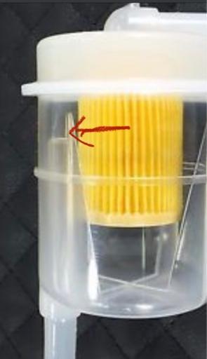

If you use the original style filters, they have a simple and effective non-return built in, by having the vertical inlet pipe inside the filter housing higher than the normal height of the fuel in the filter. So it “shouldn’t” be drying out unless you live somewhere mega hot and / or have an air leak somewhere.
8e5a1fe325f5fe913a6902941e74959b.jpg&key=17019723b315874a5c61192eeedfea209dad26fa1f93effc1b3d7d20697f2467
Despite the fact that the float bowls and fuel lines have fuel in them, if there is air in the pipe work, the pumping action is just compressing the air and you’re not building sufficient fuel pressure as a result; until it’s blown out of the return line’s restrictive orifice on the fuel rail and the float bowls (depending on where the air is). I would imagine that when standing, the floats in the bowls aren’t fully closed and over time, air is very slowly sucked through them back into the fuel rails.
After stopping the car, heat soak will warm up the float bowls and the pressure from the fuel vapours will blow some fuel out of the bowls through the jets, or indeed evaporate through the jets, thus marginally reducing the volume of fuel and the floats dropping. Remember, when the engine is off, the jets are still somewhat open. The fuel then cools, the floats drop further and hey presto, you have a way for air to enter the feed lines. Notwithstanding of course that the fuel in the rails also heats, pushes through the return line, then cools and sucks air from anywhere it can.
So in short, even with a return valve you’re not totally going to fix this issue and frankly, it’s a benefit in getting the oil going after a long period of standing; replacing what gravity and heat soak took off the areas it needs to be, before the straight 6 warbles into life!
