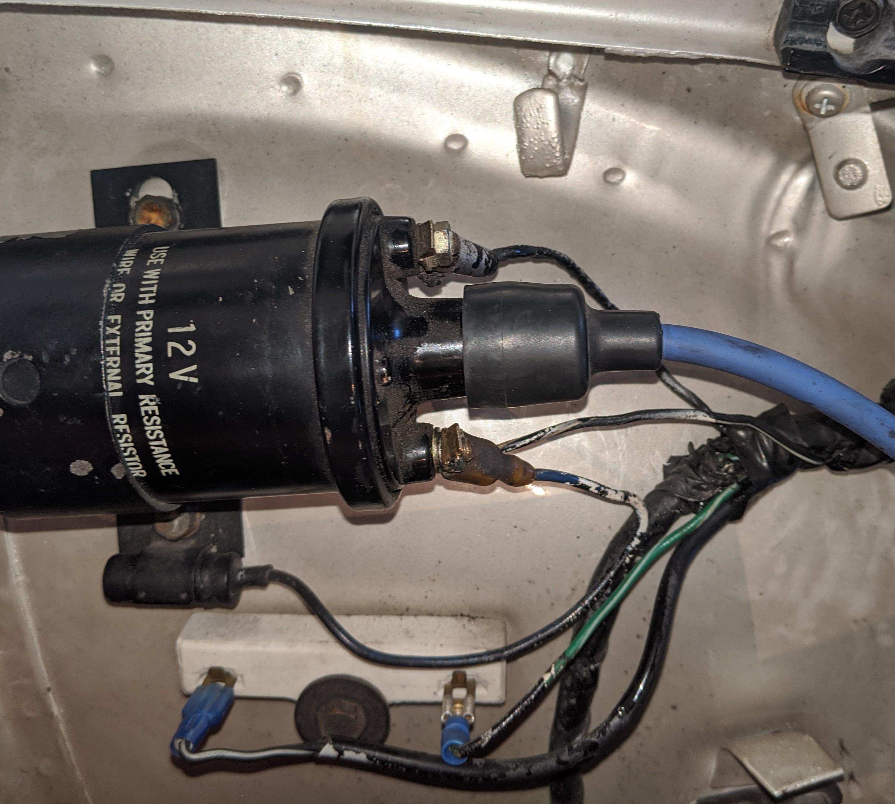

With 7tooZ's help I corrected some wiring at the ignition coil and resistor, and now the tach works! Much appreciated! Even my spare tach works.
I did notice when the car was running and I swapped one tach for the other that the car died as soon as I unplugged the tach's wiring harness. Is that to be expected?
Here is a pic of the current wiring under the hood that got it working.

Because on the early years they run the primary side of the ignition coil signal through the tach to provide pulses. That's the looped wire on the back of the "current sensing" tach.
Now, it would be easy to bypass that and get the ignition to work without the tach, but if everything is wired according to stock, it shouldn't run without a tach installed:
