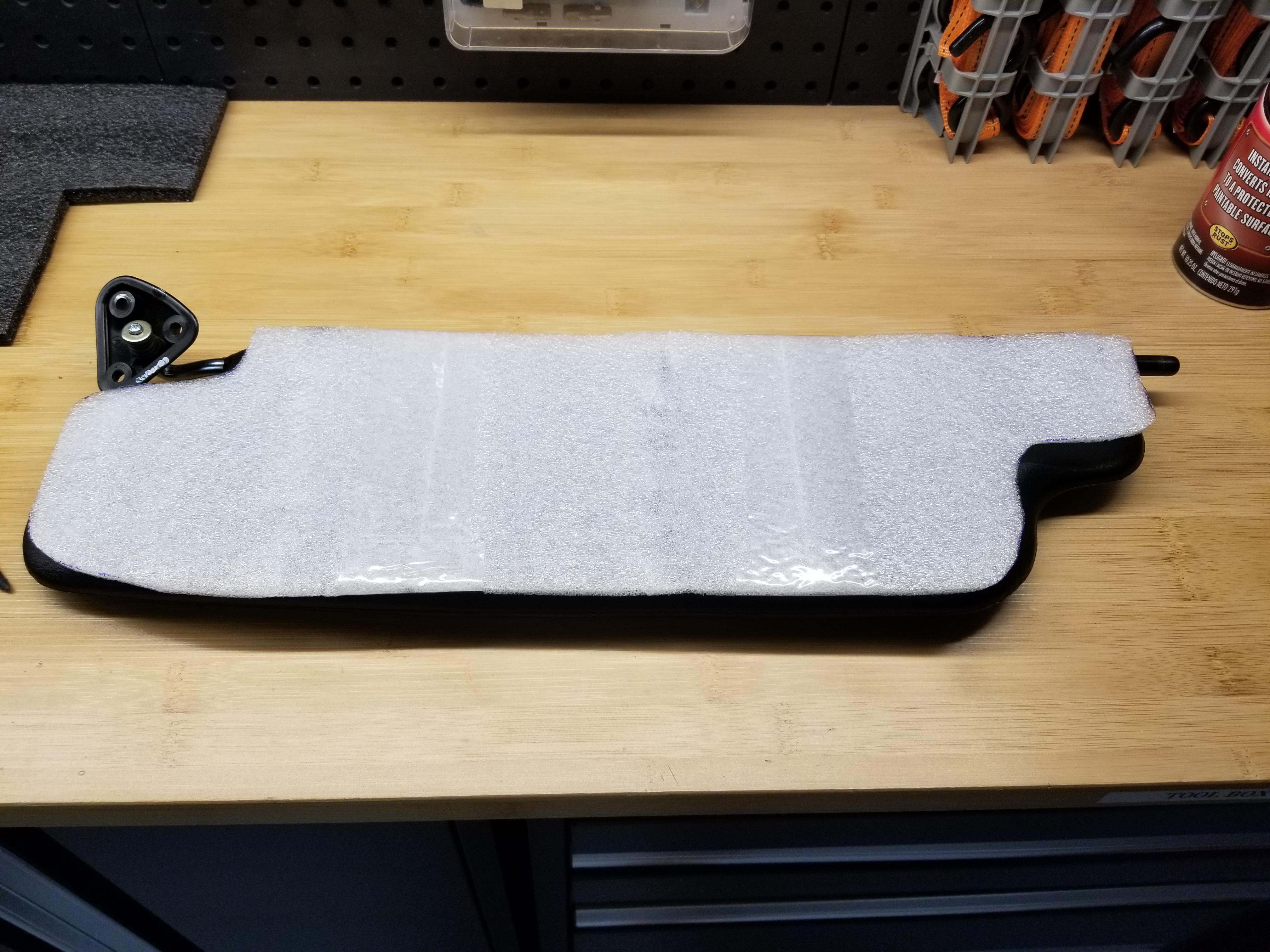

After looking at my original "saggy" sunvisors for a few years (and with lots of "sheltering at home" time) I decided to try a "fix". The vynil skins themselves are in great shape but it seemed as if the internal stuffing had deteriorated over 40 odd years and there were wrinkles here and there on the visors. I didn't want to change the original vynil for leather (visor repair kits on the market) so I decided to cut them open along the forwardmost seam with a fine scalpel blade, staying on one s
