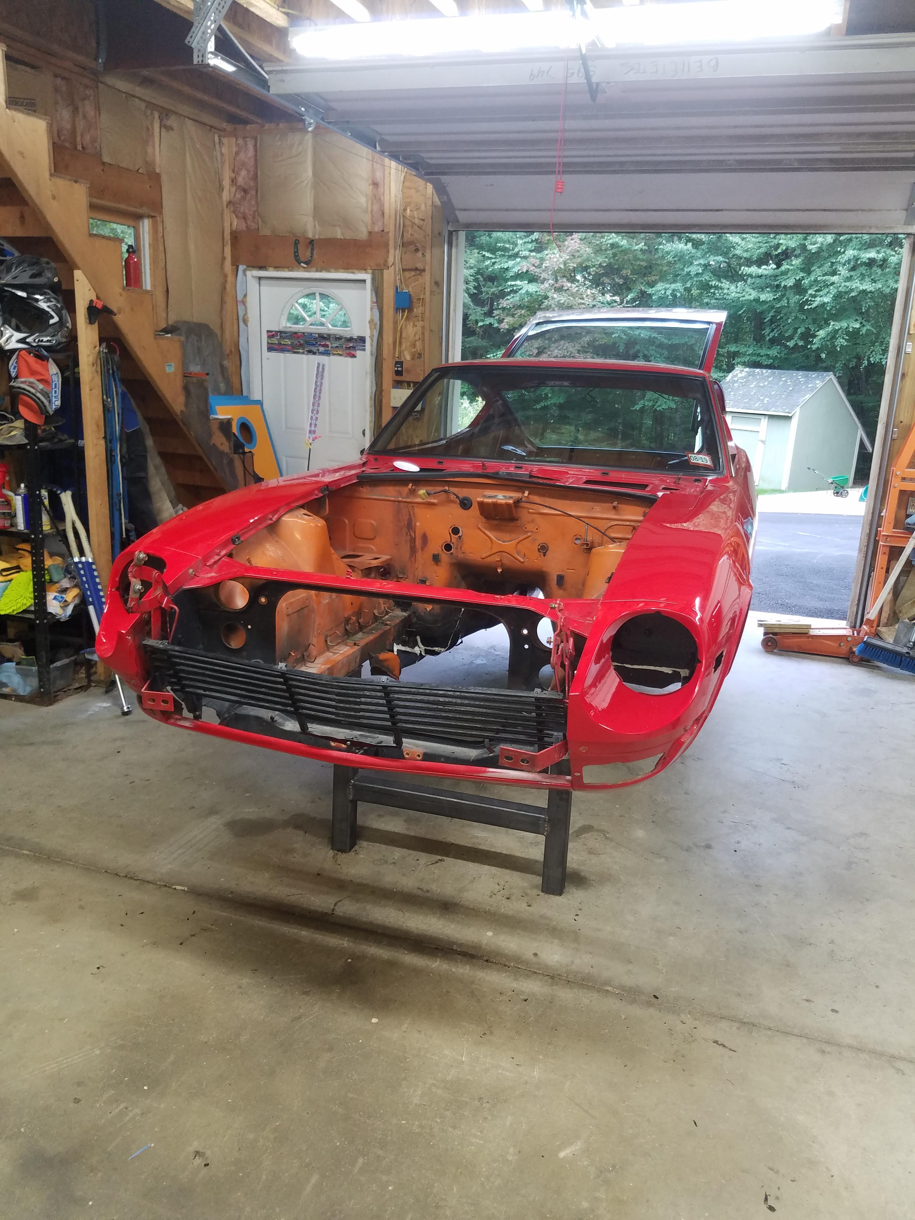

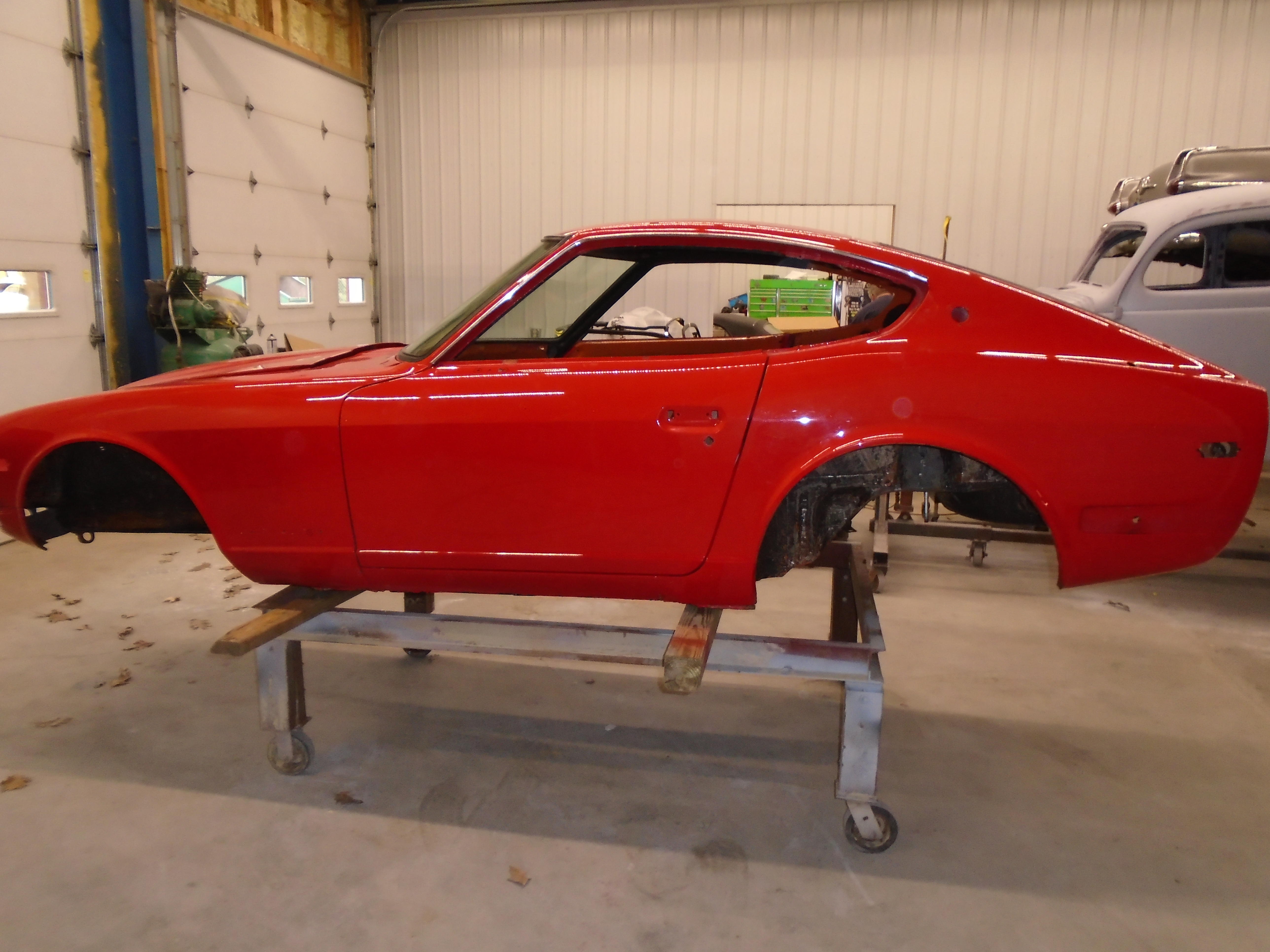

Car post tear down in September last year.  Had a decent Ferrari red paint job but rust was starting to show and I wanted to get it back to a pumpkin.

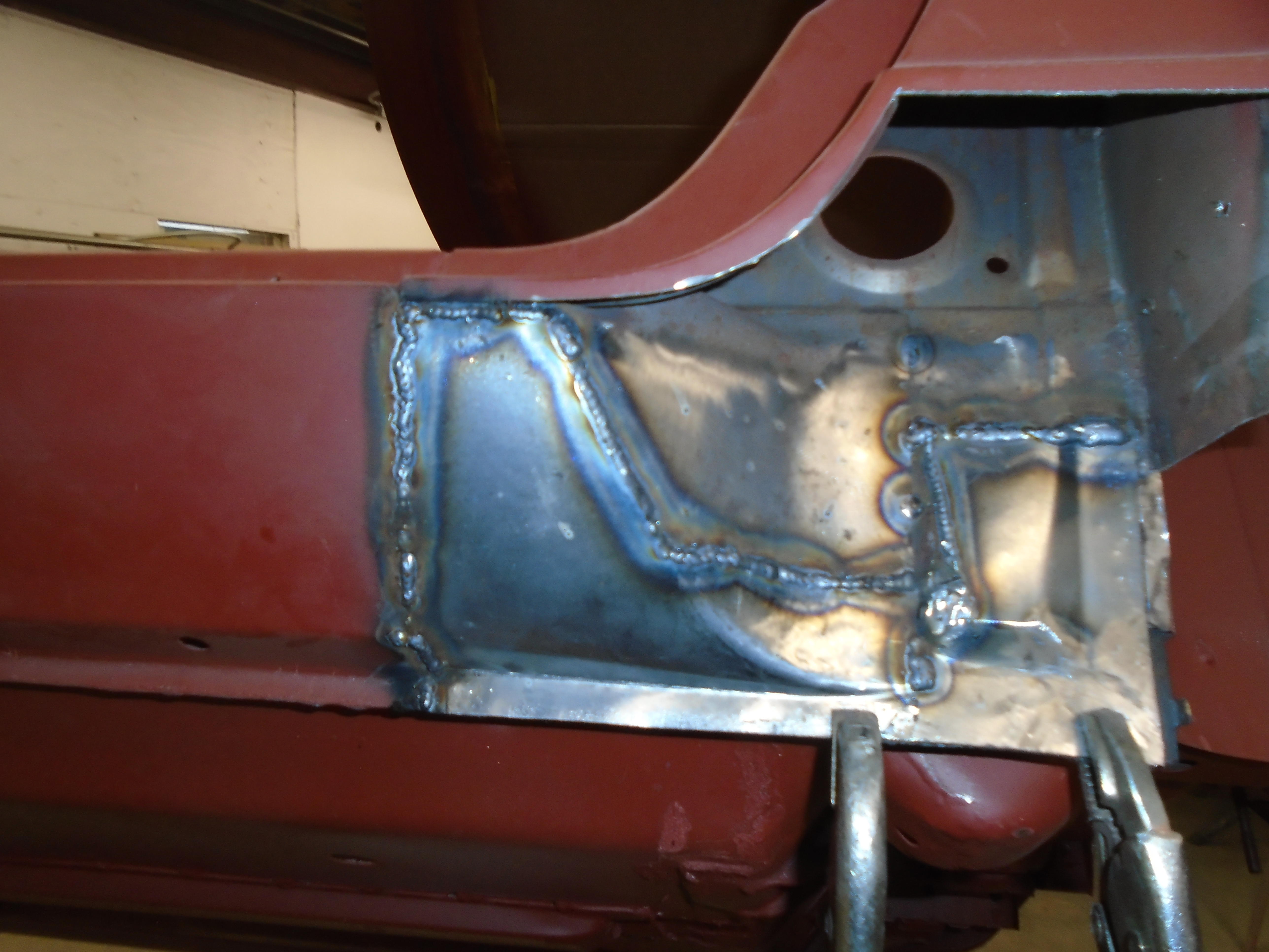

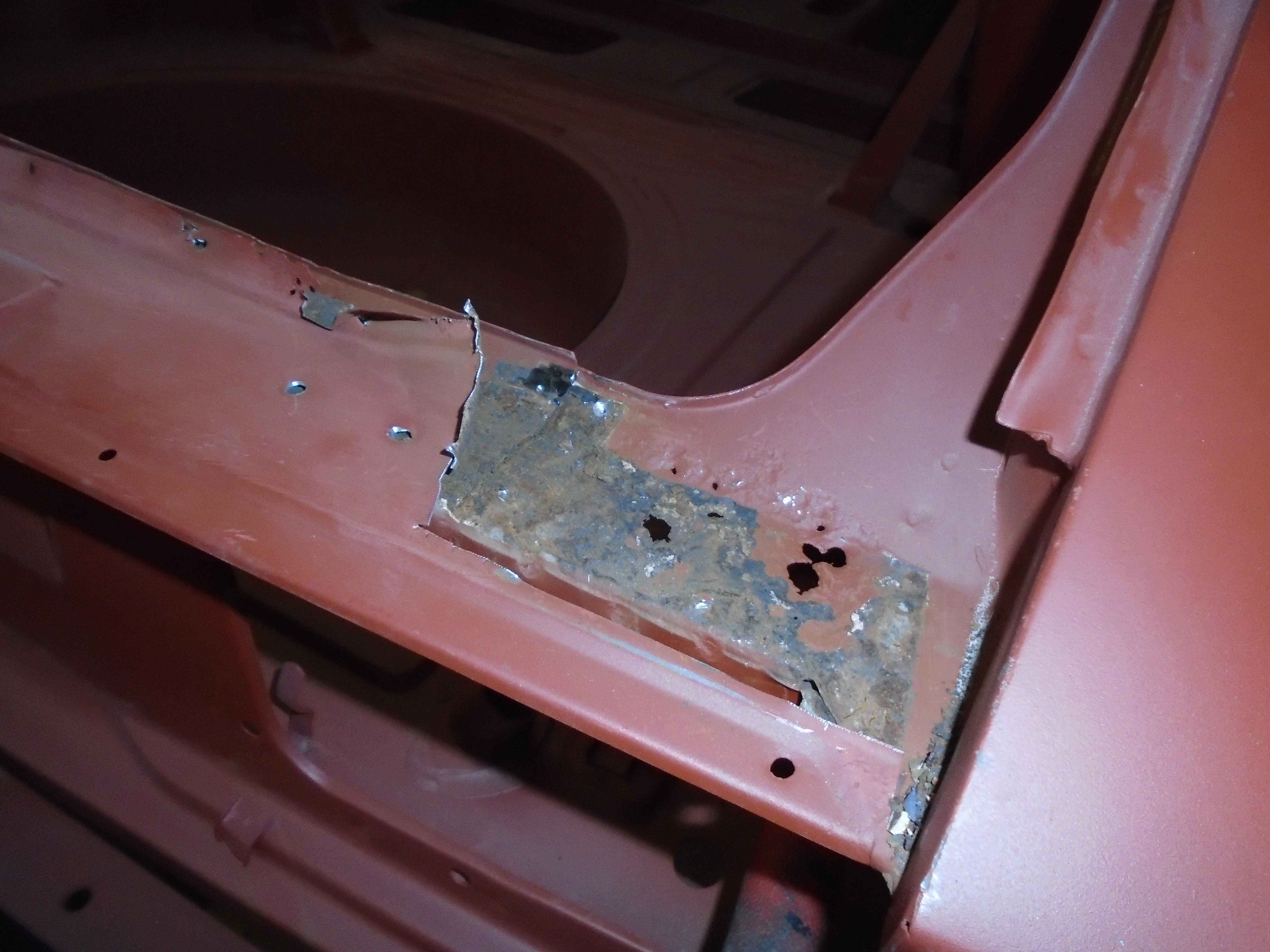

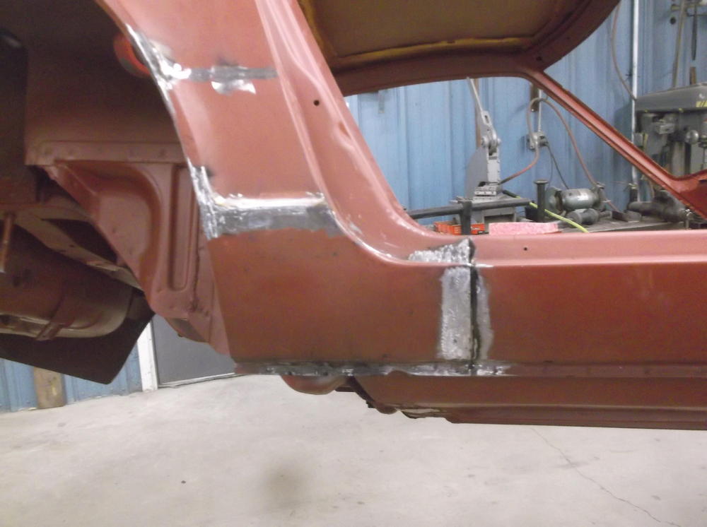

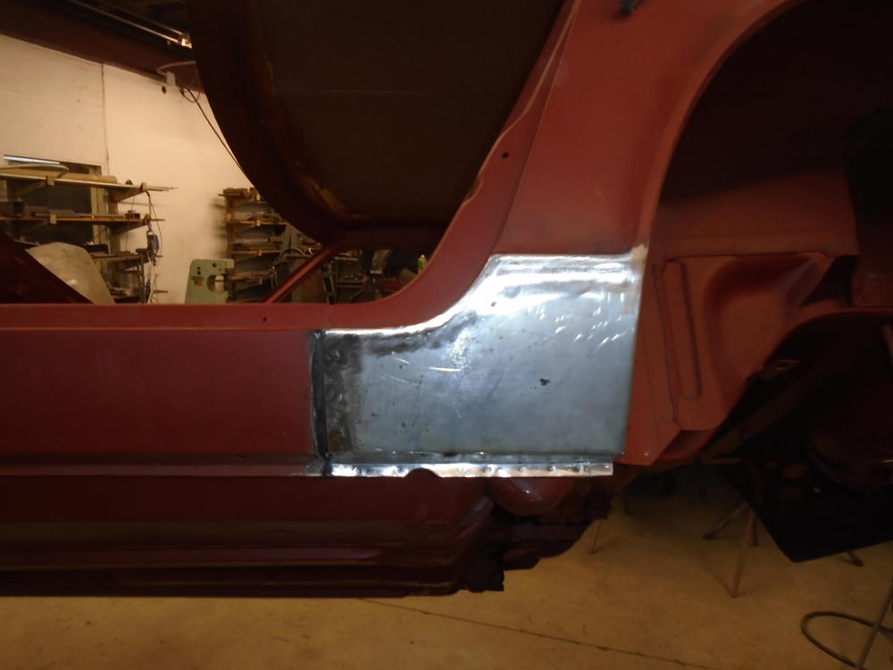

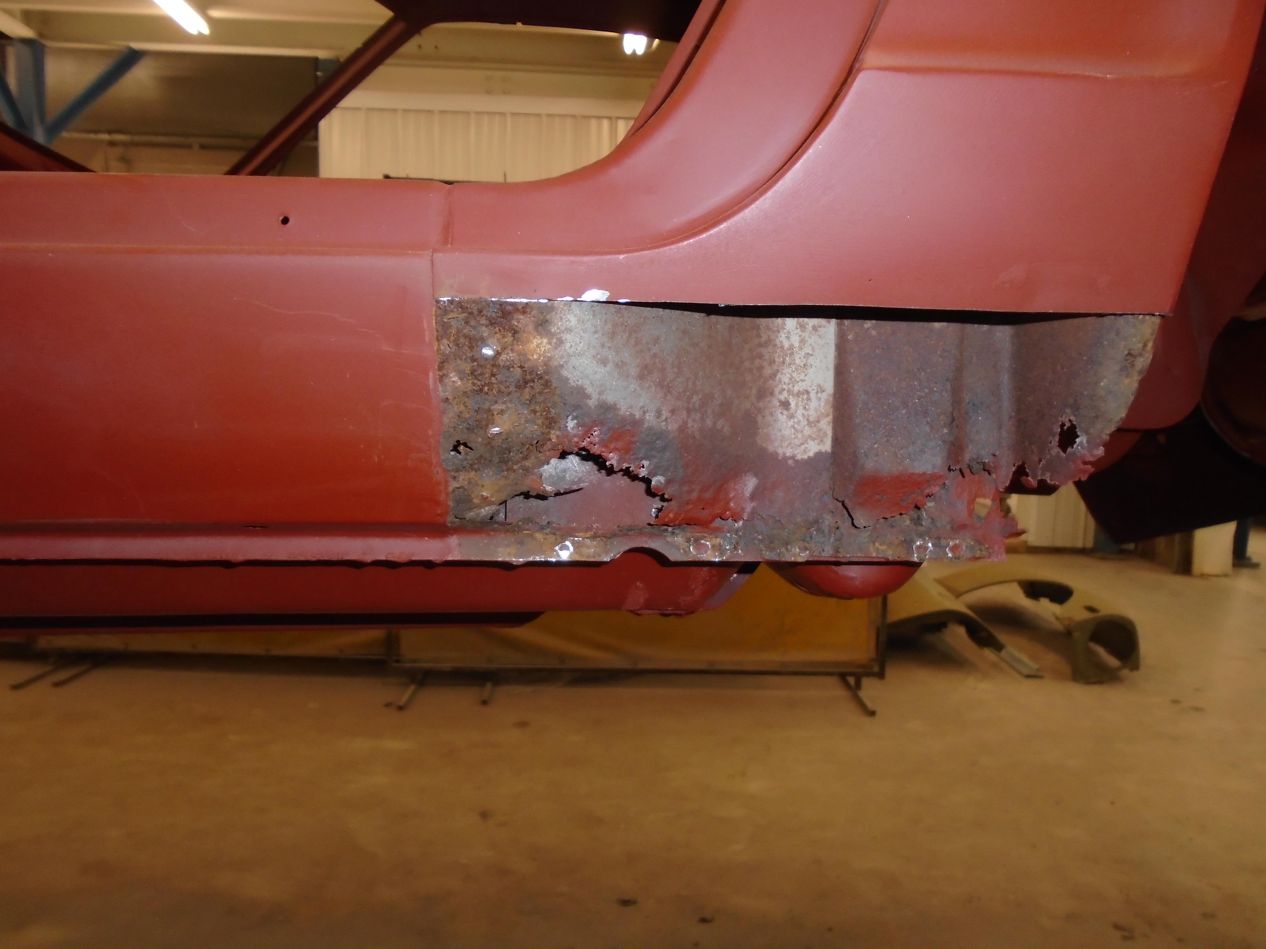

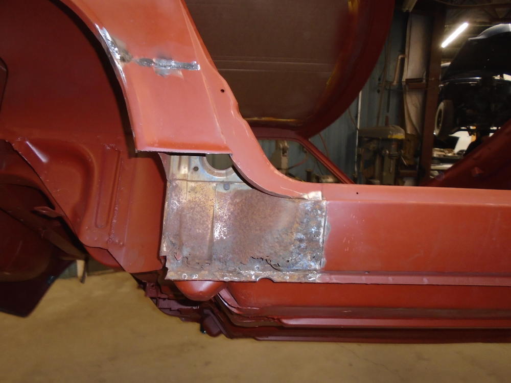

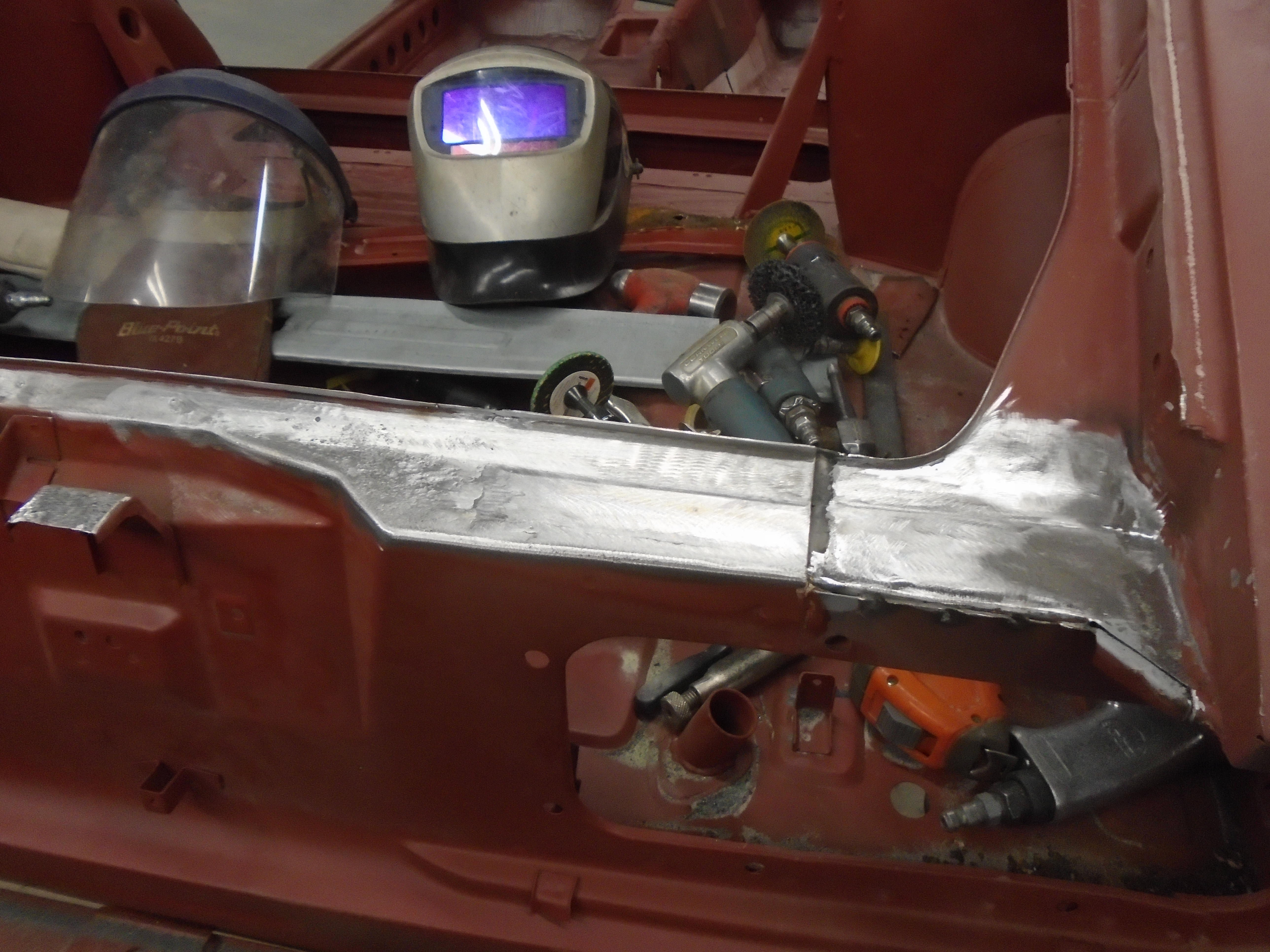

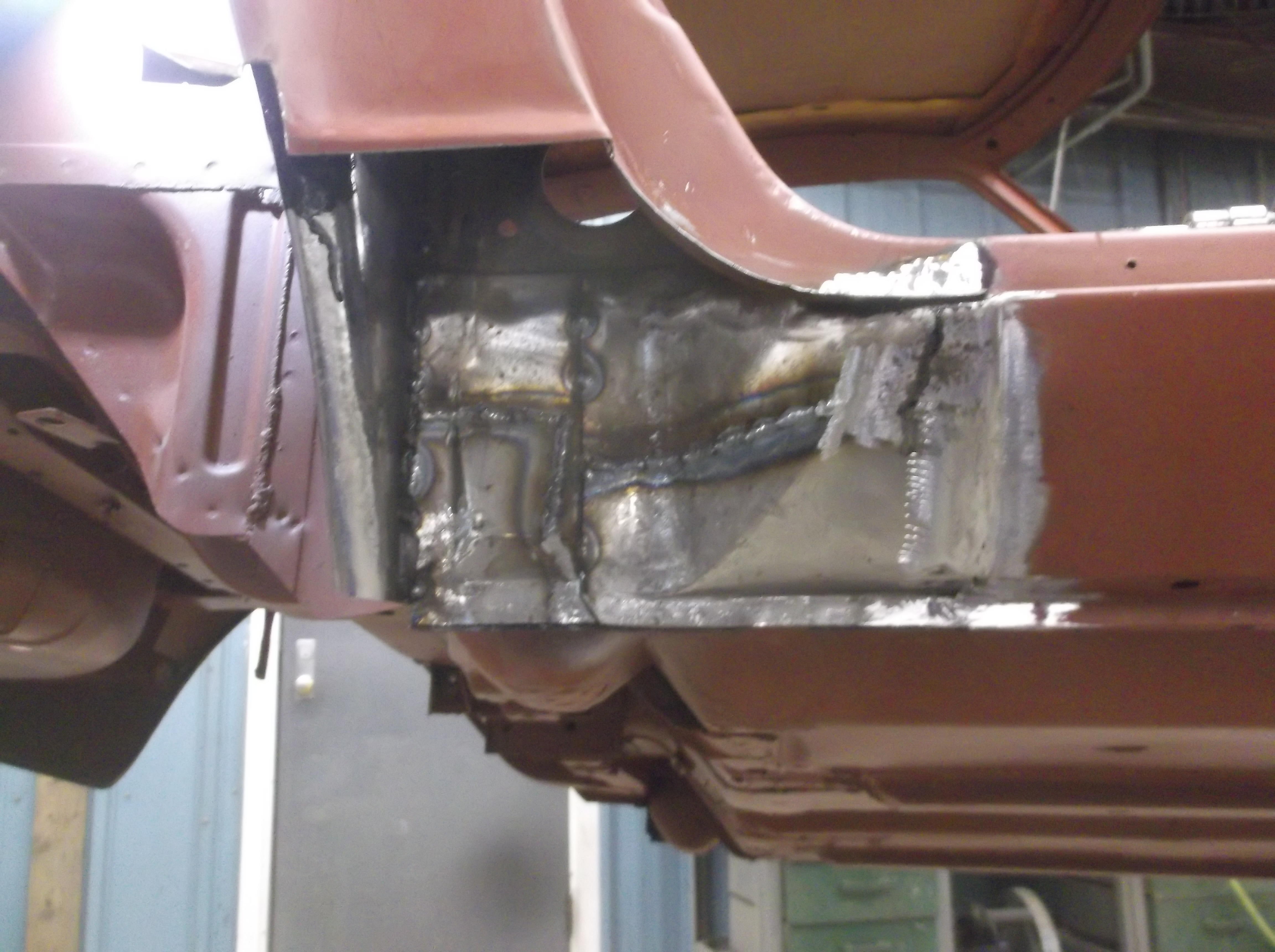

It had the usual rust.  I did the floors and frame rails myself last winter but I wasn't going to attempt any real bodywork!

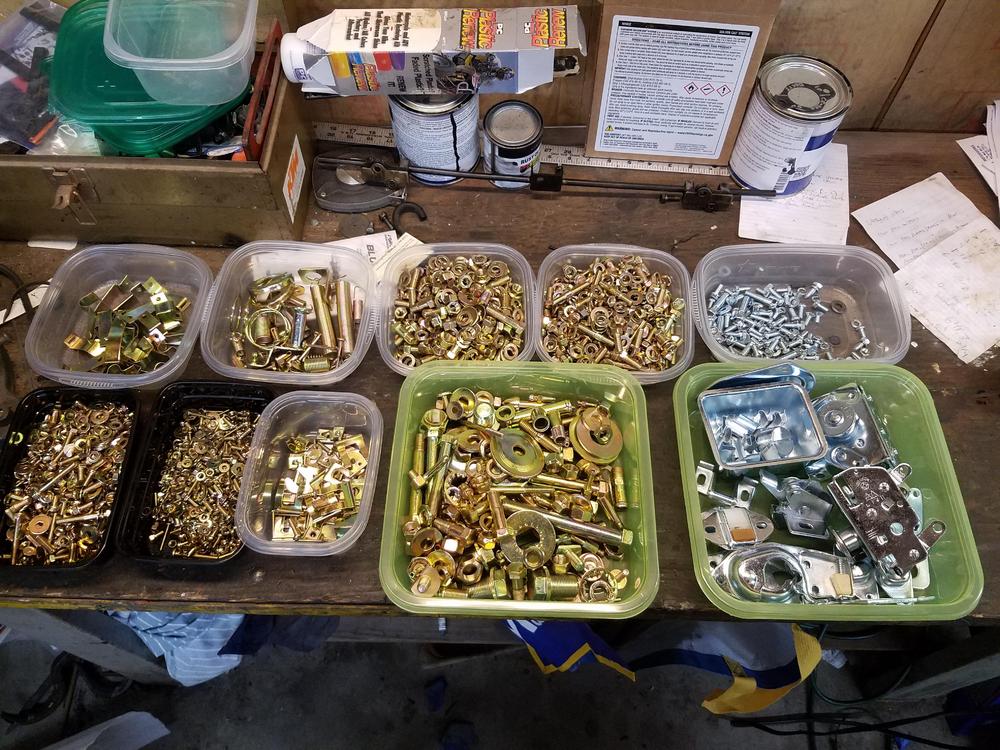

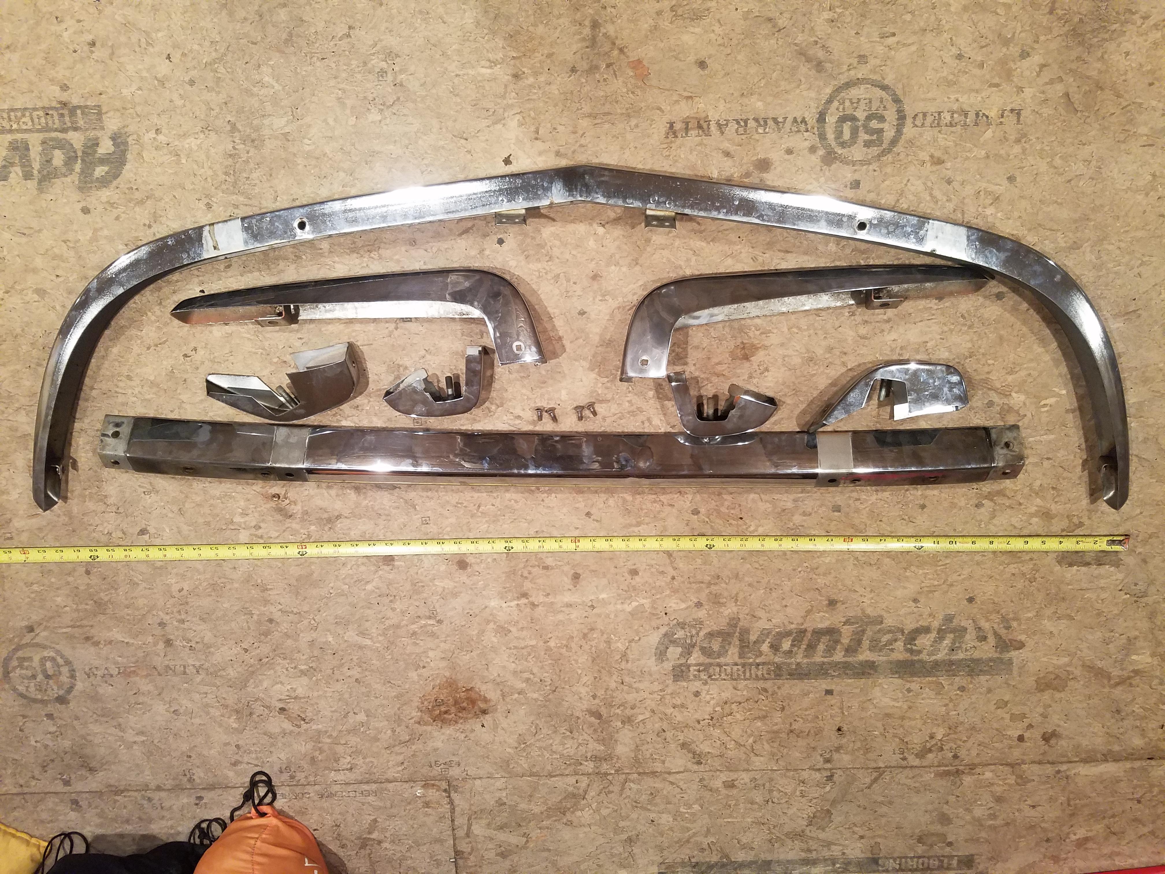

Thanks to @motorman7 for the zinc plating tips and the name of a great place to get it done in AZ.  Here's a lot of shiny hardware!

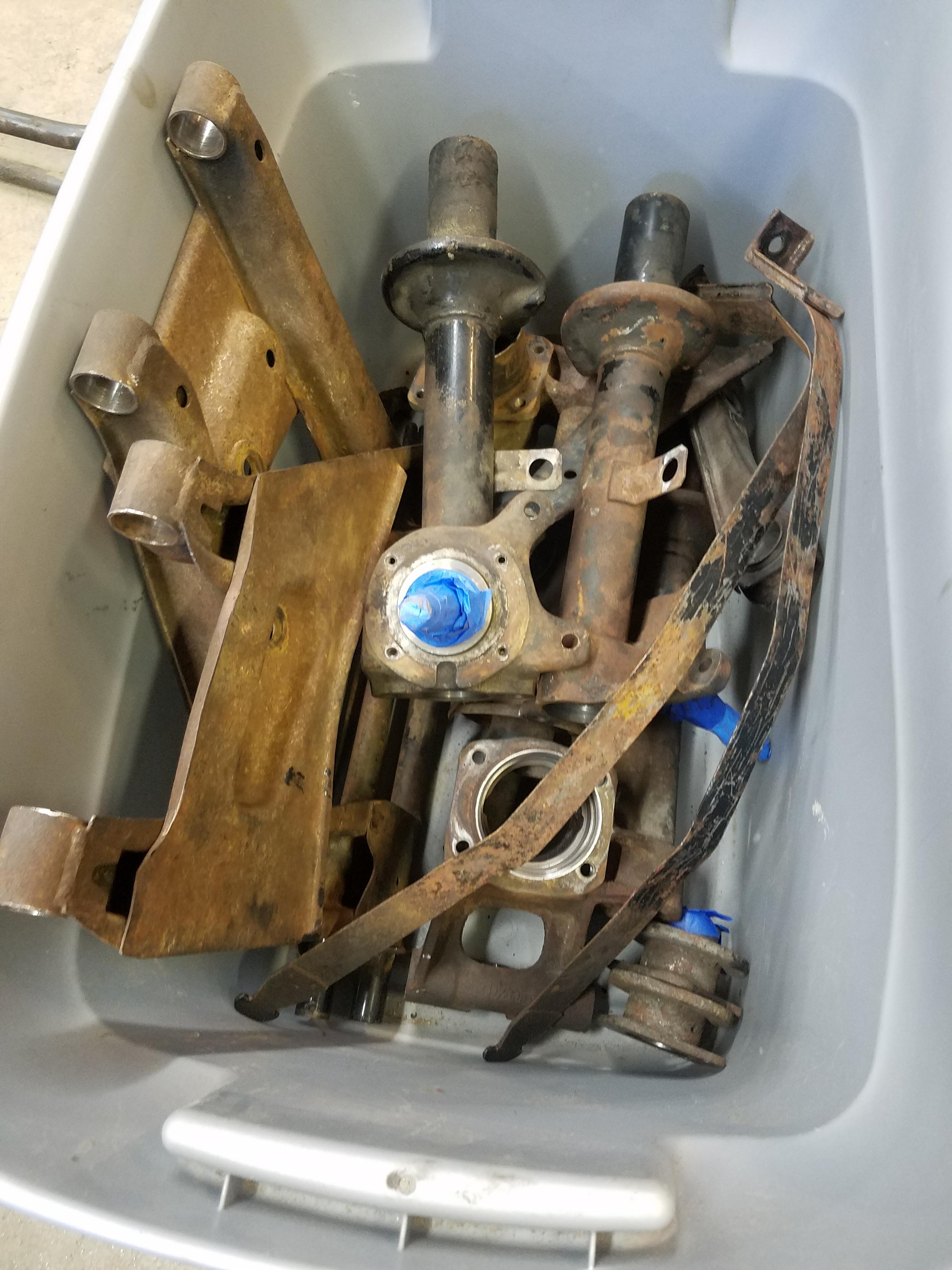

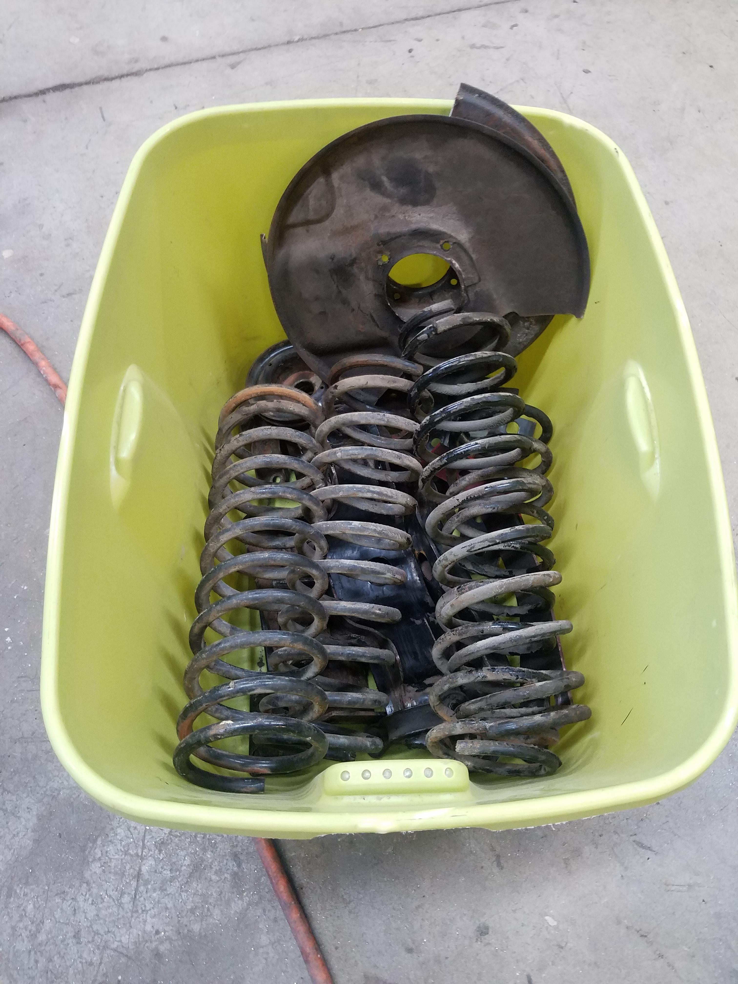

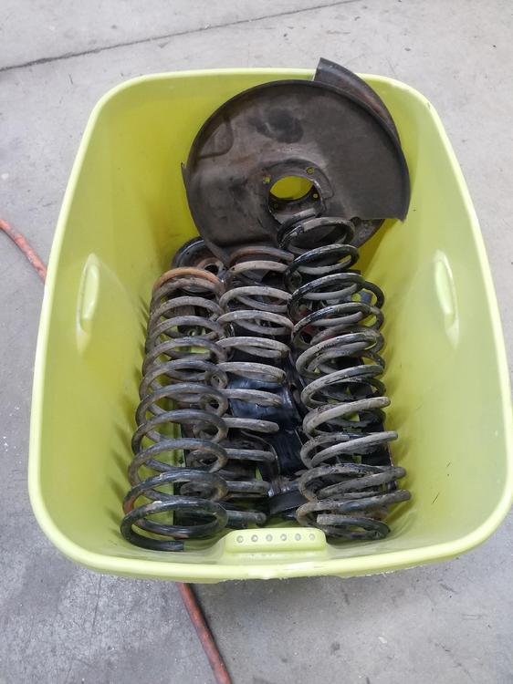

Bins of the rusted undercarriage parts headed for the powder coater.

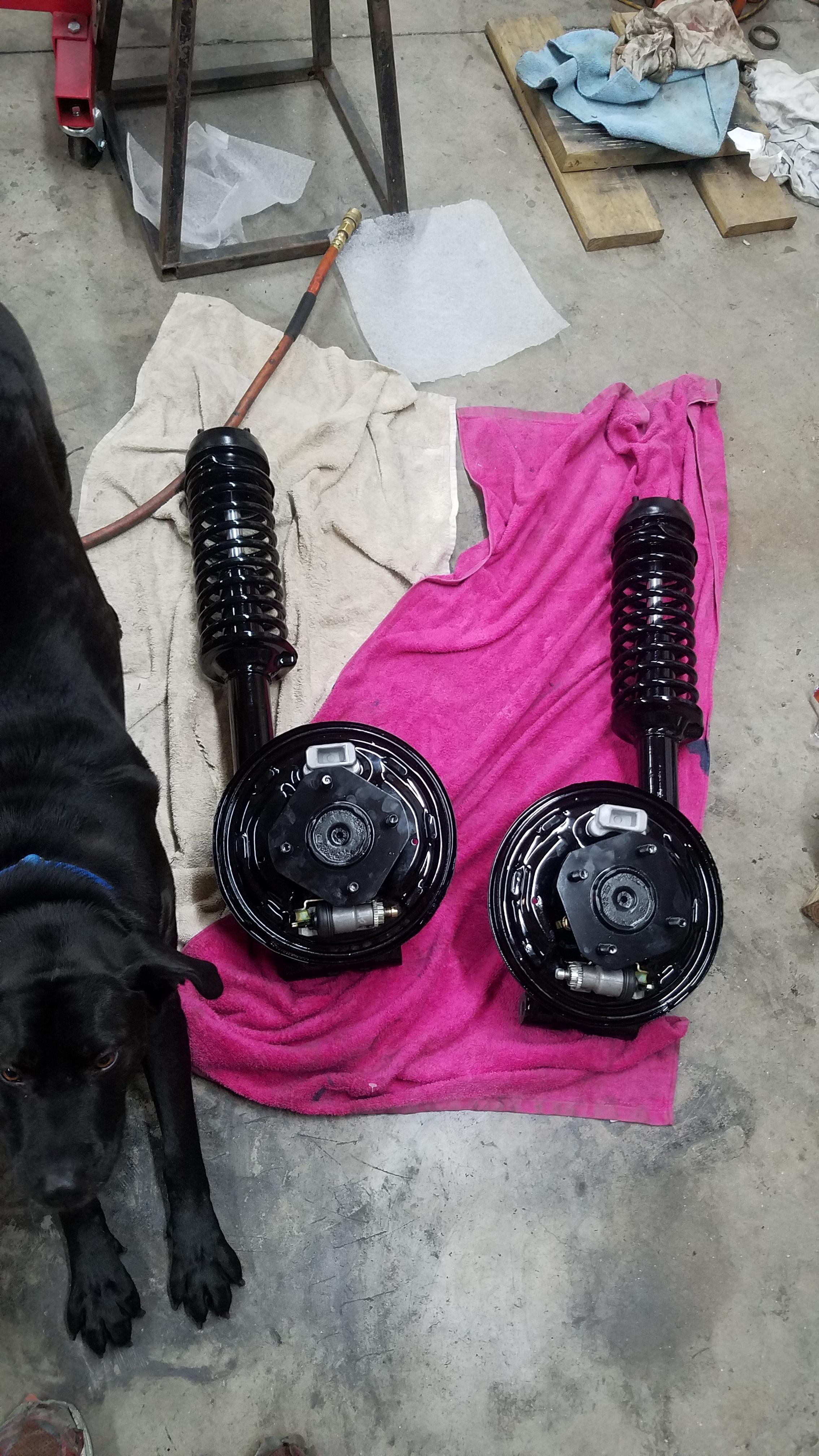

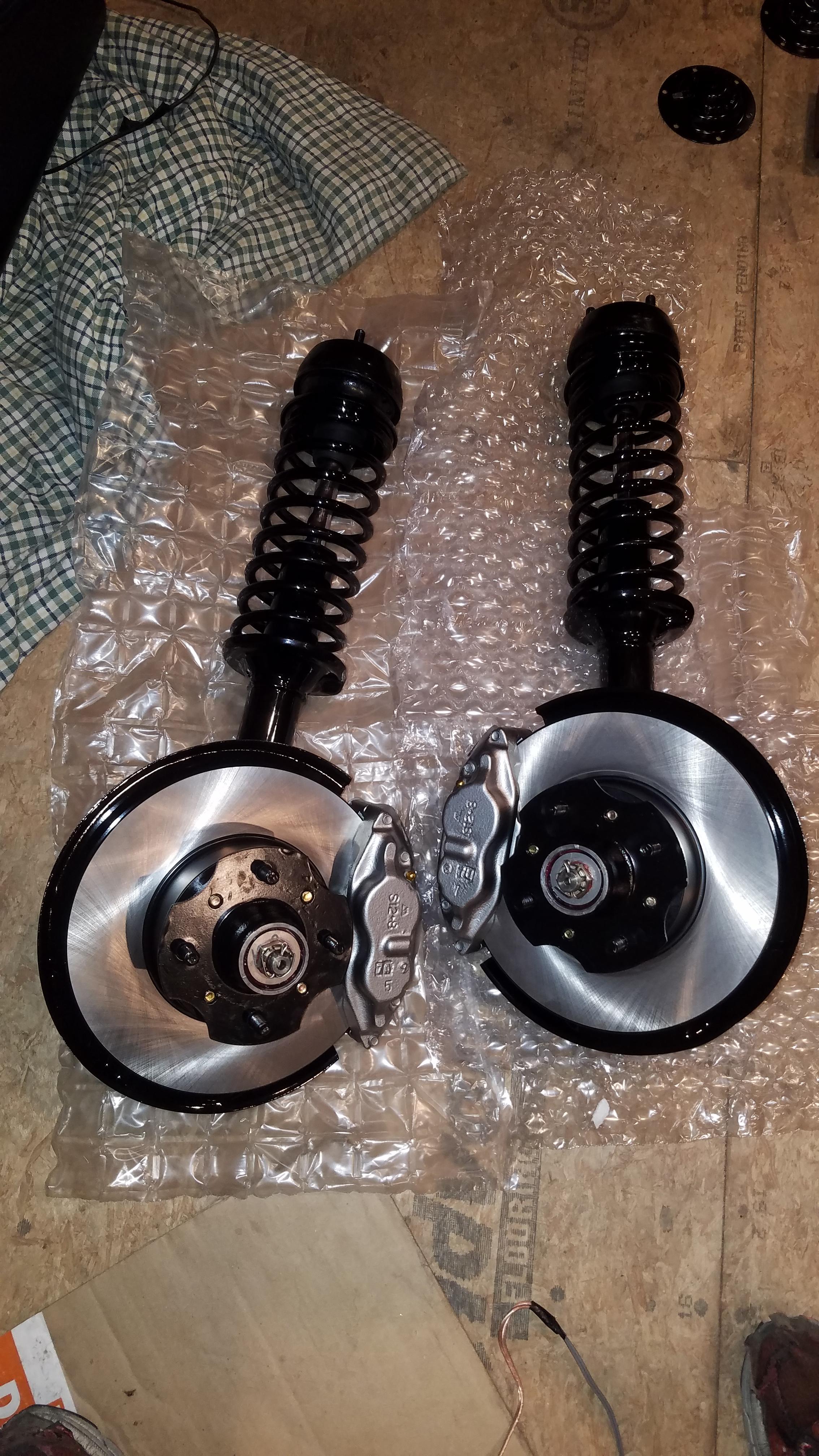

Things were looking pretty sharp post powder coating.  The PO installed Toyota four piston calipers on the front so I kept them.

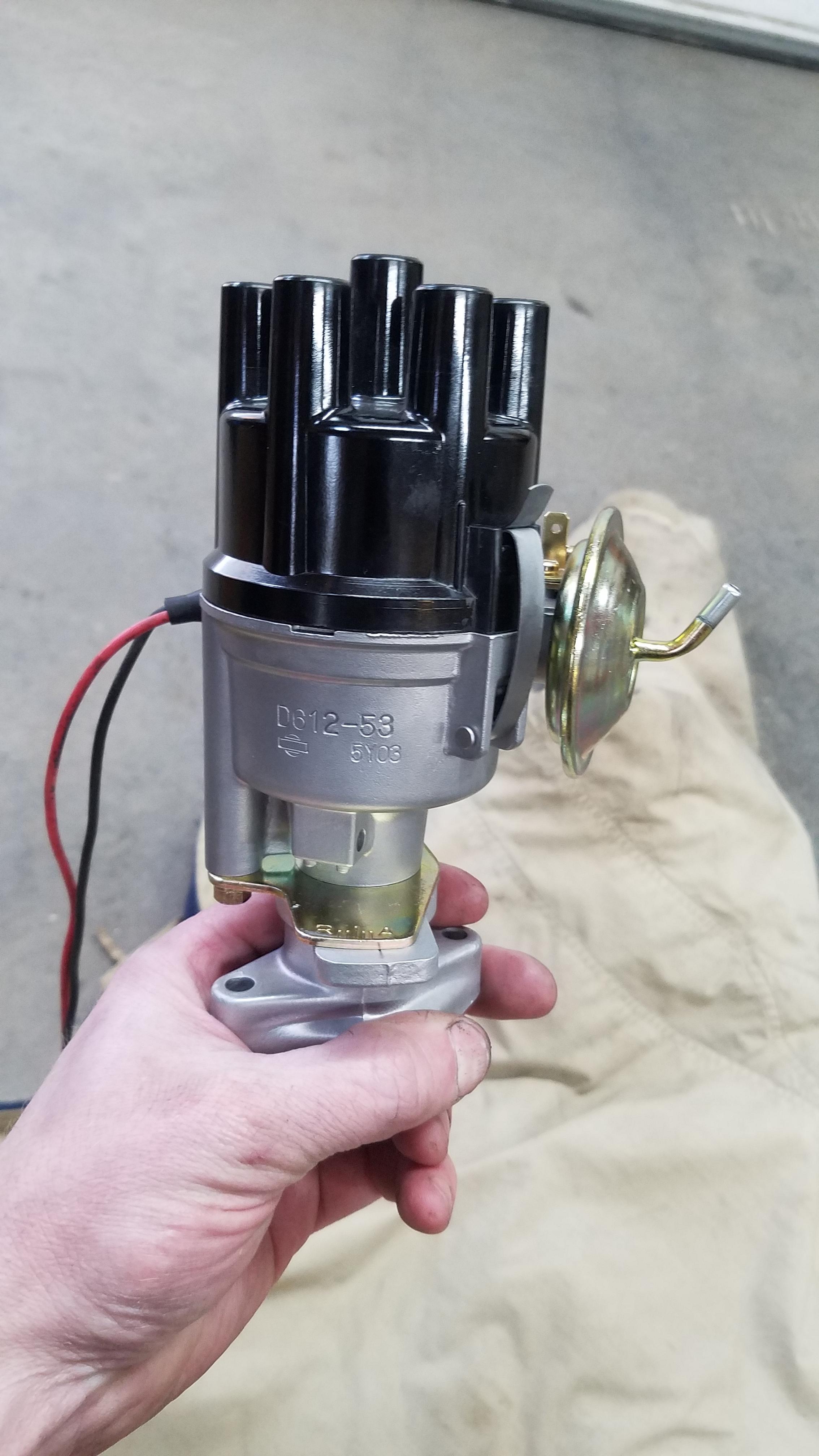

I got all my aluminum vapor blasted which turned out great as you can see on my distributor.

Getting it on and off the trailer was fun. Basically I would jack the car up by the frame rails high enough to get it on the stands that are in my first picture. Then I would jack the stands up and insert scaffolding wheels. It was a tilt bed trailer so I could roll it off.
