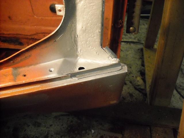

Absolutely, that's a plug weld. With perfect prep the 3M panel bond might work well but personally I think I would have to weld those pieces together.  I would just be afraid that if that bond did lift off or crack the repair job just got a lot more difficult, with welding you know the job is done once.
Z cars consistently rust in those two spots on either end of the deck lid and I'm sure it is because the rain gutter on either side stops 3-4" too soon so all the water that drains off gets dumped right on to the deck lid.  Those corners also slope back a bit so standing water can sit there until it evaporates. While your in there you might consider adding a couple of small extensions like this that will take the water off the car completely.  At least the next restorer 50 yrs from now won't have to deal with the same problem.
Oh I’ll definitely add those to the car. Was there any use of glue on the underside of the panel by Nissan?
I can see why someone would want to use body glue here, it would prohibit water from entering between the top cover and the body underneath.
did you use any kind of paint between the 2 layers to prevent this?
I don't think Nissan used any glue but certainly they would have packed all those joints with seam sealer after the welding.  I believe my panels just had weld through primer on them, then epoxy primer, seam sealer then paint and clear.
I attempted to create a patch on the top panel, and i was not entirely happy with the way the panel formed. To save time (and my eyes every time i look at it) I think ill order a replacement panel.

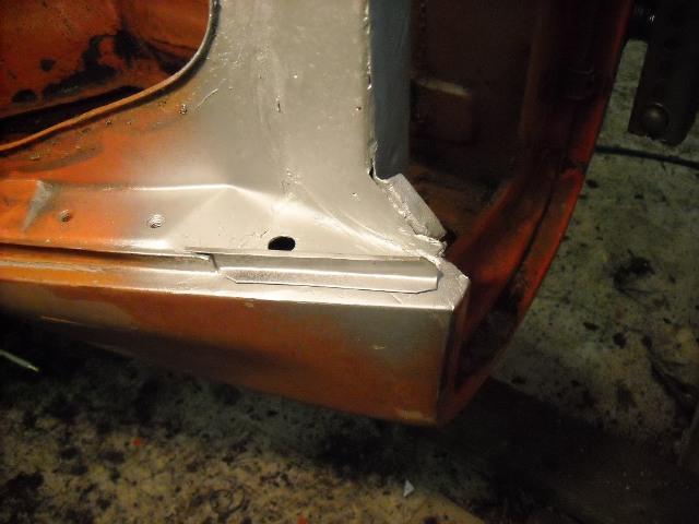

@grannyknot do you have any more pictures of that repair? I cant see the top edge of where the surfaces mate.

does anyone know if there are supposed to be a gap between the corners where the tail light meets the top panel? In the second photo granny posted you can see a pen sized hole right where the outer seal ends.
