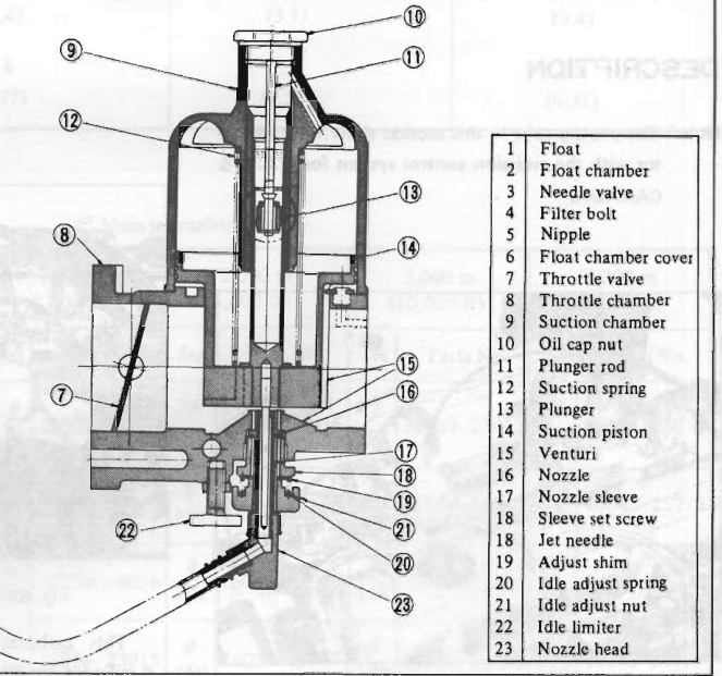

That's what the butterflies are for (throttle valves).  Something isn't fitting here.  If the butterflies are "closed" then the microfiber should have no effect.  Got a camera?  Take a picture of a closed butterfly valve.
p.s. the SU concept is unusual.  The pistons only respond to engine vacuum.  There is no control mechanism for them except vacuum.  the throttle valve controls air flow, the pistons just respond to engine vacuum.
