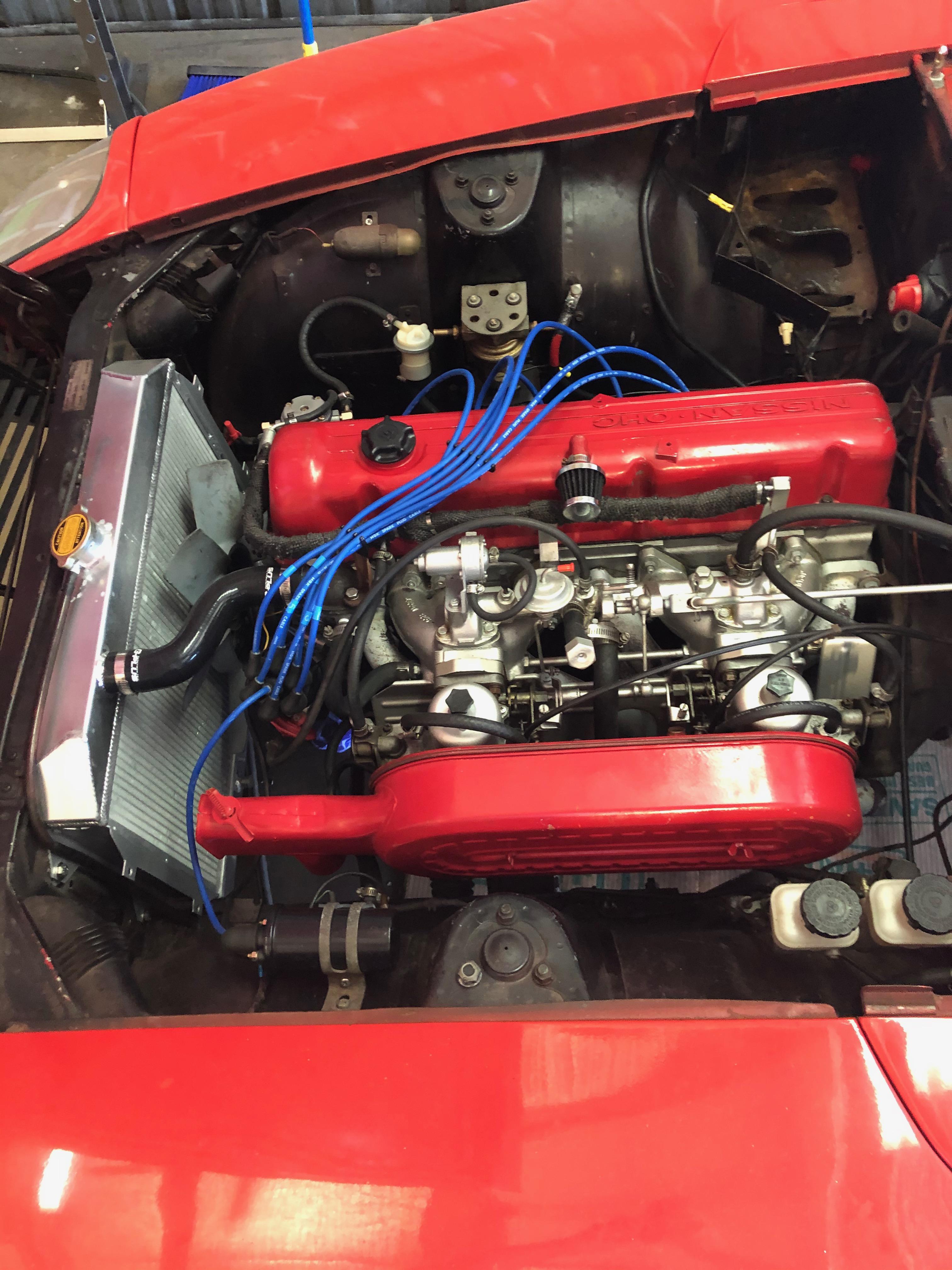

Red early 71 (Originally silver):
Pros:  matching numbers, later version of four-speed, mechanically sound, chrome and badging really nice.
Cons: A whole lot of rust underneath and pillars, etc..

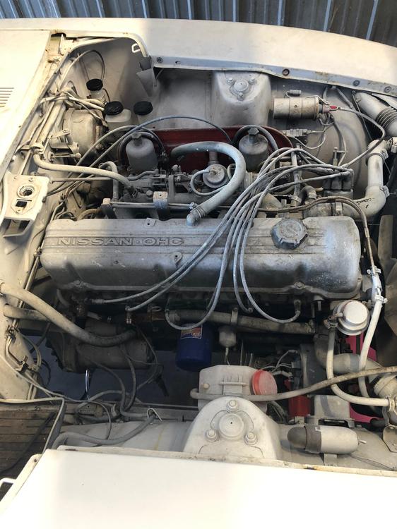

White late 71 ( originally silver):
Pros: No Rust.  Chassis solid, good brakes,
Cons:  L28 Engine not running, five-speed status unknown.  bad clutch, PO paint job is poor, Interior has overspray, white overspray all over engine.  Chrome in poor shape.

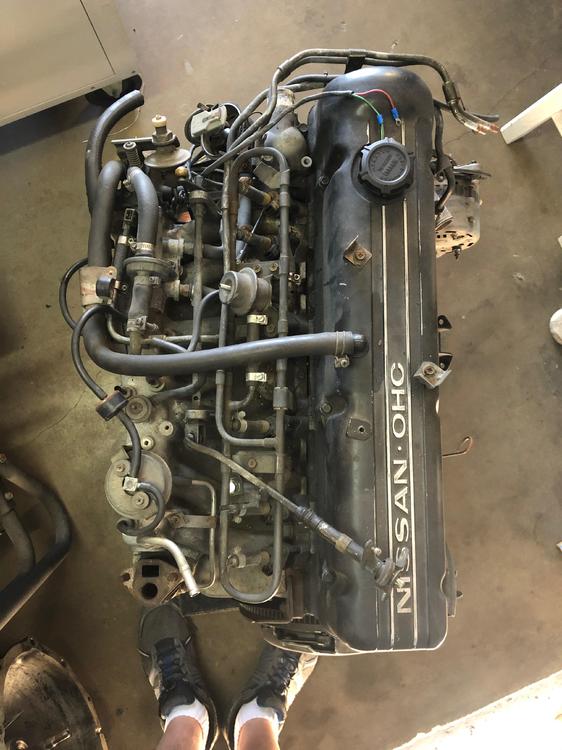

280z motor and five-speed:  Removed recently from low mileage, well maintained, 280Z.  Fuel injection is intact, but missing some wiring (not sure what else).  Mechanic doing work told owner to keep motor in can, but owner wanted big crate motor.

Cons:  I’m not sure what needs to be done to complete the fuel injection setup. I’ve never done FI

Who says you can only have one?  Keep them both! ?   As far as value, the #'s matching car will be worth more when finished.  I don't know how much more rust it has than the white car but just from the photos it does not seem too bad.  I've definitly seen worse brought back got life.  With the white car either fix the current engine or swap with your spare. You'll probably need a EFI wiring harness and a few other parts for that, none of witch should be impossible to find.  Paint will cost you more than any kind of mechanical work. IMO, I wouldn't scrap one for the other, I think it would be a waste

 I would start by putting each cars needs on paper and and then comparing things cost wise.  I tend to lean towards the purist side.  And since the red car being a early 71' and is considered a series 2, I think needs to be kept with its original parts as much as possible. It seems to have had more attention than the white car.  240's in original (or close to original) are getting harder to find.  Of course I can't see how much work each one needs,  so I'm basing it purely on just the few pictures you've posted.  It's just my opinion, but pulling good parts from the red car for the white car is kind of flowing backwards, so to speak,  Others my disagree.  You can sill source badging, interior and engine parts so why not just rebuild  The white one has already been "changed" with the L28 swap and is already in need of a lot of cleaning up.  I think you can more free to do more with it  and not hurt the value.  Both seem like a good starting point. You are very lucky.  By the way, your spare L28 looks to be from a 78'
@gwri8 Good advice.  I'd say I'm more of a purist as well, so keeping the early one all together is a logical. I will do the comparison chart as recommended.  You are correct, the motor is from a '78.  I reached back to the PO to see if he still has the harness for the fuel injection.
How confident are you about the rust on the white car?  The red car presents very "honestly",  while the overspray on the white car looks very hastily done and might be hiding things....

@ConVerTT matching numbers was a bad term...I should have said period correct or model correct or something like that.  The red car has a lot of rust...rusty floor pans, rockers, pillars, etc.  but it can be saved.  The white car is really solid.  You are correct, the white paint was done hastily.  I think I could save a lot of money on bodywork restoring the white one (if I’m correct about solid body).
