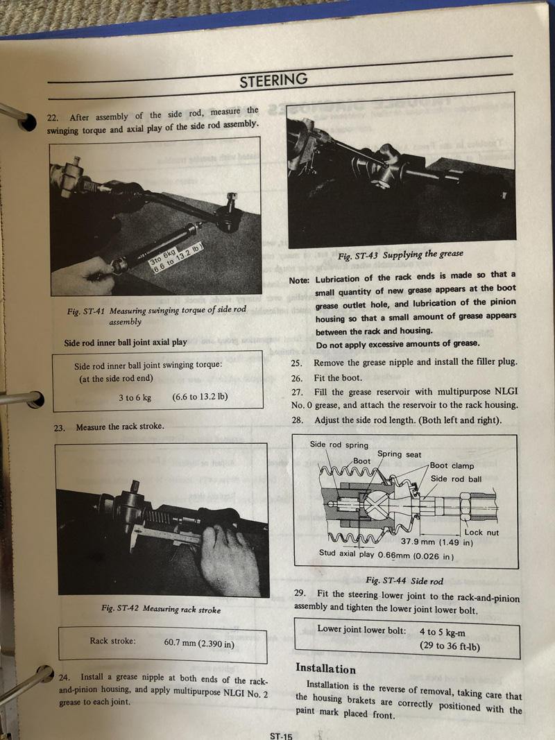

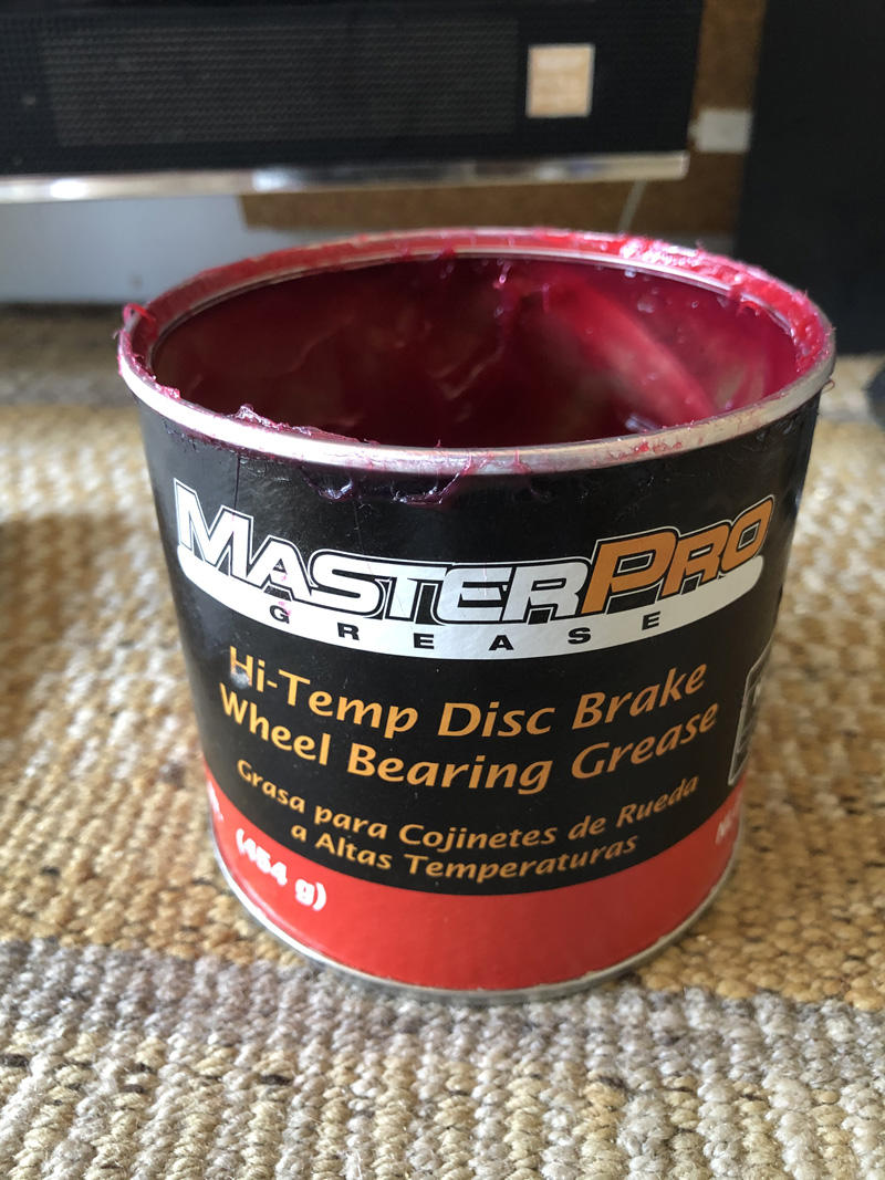

Hey Bill, I've included a page from factory manual that gives rack lube instructions. (another set to consider). It seems to state that No. 2 gets used on the rack and pinion gears and the only place they specify No. 0 is in the little gravity feed reservoir screwed to the top of the housing. Zerk fitting is temporarily borrowed from pinion housing to grease tie rod inners thru the hole on the rack shaft and then reinstalled on housing. I have always wondered why the diffo grease here and I was guessing it might flow easier down into the housing when needed??  After researching I'm using same grease that was used on my wheel bearings as shown. 50 years ago the manual asked for a lithium based No2 Grease and this red stuff is lithium based. If anybody wants to chime in and give me a thumbs up or down I welcome the input. Good Luck!!
