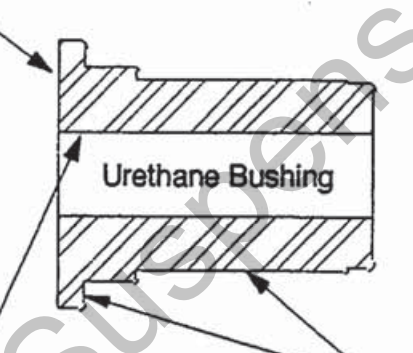

 There is no direct metal-to-metal contact between the strut housing and the control arm (with either the stock rubber bushing, or the PU aftermarket replacements). If you cut off that PU flange and replace with metal washers, you'll end up with metal-to-metal.

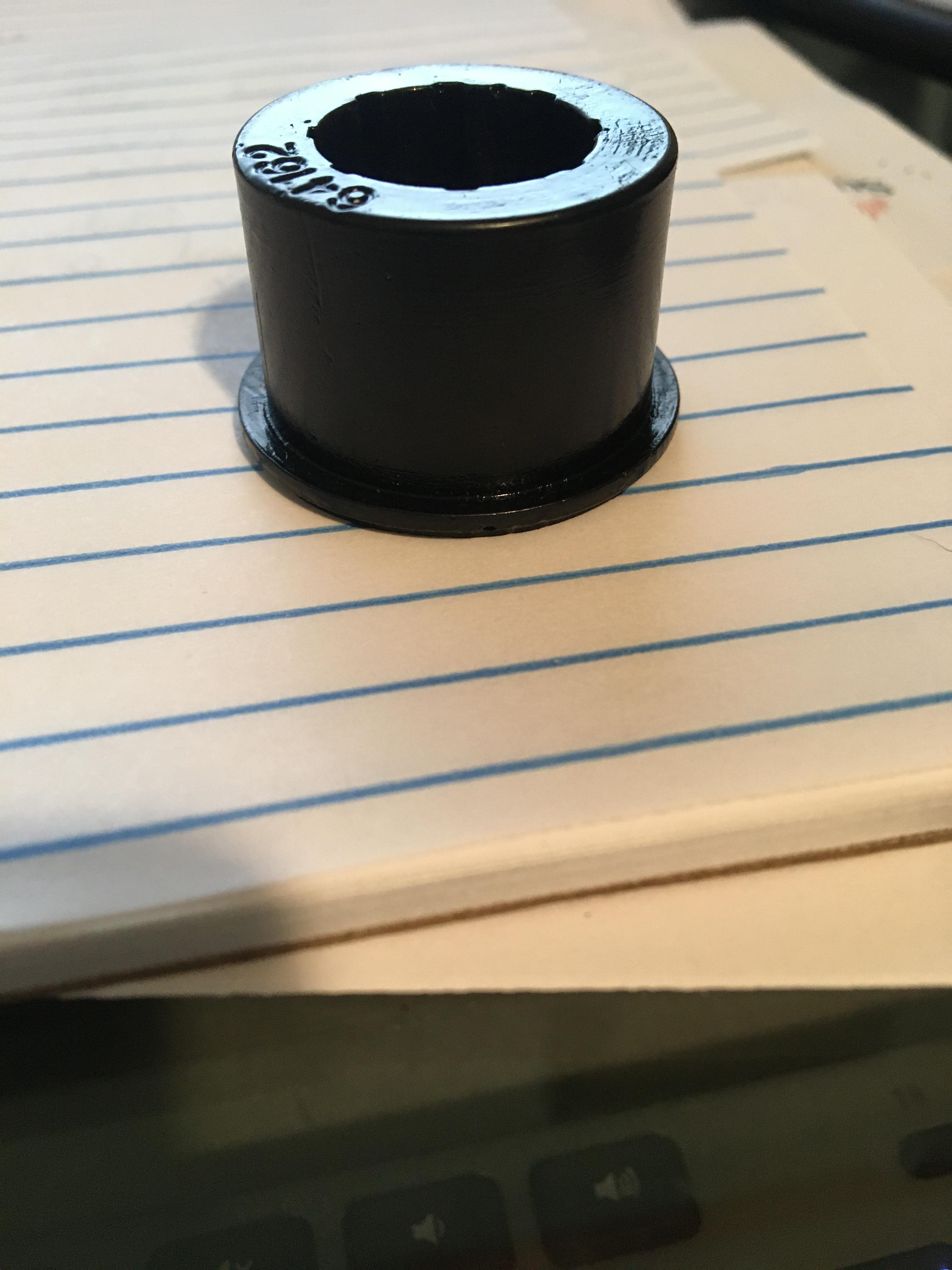

I'm sure that the rubber in the factory bushings deflects enough to allow metal to metal contact.  I found an image and pasted it as illustration.  The only thing holding that little gap open is the modulus of the rubber.  And that's not much.
The PU bushings probably started as good "upgrades" for certain bushings, making things stiffer and less compliant.  But many of the other applications just really aren't better than the factory bushings.  Put an eyeball on that factory bushing with the thin rubber between two steel sleeves and compare it mentally to the replacement PU piece.  I left my rear rubber in place, even though I had the PU as part of a kit.  Just couldn't see a benefit.

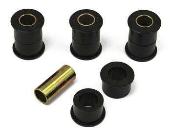

Urethane Spindle Pin Bushing Kit, 70-78 240Z-260Z-280Z
Urethane Spindle Pin Bushing Kit, 70-78 240Z-260Z-280Z Quantity in Basket:none
Code: 23-4180
Price:$39.95
Quantity:
Description:
Replacing your spindle pin bushings is a must when removing your spindle pins, especially if the pins have never been removed before. This urethane kit replaces the factory rubber washers and spindle pin bushings without replacing the inner control arm bushings. Sold as a complete set for both spindle pins only, see Related Items below for the complete rear control arm kit that includes these.
Note: The outer metal sleeve of the factory rubber spindle pin bushing is retained for use with this kit. Urethane Spindle Pin Bushings are oversized and will require a press or vice to install. Please call with any questions prior to removing your stock spindle pin bushings.
Model Guide:
Datsun 240Z, 260Z, 280Z
Code Guide:
Datsun S30
Year Guide:
1970, 1971, 1972, 1973, 1974, 1975, 1976, 1977, 1978
