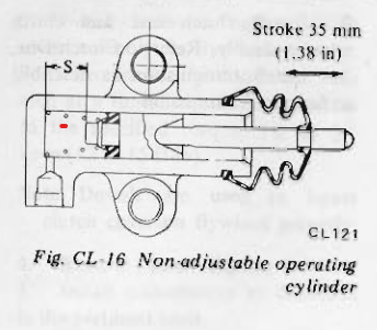

May 6, 20204 yr comment_598990 EuroDat explained it in the post below. There's a spring inside the 280Z style slave cylinder that takes up all of the play at the clutch fork. It can't apply much force, it's a small spring, but it is there and it does work. If I was checking that theory out I'd crawl or reach under the car with the engine running and move the fork away from the pressure plate by hand. You can reach it from the engine bay also. You might have to have someone sit in the car to listen since the noise is amplified in the cabin. Here's the FSM drawing. I put a red dot under one of the spring coils.  Edited May 6, 20204 yr by Zed Head Link to comment https://www.classiczcars.com/forums/topic/63959-new-clutchnoise-when-clutch-is-not-depressed-and-trans-in-n/?&page=2#findComment-598990 Share on other sites More sharing options...
