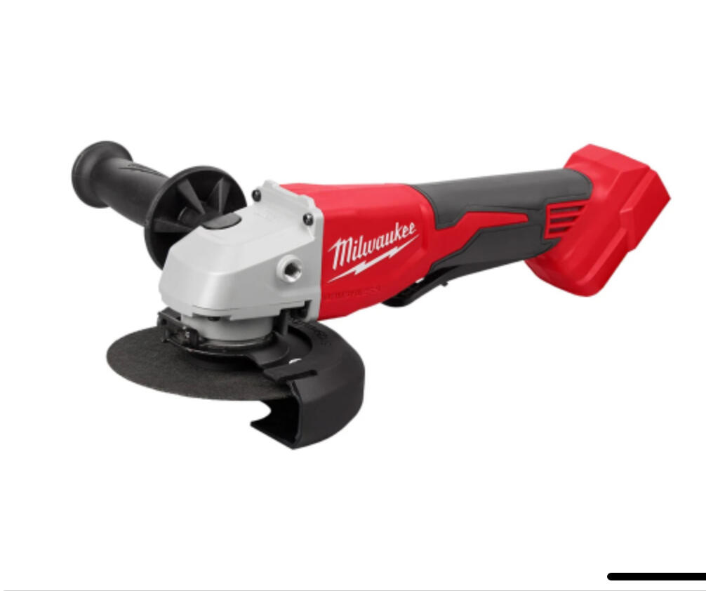

May 27, 2024May 27 comment_665911 Zippity doo dah! Link to comment https://www.classiczcars.com/forums/topic/63969-which-oil-pan-will-fit/#findComment-665911 Share on other sites More sharing options...
May 27, 2024May 27 comment_665912 Or a smaller version would be a dremel with the cut off wheel and pliers! Link to comment https://www.classiczcars.com/forums/topic/63969-which-oil-pan-will-fit/#findComment-665912 Share on other sites More sharing options...

June 2, 2024Jun 2 Author comment_666095 Between my Rotozip and Dremel I was able to cut the heat shield off this morning. This takes a while but can be done with the engine in the car from underneath. Just be careful not to cut other things, like the oil pan itself. 🙂 I hit it with some paint and am just waiting for that to dry before returning to installing the headers. Thank you all for the pointers!! Link to comment https://www.classiczcars.com/forums/topic/63969-which-oil-pan-will-fit/#findComment-666095 Share on other sites More sharing options...
