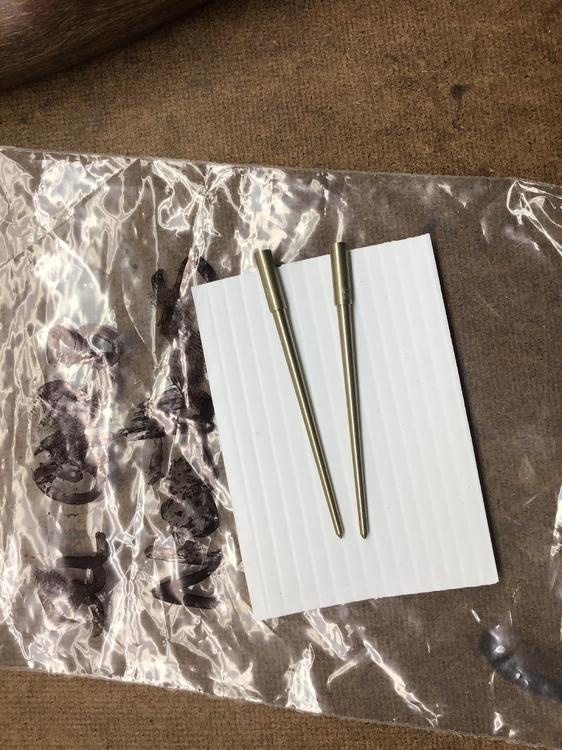

They came with my rebuild kit from ztherapy. My car runs very well them but honestly that's all I've ever had with a rebuilt motor and carbs. Nothing to compare against.
Somewhere on their website it says they're a good all around needle.
I have run them in my L28 240Z, great AFRs on acceleration but a little rich on cruise (for me).  Randalla uses them on his L28 Z, is very happy with them.  I ended up going with the TF needles; leaner at cruise, still strong at WOT.
Edited by duffman
Interesting. Now it is beginning to come back. Last dyno run we did as a club I was running lean on WOT and someone said to try these.
when we made it richer at WOT it was to rich at low speeds. Maybe I will wait till we can get to the dyno again and run both.
thanks

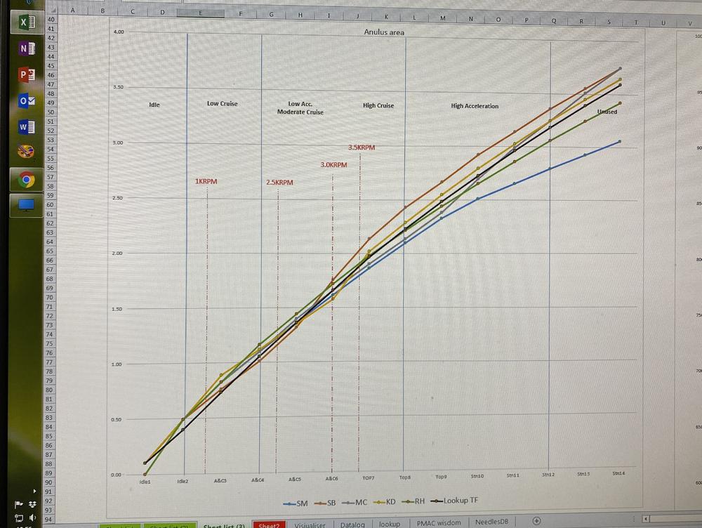

So gents - I have a small unhealthy SU and needle work obsession and spreadsheets that do all kinds for me. Here is a plot of the “annulus” area (jet opening) with the needles discussed and the SMs that come with the ZT carbs.
I’m currently running KD but soon to test MC. But my engine is very modified.
cc1ae20d230e187226c2447fd22e5b94.plist
Hope this chart helps with your deliberations!

Any chance of sharing the spreadsheet itself?
They came with my rebuild kit from ztherapy.   Somewhere on their website it says they're a good all around needle.
 Are you sure they weren’t SM needles? I may be wrong but I understood they shipped SM by default on all their rebuilt carbs. [emoji848]
 Interesting how different engines can respond. I found the SB going very rich on my engine. Way too lean at idle if I was to dial them back. Doing this you get very hot idle which in my case is bad as queuing on the motorway or at tracks etc on a hot summer day is a regular occurrence.
I also suffer with horrible reversion around 3.1-3.5k rpm so the SBs just didn’t work with my car. There is a chap who posts on youtube with a stroker - he says they work very well for him. But I’m guessing a 3.0 high comp engine needs more fuel than my high revving 2.8 that is still building power at 6.5k rpm.
The thing with making a rich needle leaner to make it work better at WOT is that not only can you get lean idle but I found it ruins the quality of pickup and throttle response.
Interesting. Now it is beginning to come back. Last dyno run we did as a club I was running lean on WOT and someone said to try these.  when we made it richer at WOT it was to rich at low speeds. Maybe I will wait till we can get to the dyno again and run both.  thanks
I would love to as I see this as open research for the Z community at large - but I am hesitant to share quite yet. It is currently not at all user friendly - you have to understand how it works to make it work. Once I have it all tied down then I fully plan to share.
However, in the meanwhile, I would highly recommend this site:
Http://www.mintylamb.co.uk/suneedle/
Drop in your reference needle, select a second needle and use the up/down scroll bar to quickly scan through profiles. It also allows you to download ooodles of profiles (which is where my unhealthy excel based obsession started)!
Again, I would urge any needle changing to be monitored with an AFR meter in real world driving.

Very interesting AK260. This confirms my experience running 5-6 different profiles and monitoring an AFR meter I mounted on my steering column. My fresh built 2.8L motor has dished pistons (turbo block), an E88 head with port work and un-shrouded valves. I'm running a 276 lift, 480 duration cam and a 2 1/2" exhaust with straight through glass-pack. I used dished pistons to eliminate any possibility of detonation when setting total timing at 36 degrees, even though compression is down. With the SB needles the car runs very strong on the dyno, 180 hp at the wheels (roughly 220-230 at the crank). Torque was 225 ft. lbs. As a regular driver, the SB needles were too rich at lower RPMs for my liking. Couldn't stand the smell. I ended up defaulting to TF needles, which ended up being a compromise I could live with. Your chart shows exactly what I've experienced. Great to actually see it diagrammed. Thanks!
