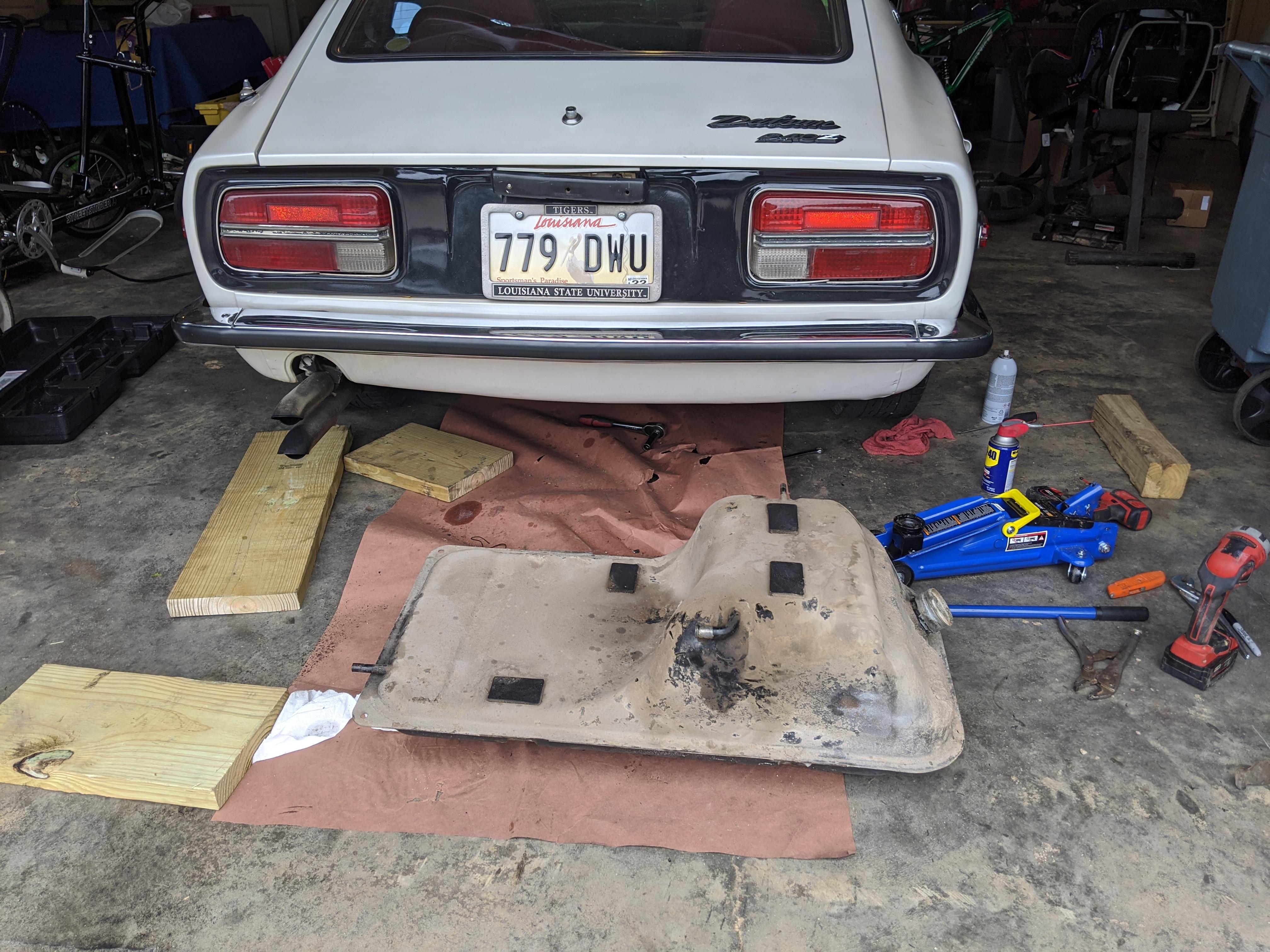

Step 1 is done. Dropped! Tank goes to the radiator shop Monday. Noted that there was no O-ring on the sending unit. Both of the big vapor hoses along the tail were dry-rotted. Anyone know of a good source for them?
