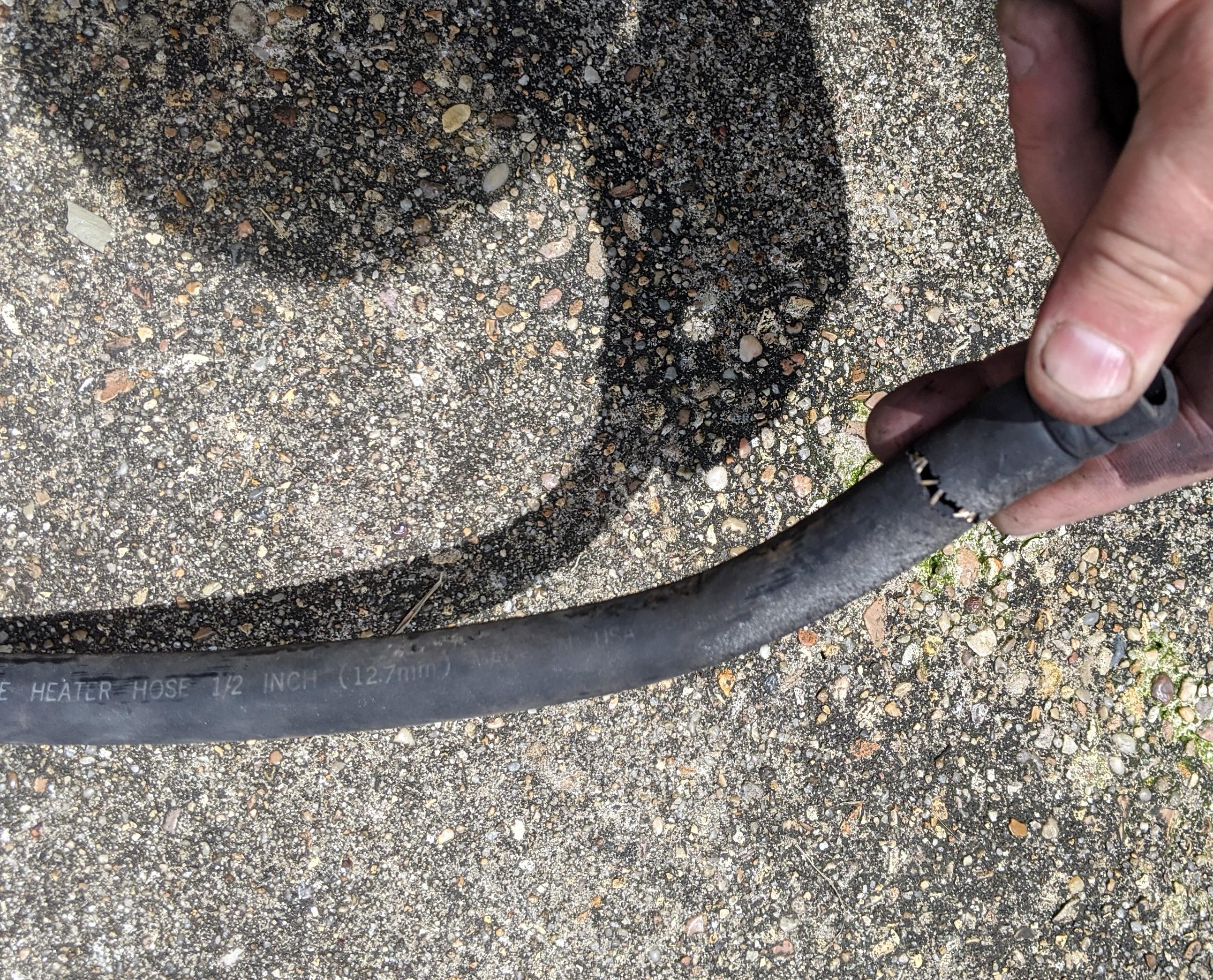

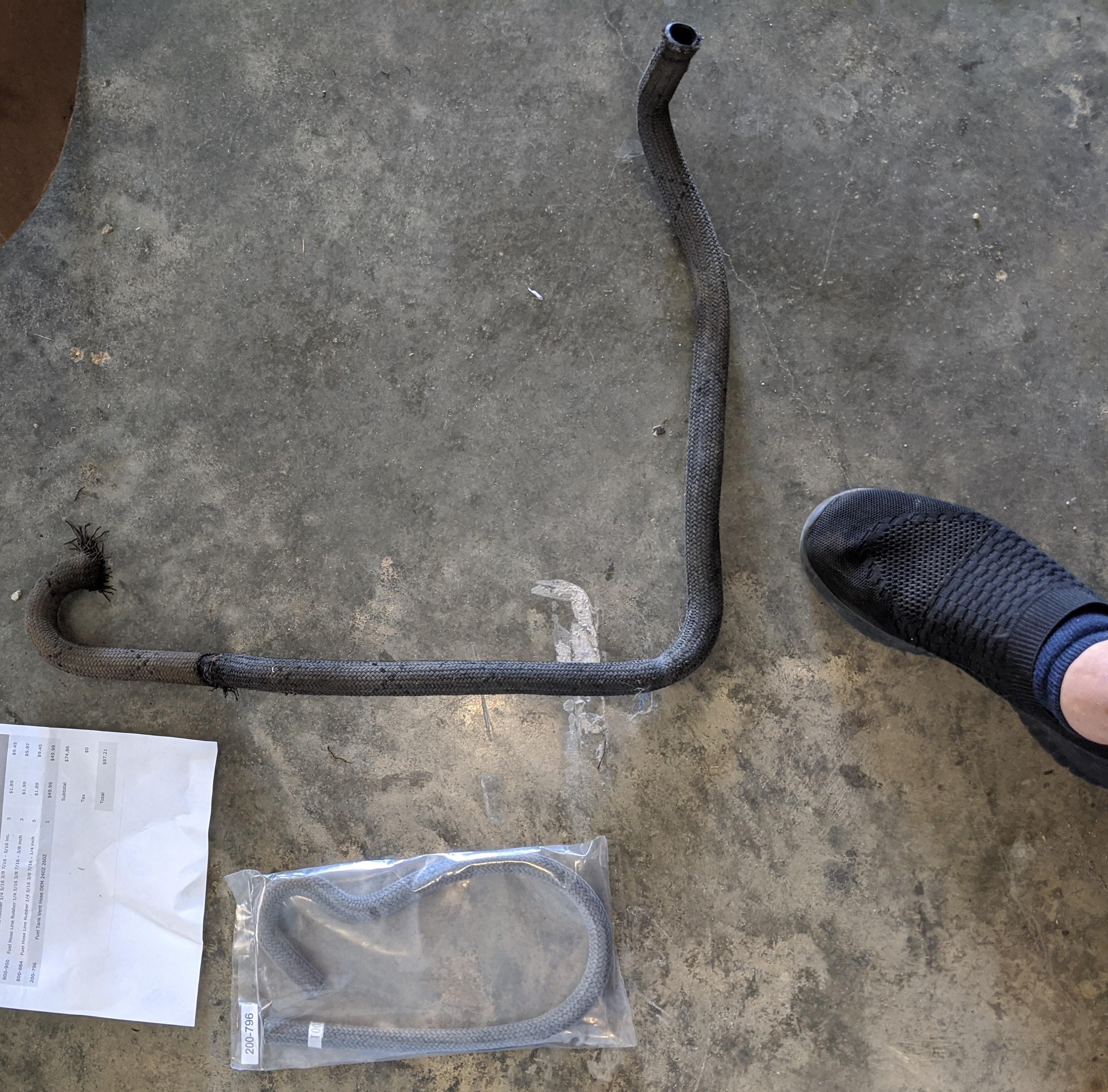

The longer 6+ ft vent hose that runs to the opposite side was at one point replaced with a 1/2" heater hose. Argh. You can see in the pic where is has rotted out where it meets up with the tank.

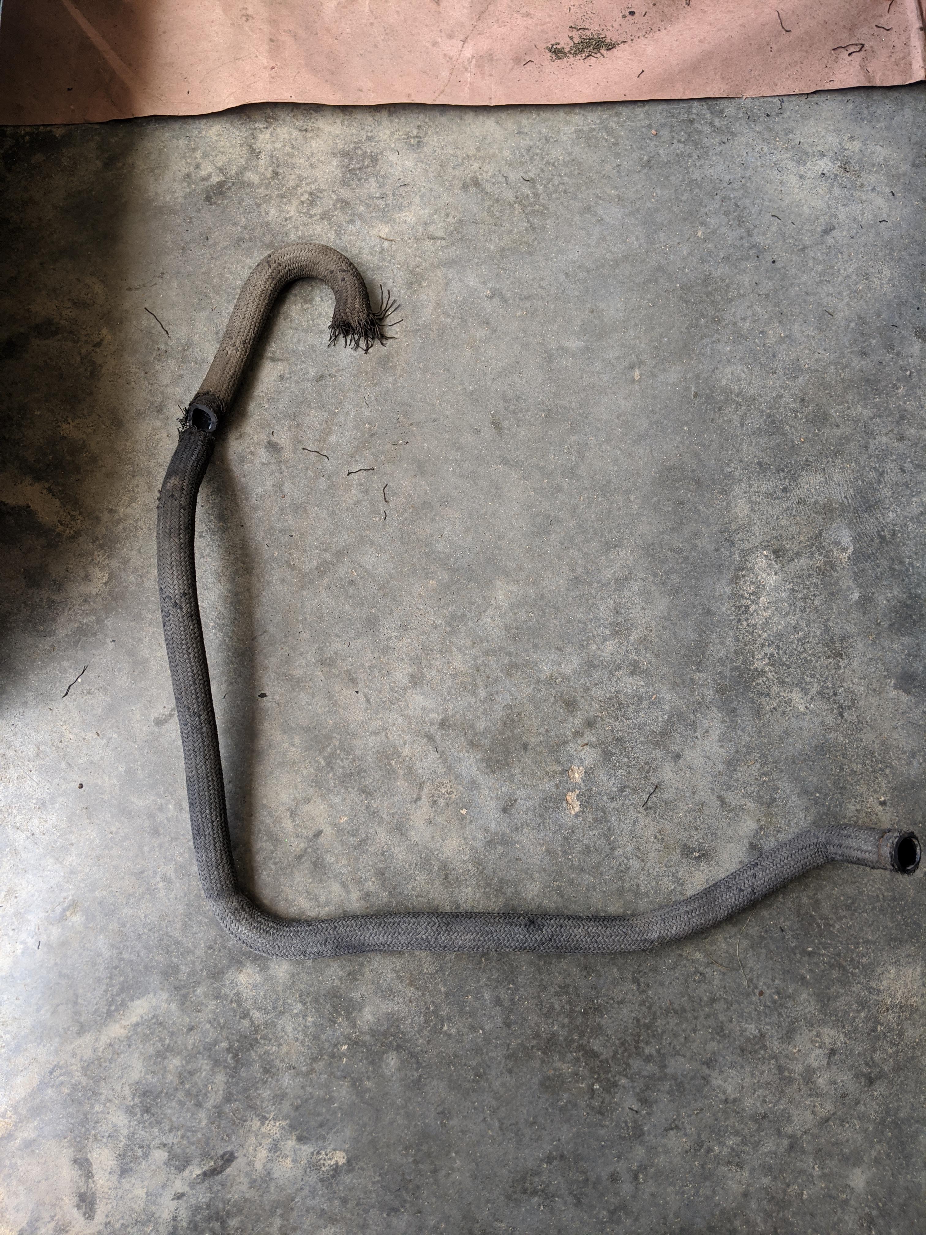

And the "special" large vent hose with the preformed bend is toast. Between this and the fact that my shifter boot was disintegrated, it's no wonder the cabin reeked of fuel and exhaust.

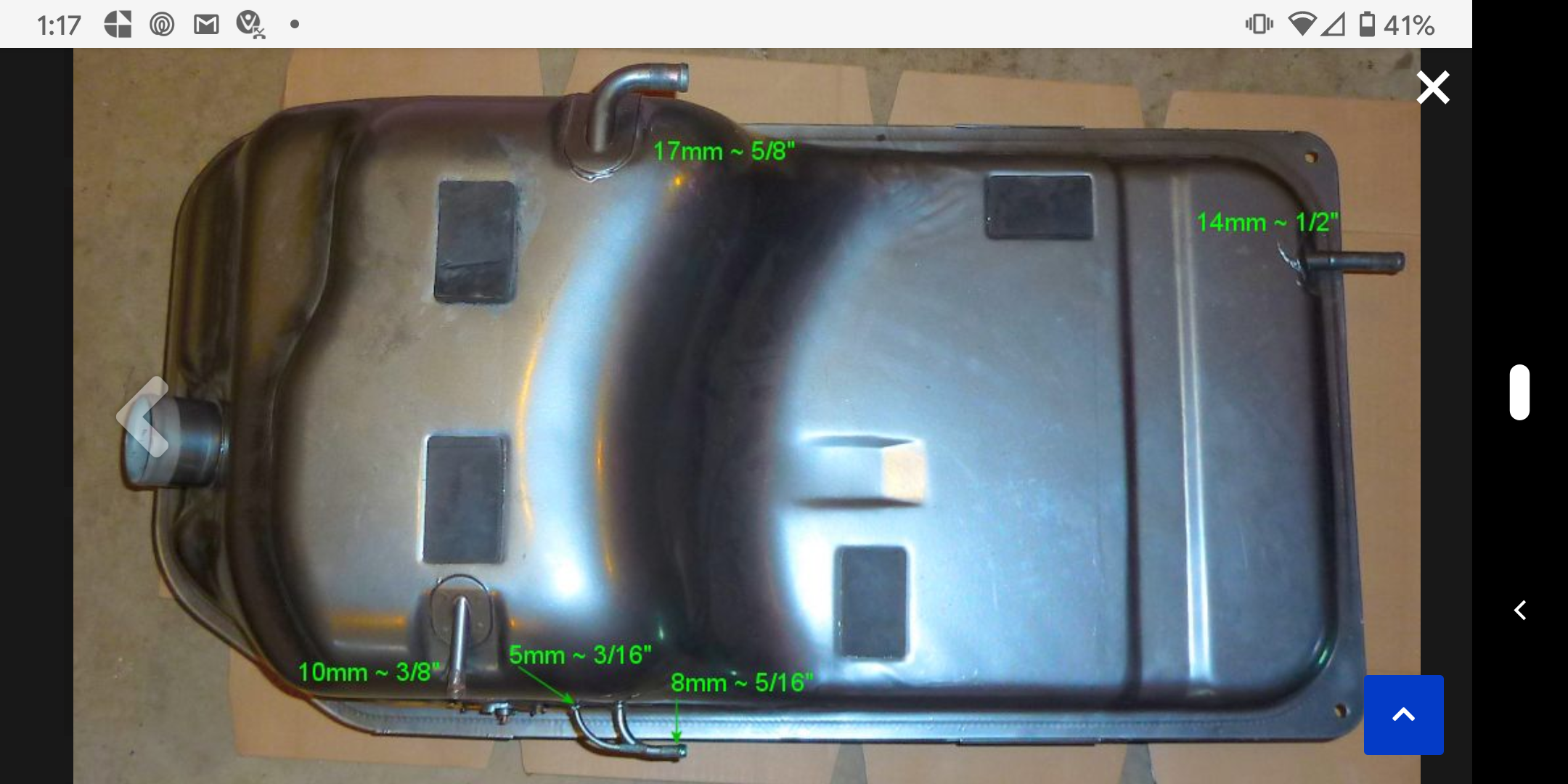

The other linked thread was useful, although there are a lot of dead links to reference and parts sites. This last pic was buried in there. Diagram of the tank with hose sizes called out.

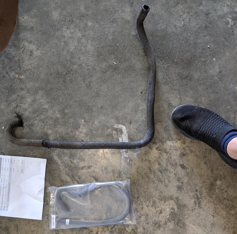

Argh. Just got my zcardepot order in for some of the vent hoses.
See pic. The special bend hose I thought I was getting is much smaller. Is the one in the package supposed to go on the vent opening just above the sending unit? It obviously doesn't fit the 5/8" vent near the back right bumper. That's the one that was rotted. I guess at this point I'll go buy four feet of that and two elbows. :-(
