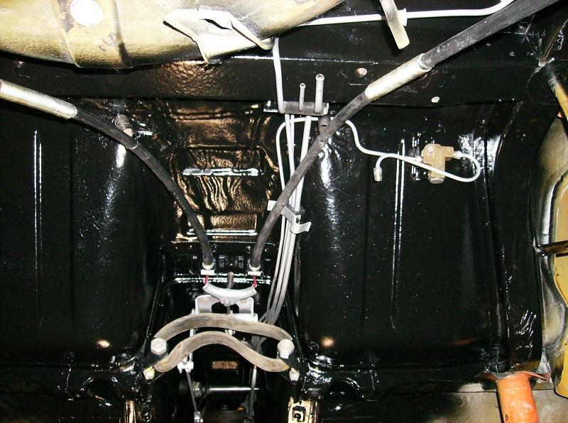

Posted May 8, 20204 yr comment_599072 I took no pictures and for the life of me I can't remember what goes in the "hose" section of this isolator clamp. Please help! And please ignore my poorly plated fuel lines! Link to comment https://www.classiczcars.com/forums/topic/63985-fuelbrake-isolator-question/ Share on other sites More sharing options...
May 8, 20204 yr comment_599085 *just a guess* The speedometer cable from the transmission to the engine bay????? Link to comment https://www.classiczcars.com/forums/topic/63985-fuelbrake-isolator-question/#findComment-599085 Share on other sites More sharing options...
May 9, 20204 yr Author comment_599104 It's wider than the speedo cable ans I'm pretty sure it belongs on furthest back isolator Link to comment https://www.classiczcars.com/forums/topic/63985-fuelbrake-isolator-question/#findComment-599104 Share on other sites More sharing options...
May 9, 20204 yr comment_599106 I have the same isolator on my car and that clamp/fitting is unused. Edited May 9, 20204 yr by jfa.series1 Link to comment https://www.classiczcars.com/forums/topic/63985-fuelbrake-isolator-question/#findComment-599106 Share on other sites More sharing options...
May 9, 20204 yr Author comment_599107 That makes me feel feel better. I have no clue what would go there. Thanks Link to comment https://www.classiczcars.com/forums/topic/63985-fuelbrake-isolator-question/#findComment-599107 Share on other sites More sharing options...
May 9, 20204 yr comment_599119 The parking brake cable goes there. Link to comment https://www.classiczcars.com/forums/topic/63985-fuelbrake-isolator-question/#findComment-599119 Share on other sites More sharing options...
