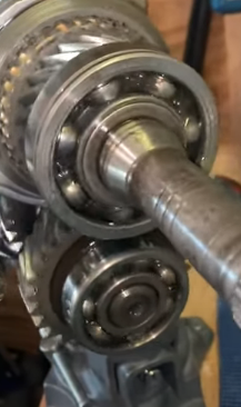

Underneath the plastic seal is a bearing just like these, from your video, with the retainer wrapped around the balls in the races.  You can actually get those exact bearings in a sealed form if you wanted them.  Some people use a sealed bearing for the countershaft bearing.  Maybe it keeps it quieter.
I'm not so sure it's a huge deal, really.  There are holes in the adapter plate, at the bottom, I think that allow oil flow.  The bearing is loaded with grease before they seal it.  But if you peel the seal out you won't hurt anything.
Yikes, that's a scary video.  I'll bet you were sweating, maybe still are, wondering about pulling it out.  But, it's just metal a seal instead of plastic.
It looks like it might actually be more of a metal shield to keep crap out.  I didn't se any grease, so pulling it will give more lubrication.  Can you see the other side?  The sealed bearings are sealed on both sides.
As Dave said though, the retainer and races hold the bearings in place.  The retainer, the metal piece with the bumps in it, is actually also a spacer, keeping the balls separate so that the inner race stays centered and the balls can't get torqued out.  Without that piece the balls all end up on one side with a big gap on the other.

I’ll start poking around that bearing to see it that black casing comes off. May even video it to show you all because to my eye this looks likes it’s part of the bearing assembly,  it I’m trusting you all.  Seems like a JV move for a guy to leave it in there.  All my parts are in order thanks to EuroDat’s parts list.

p.s. if you can find the number on that bearing you might be able to look it up to see what, exactly, it is.  I'm sure it's fine, but just curious.  The number's probably engraved on the side of the outer race.

Looks like Dave and Chas were right, best to have good lubricant flow through yours.  It's not what I thought it was.

Yes, I was sweating it. “First do no harm”. May have violated that. Yes there is another one on the opposite side. I need to account for the debris. I’ll hit it with compressed air before reassembly.

Back to the bearing topic. So you all saw I was able to get one side of that bearing cover off. The other side doesn’t look possible. It’s too deep and inaccessible. My question is will it be okay to not remove the other side. Any potential problems if I just leave it there?
with as much angst it gave you on the other side I would say leave it, you have good lube from the one side and if ZH is correct there are holes for the oil to flow thru the adapter plate already. I can see how getting at that one and having to tear it out could be dicey. I had assumed it was a rubber seal which would be much easier to pull with a hooked pick. Or get a good stiff belt of whiskey and go for it :)
