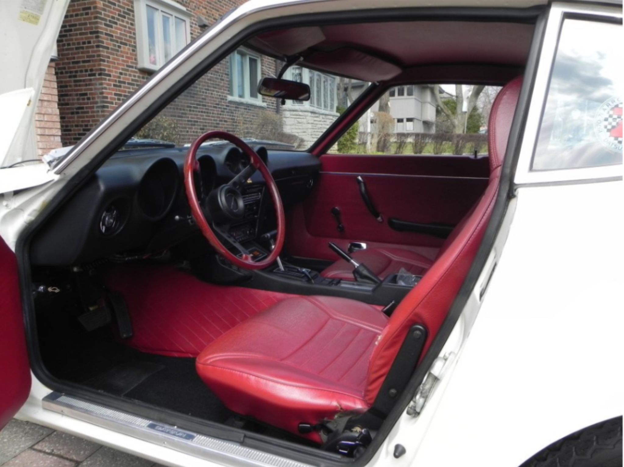

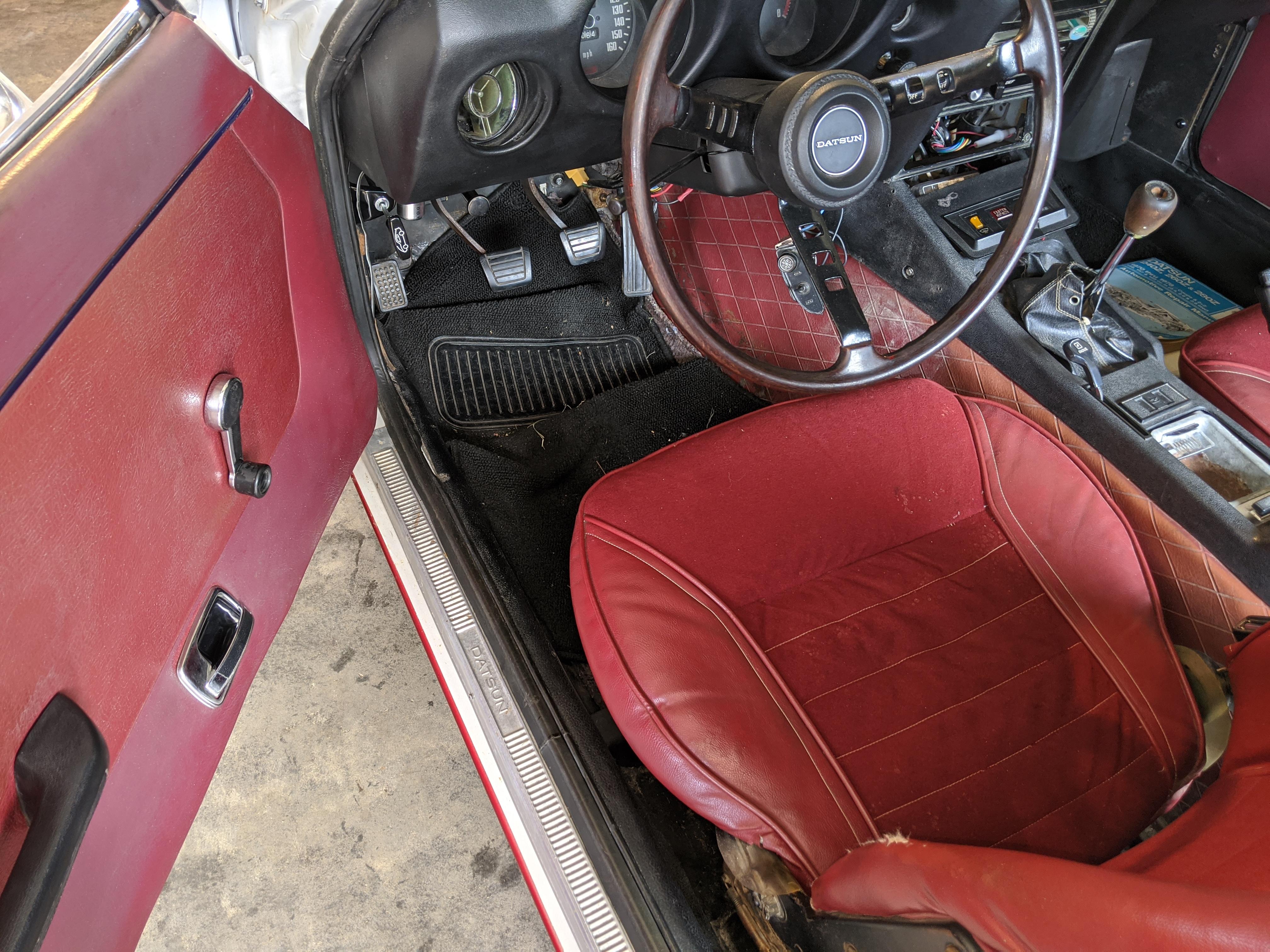

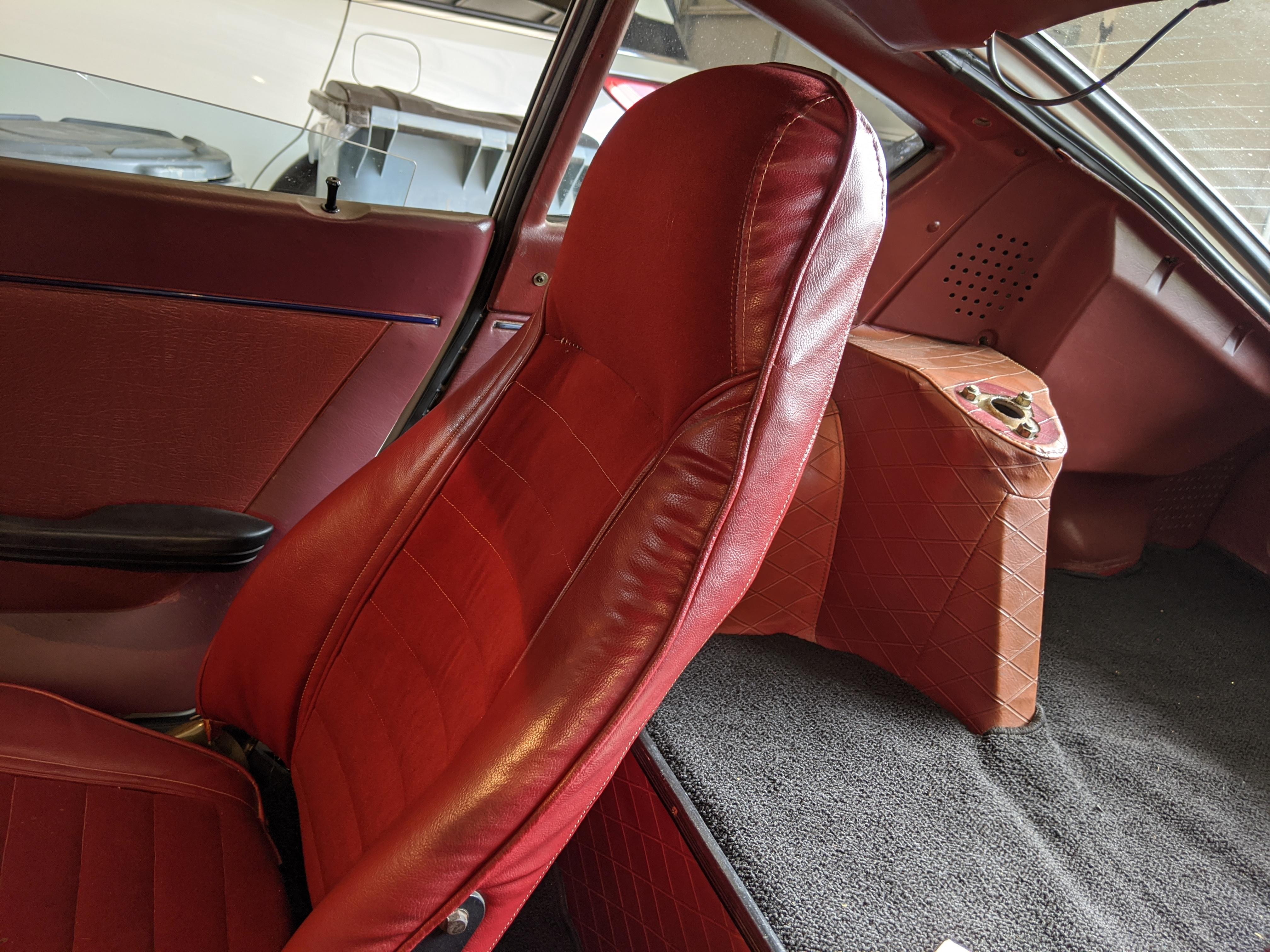

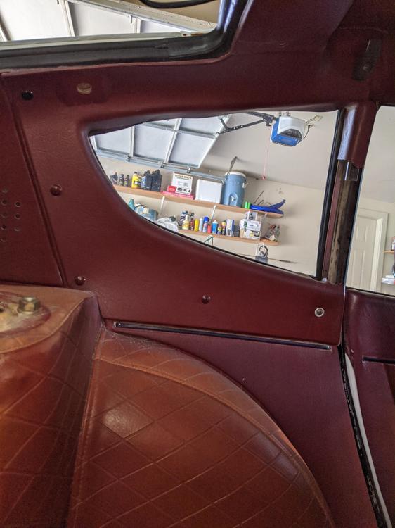

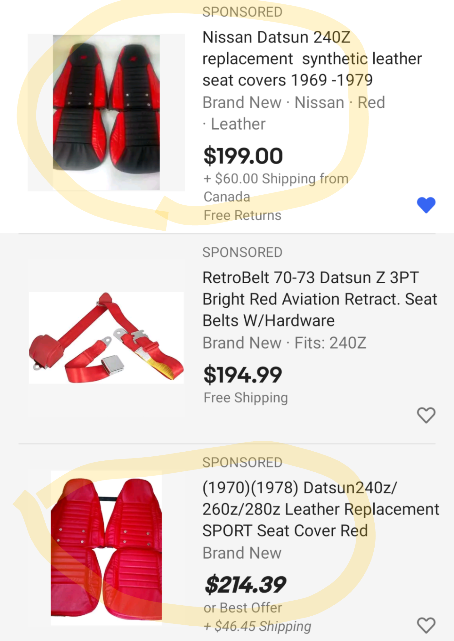

Posted May 14, 20204 yr comment_599408 First 3 pics - This is my current interior. 4th pic: What I think a restored interior would look like. 5th pic: Two seat cover options on eBay, add in New seat foams from California Datsun, etc. But, what's considered properly restored? Take the seats I have to an upholstery shop and have them match the console cover? It is faded. I think I would be better off to get the seats sorted out first, then look for someone to dye/color the rest of the interior red to match. Also have to sort out a redo of the door and window quarter panels. Edited May 14, 20204 yr by Dadsun Link to comment https://www.classiczcars.com/forums/topic/64015-seats-whats-considered-restored-vs-redone/ Share on other sites More sharing options...
May 14, 20204 yr comment_599425 'Restored' means whatever you want it to mean. It all depends on what's important to you. The factors that typically come into play: 'original' vs. 'improved' vs. 'custom' (one person's idea of 'improved' is another person's idea of 'ruined') color match (make the new seats match the faded trim? Or replace the faded trim to match the new seats?) cost (see Item 2) appearance (see 'original' vs ''improved' vs 'custom' manufacturer's warranty ergo comfort (the OE seat design is 'just ok' in this regard. Some people replace them with Miata seats for this reason.) other comfort issues (leather is nicer than vinyl if you live in a hot-sun region) quality of fit (some replacement covers fit better than others -- although a good upholstery shop can probably overcome this) smell (most prefer leather over vinyl... while others consider the Z' interior's scent-of-vinyl to be part of its charm) durability (I haven't heard any bad reports about the leather covers, but they are stitched and that can sometimes lead to problems. As most of us know, the outboard upper seat bolster in these cars take a beating. The lower seat cushion is a high-load area, too.) It will probably help you most to get advice from our members on what not to buy (and why). From that point, it's pretty much up to you and whatever you think will make you happy. Edited May 19, 20204 yr by Namerow fixed missing line space Link to comment https://www.classiczcars.com/forums/topic/64015-seats-whats-considered-restored-vs-redone/#findComment-599425 Share on other sites More sharing options...

May 14, 20204 yr comment_599448 Different light sources really affect photographs and I constantly see three different tones in the door panels and tunnel vinyl in your pictures. Are there really different tones or is it all about the same?  As far as panels and vinyl go, They can be painted.  My panels are brown were faded badly.  Black panels seem the most readily available to replace with and I didn't want that  so I went to an automotive paint store and had them match the inside of one of the panels with SEM paint (almost a ginger/brown color). I needed to clean and prep it first,  but they came out great and still look fresh after two years. I did the same thing with the door panels and strut housing vinyls only using custom mixed vinyl spray paint.  My seats were toast when I got the car so I replaced them with new foam and covers.  So, unless you're doing a concours car, I personally don't think there is too much of a penalty for restoring or redoing interiors. Link to comment https://www.classiczcars.com/forums/topic/64015-seats-whats-considered-restored-vs-redone/#findComment-599448 Share on other sites More sharing options...
May 14, 20204 yr Author comment_599450 15 minutes ago, gwri8 said: Different light sources really affect photographs and I constantly see three different tones in the door panels and tunnel vinyl in your pictures. Are there really different tones or is it all about the same?  Yes, the color really does differ that much throughout the interior. The original tunnel and strut tower covers are vinyl, correct? If so, yes, I'm inclined to just move forward with picking my seat covers and then trying to paint the tunnel, tower covers, door panels, plastic interior panels to all match closely with my seat color. Link to comment https://www.classiczcars.com/forums/topic/64015-seats-whats-considered-restored-vs-redone/#findComment-599450 Share on other sites More sharing options...
