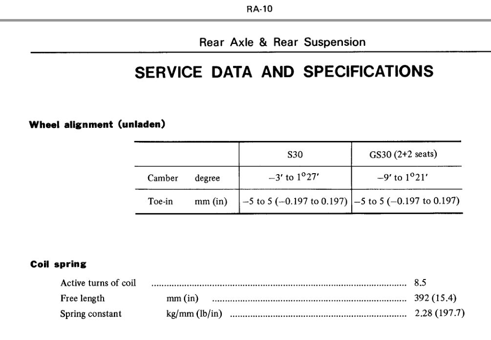

May 20, 20204 yr comment_599844 This place is really just one guy. You could call him and see if he'll sell you just two. https://zcardepot.com/collections/suspension/products/coil-spring-set-stock-and-lowered-240z-260z-280z Edit - also, just thought of this, there are places that will wind you a spring. The spring data is in the FSM. Edited May 20, 20204 yr by Zed Head Link to comment https://www.classiczcars.com/forums/topic/64040-1975-280z-rear-coil-springs/#findComment-599844 Share on other sites More sharing options...

May 22, 20204 yr Author comment_599931 I looked at the spring rate for the Chevette coils on Rockauto. They were close to the OEM rate Zed provided but the spring lengths were a little shorter. Steve, is the 280z rear end heavier than the 260z? I'm thinking the Chevette coils are pretty close in rate to OEM for a 280z, maybe a little softer in fact. Unless the Rockauto numbers are arbitrary. They are real cheap. I may just get some and see how it goes. Link to comment https://www.classiczcars.com/forums/topic/64040-1975-280z-rear-coil-springs/#findComment-599931 Share on other sites More sharing options...
