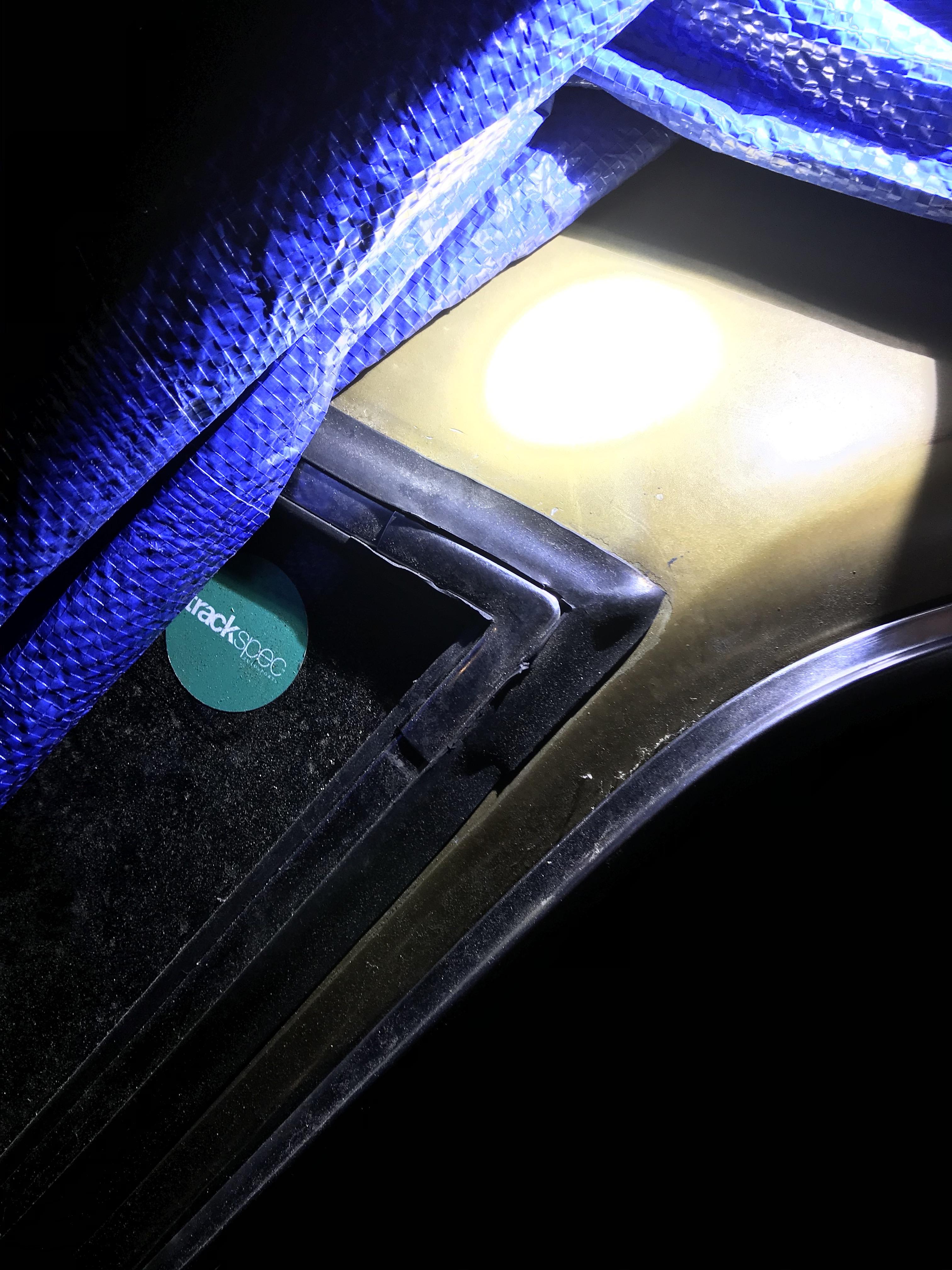

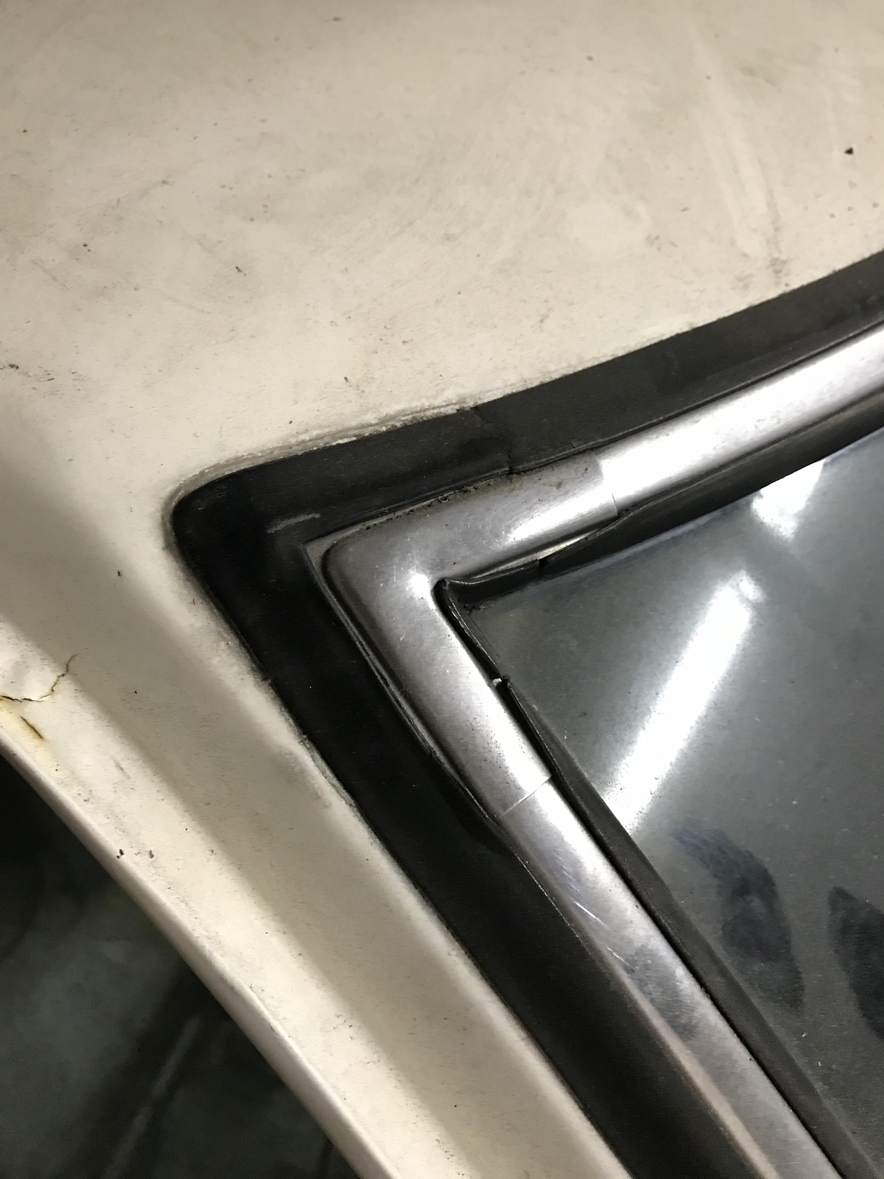

from what i can see with the installed windshield there is a slight visual size difference between both gaskets, i notice it the precision gasket when i installed it, there are sections where the oxidized paint shows through. With that being said my whole car needs a respray. ?
The white one is OEM, the brown one is a precision gasket.
In the end i could not justify the price for OEM, for me the old gasket was leaking water into the cabin and ruining metal work I did. At the time I was a broke college student, now Im a broke public employee ?
