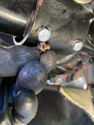

Well I decided to take off the entire steering and suspension at the front and discovered some chocolate bolts ...

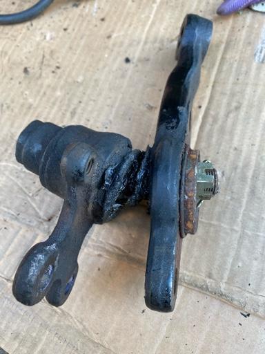

While taking the whole thing apart, I discovered totally ruined and seized ball joints - one of which I cannot move with my bare hands or without tools.

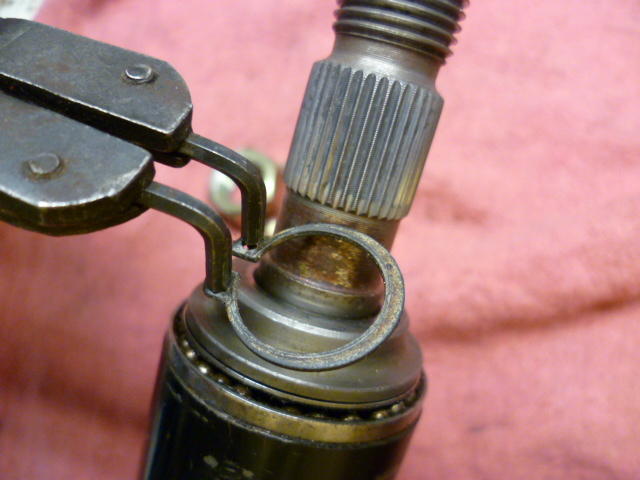

I tried taking off the snap ring / clip thing but it broke. I suspect I need to compress the shaft before it lets go.
For now I have my hands very full with mushy fuel line replacement, suspension bits, front bearings, removing surface rust / curing / painting and a plethora of other small but necessary jobs.
I found it easy to remove the clip, but yes... You should unload it first. Doesn't take a lot of force.
(Alone) I found the easiest way was to place the column against the ground and grab the column housing (outside) with one hand and press down against the ground, thereby compressing the spring a little. Been a while since I've been in there, but I probably braced the whole thing against a hip or something? Anyway, at that point you can remove the clip as soon as it's unloaded. Of course, if you have a helper with a second pair of hands, it's even easier.

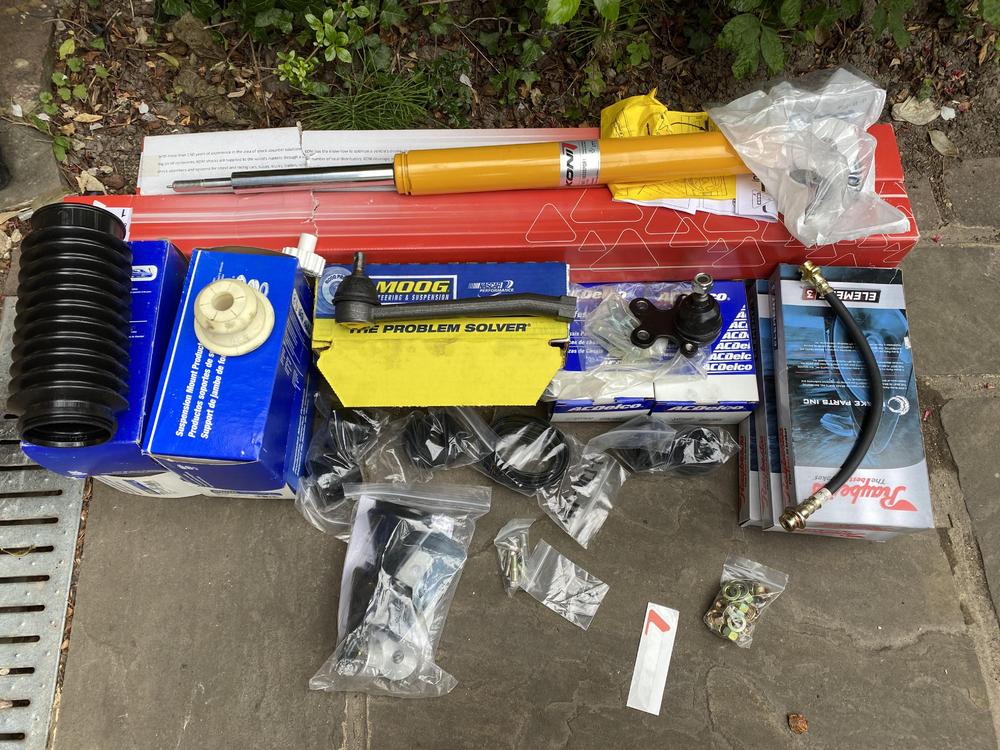

So chaps and chapesses. What started as a small investigation, rapidly descended into taking the entire front end off and starting again with new parts or reconditioning.
Suffice it to say that I’ve been propping up the US economy through RockAuto and MSA purchases.

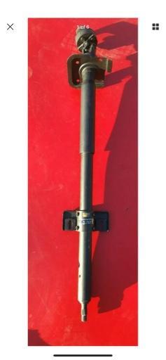

I have also purchased what appears to be a totally unused - get this - “RHD” steering column from the US, advertised incorrectly as a 280zx column.
5c519d64cabed5ec6fdc4f9fcdfc1025.jpg&key=39211bd7e5f0a888d4903e978e797e66b110ca66bfbd7626b11d2b2fff2fc81a
It’s being sent on the backs of USPS snails - bought end of May, due 17th July!!!! And $70 for the privilege!!! I fear i’ve been had on postage but got a great deal on the column. Next, I will be robbed by the UK revenue services who add 30% to everything including the postage - oh and a £12 processing fee just to kick you again in the nuts!

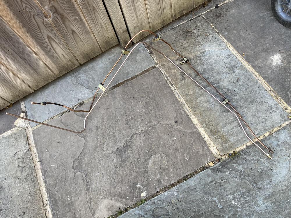

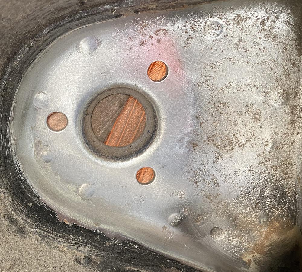

Found some absolute horrors like wrong grade bolts in the suspension, wrong way up bolts, totally busted brake lines (which explains why they went spongy) made of pure copper, split soft brake pipes dating back to 2003, COMPLETELY seized ball joints, split steering rack gaiters and a failed Tokico blue strut (so far) at the front but we are very slowly getting there. Incidentally that strut was put in new by the PO who did 800 miles and the car has done under 10k in my ownership - so something was definitely wrong there.

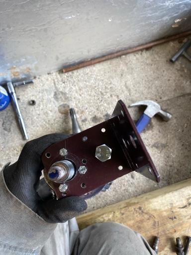

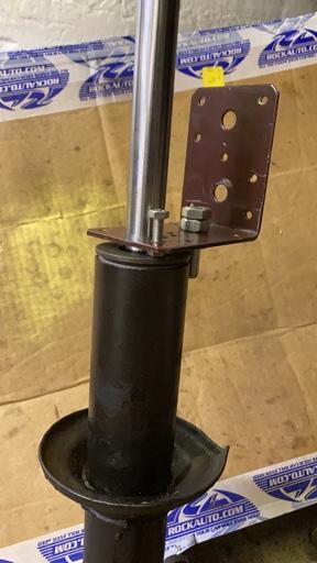

I made my own gland nut removal tool out of an old bracket that worked a treat for getting the old ones off and getting the Konis tightened up.

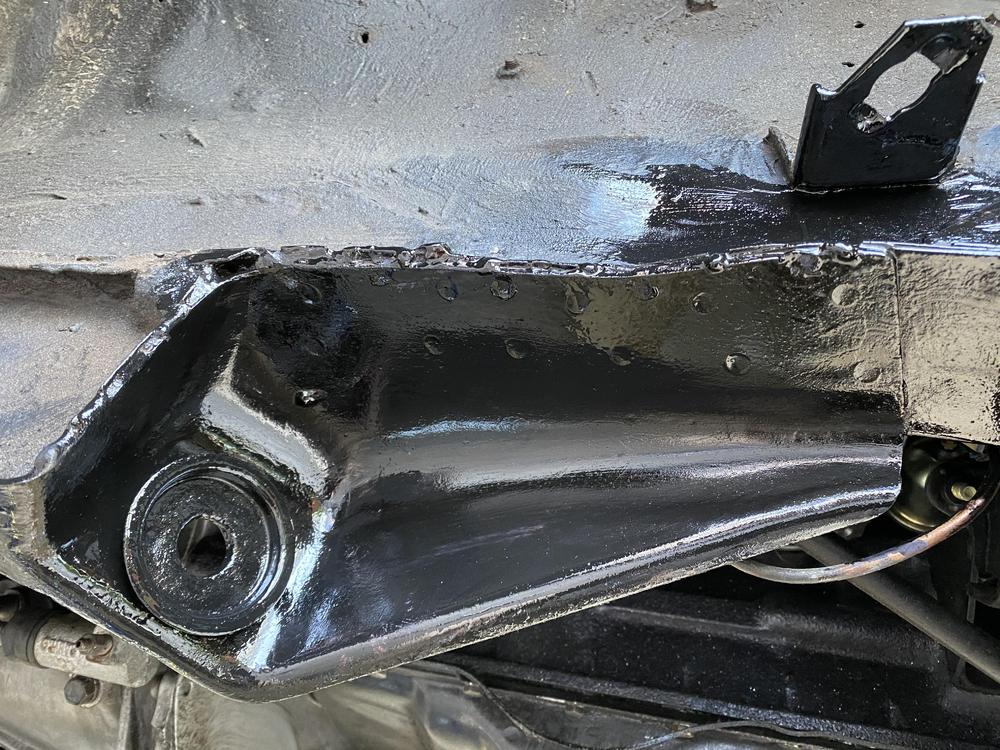

Exorcised a tonne of surface rust and coated with POR15 nasty but magic potion!!

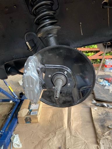

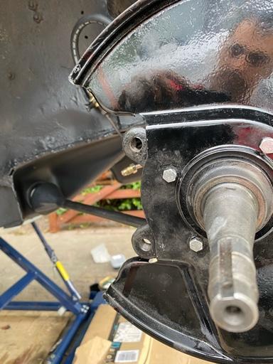

Threw in some Koyo front bearings while I had the hubs off anyway and installed virtually new brake splash guards but sadly had to cut them to fit my Toyota callipers.

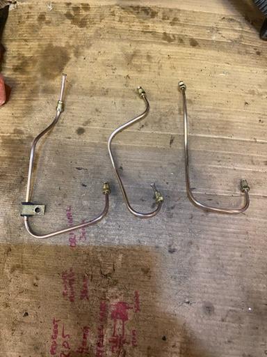

Oh and I remade all the front brake lines using cupronickel ...

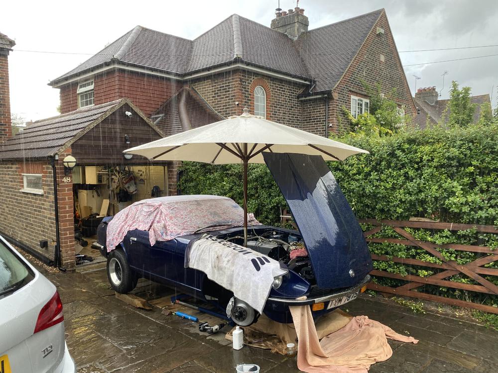

The weather was lashing it down today but I feel I prevailed and remained dry during the monsoon that ensued!!
