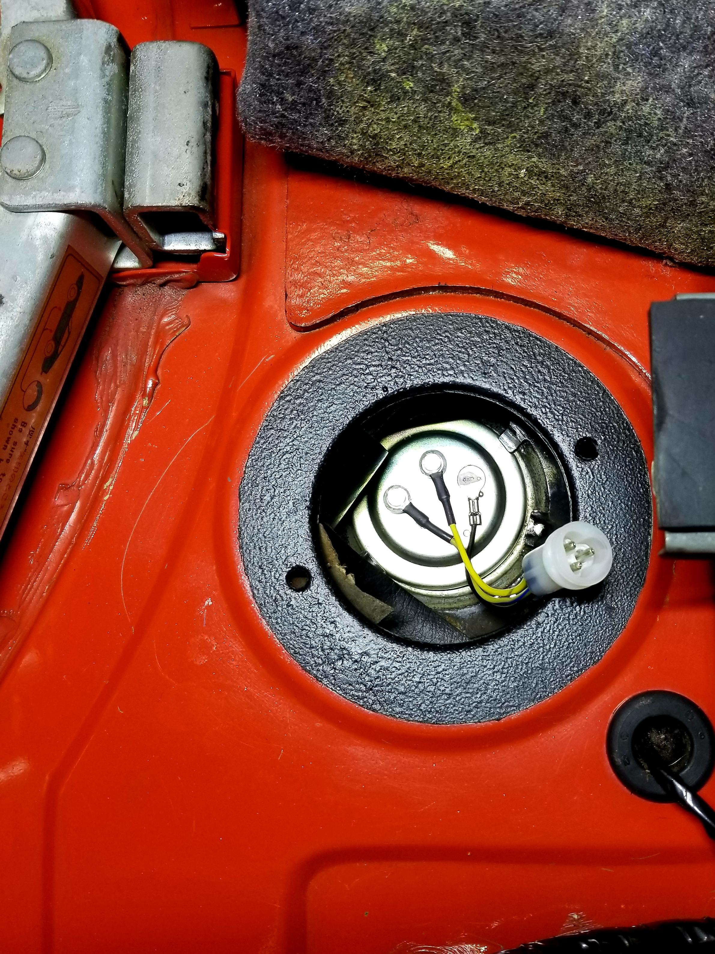

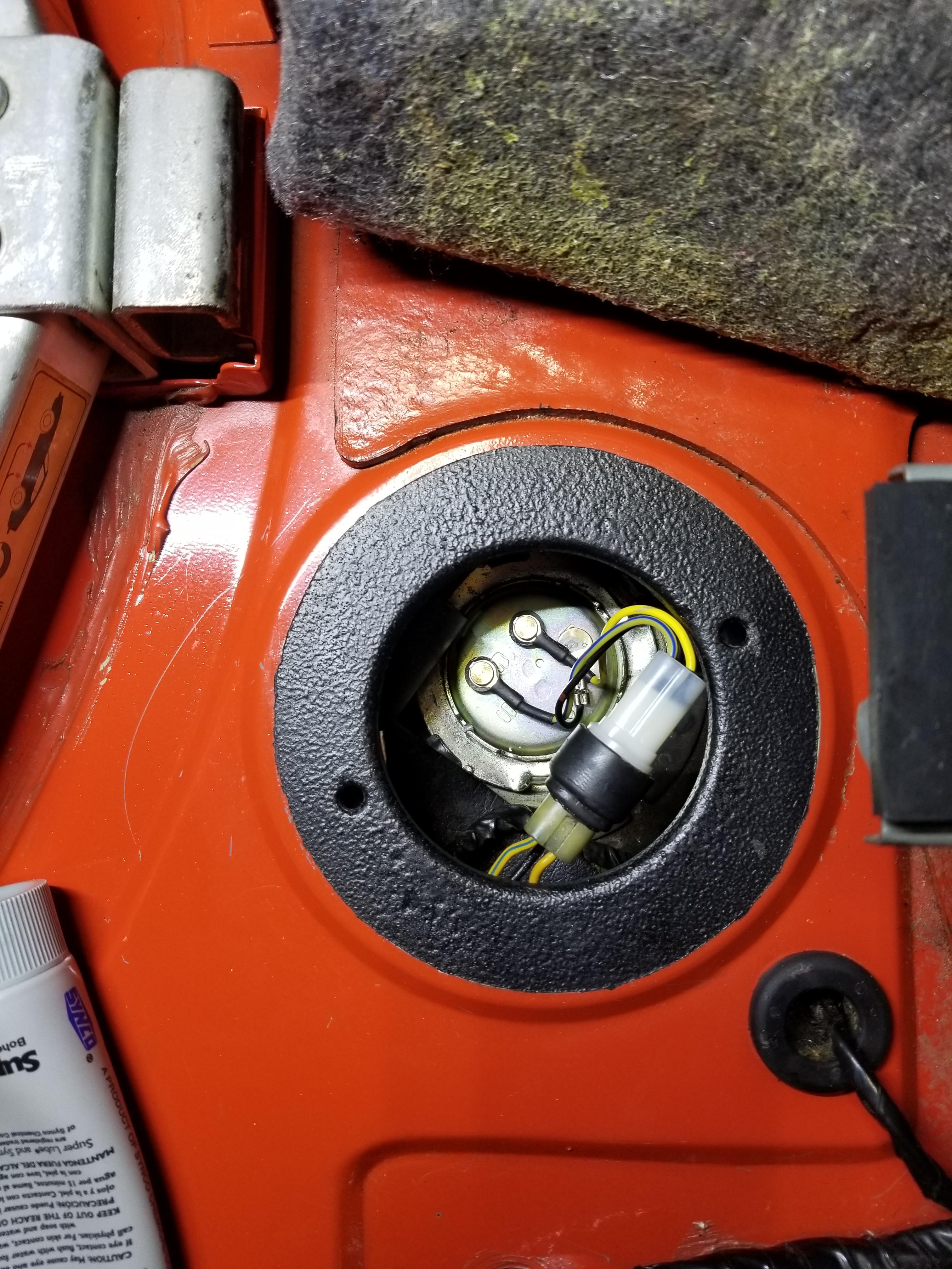

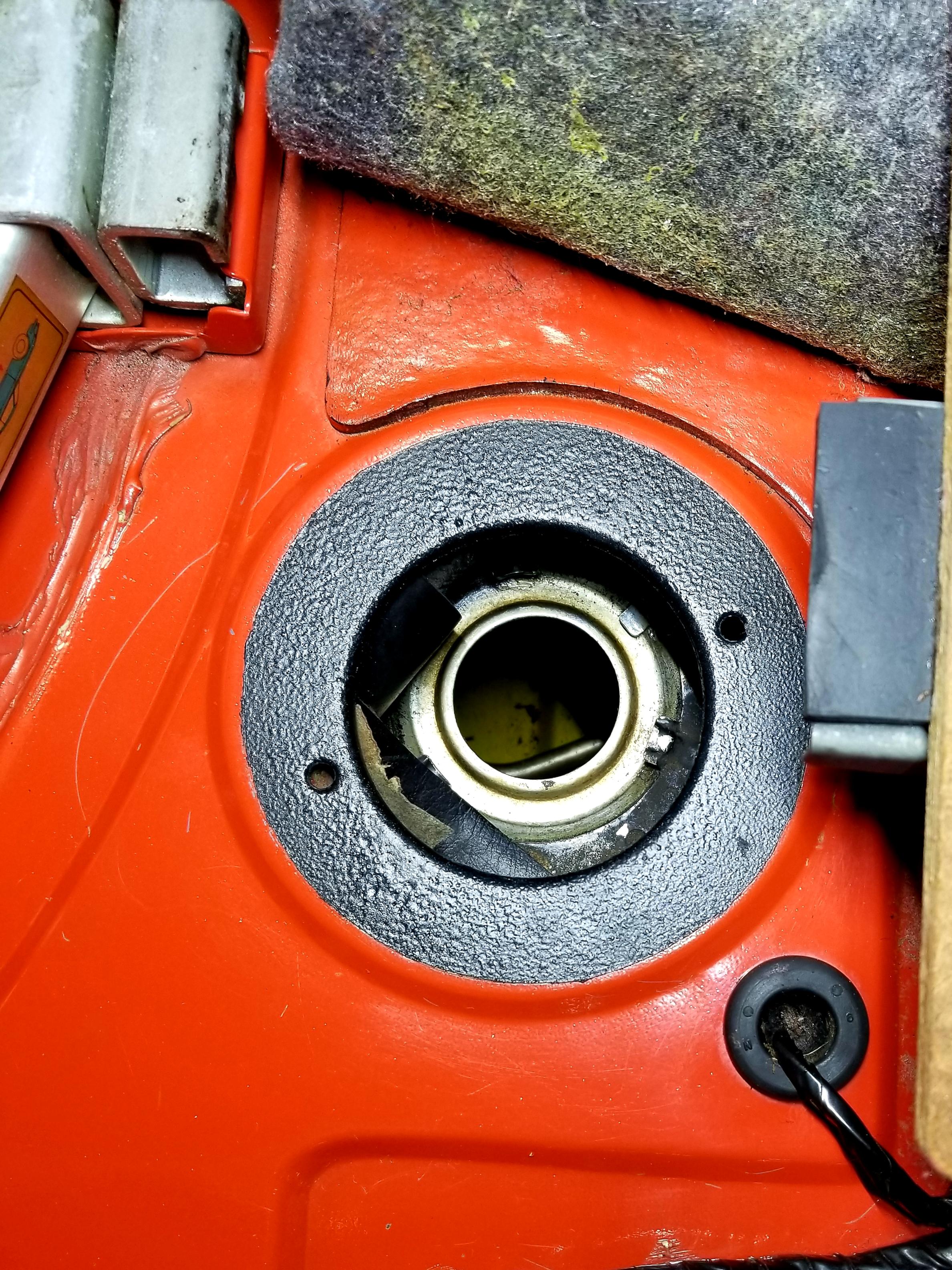

... and the new fuel sending unit from Zcar Depot arrived this afternoon and it's installed and working!!

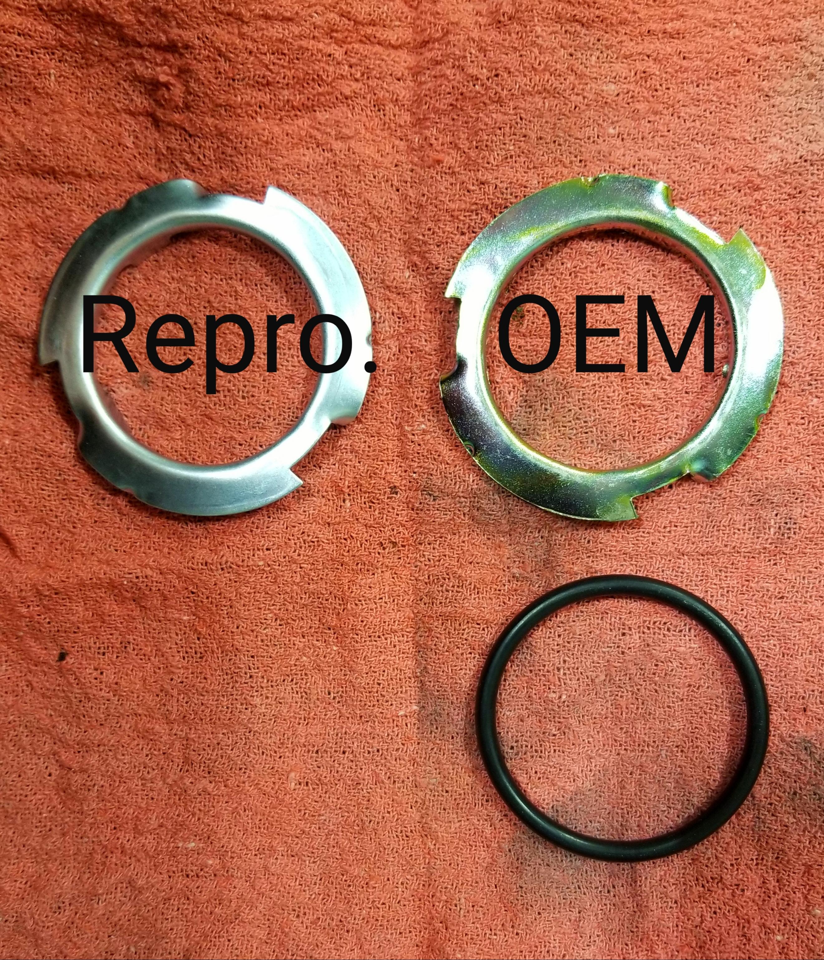

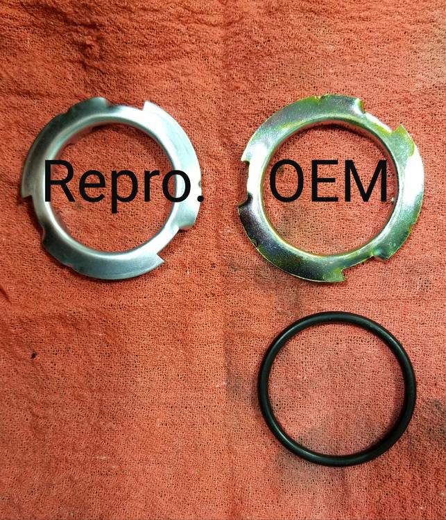

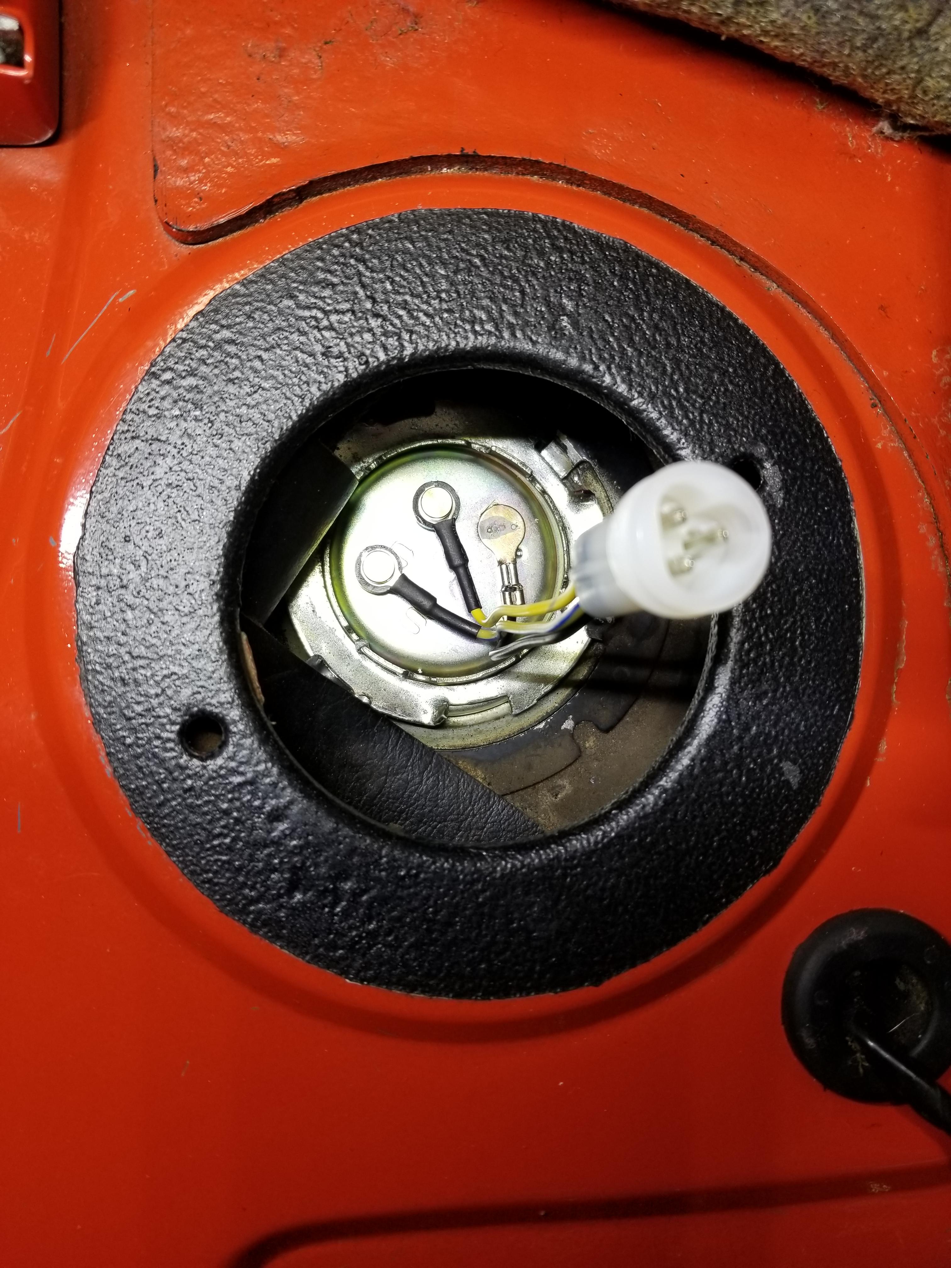

Because the reserve fuel light had stopped working on my original unit I will confess that last week I had tried installing a fuel sender I purchased from MSA last September when they just got them for the '77-'78 280Zs but one of the contact rivets snapped off when I slid the connector onto it. Very bad quality! Not only do the MSA units come with different type connectors that you have to splice in after cutting the stock connector from the sender, the quality of the riveted contacts on my unit was much less than adequate and failed miserably. Fortunately it happened before the final stage of installation and not after everything was closed up again. Additionally the unit is more than twice the cost of the @zcardepot.com unit I just received which plugged right in and is working flawlessly. I spoke to James at MSA who's always very helpful and he said he would talk to their manufacturer about the problem but electrical parts cannot be returned, much less after 30 days. He will get back to me on it but I might be looking at a total waste of $200! If they at least repair it I will keep it as a spare or pass it on to a fellow forum member in need.

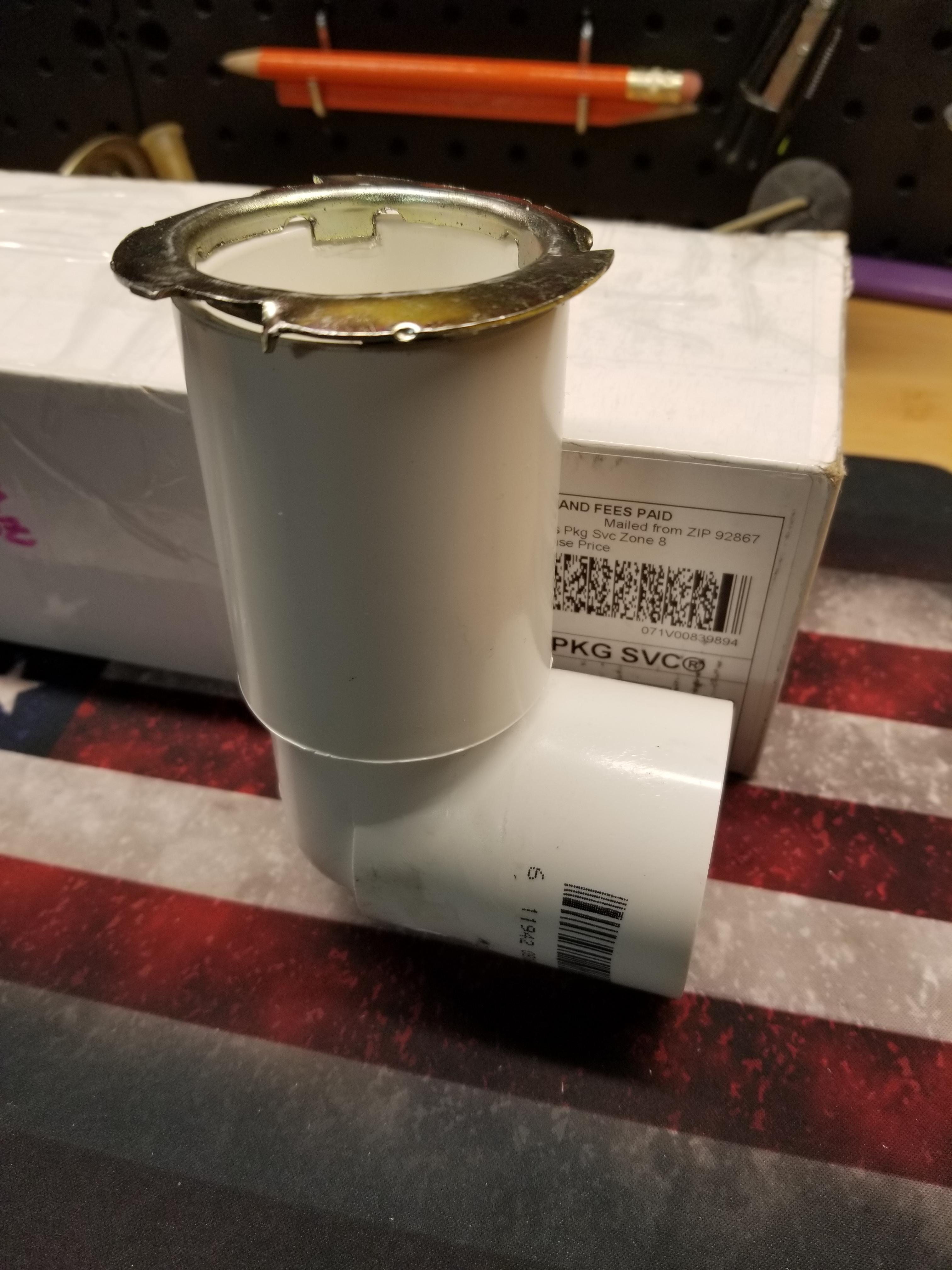

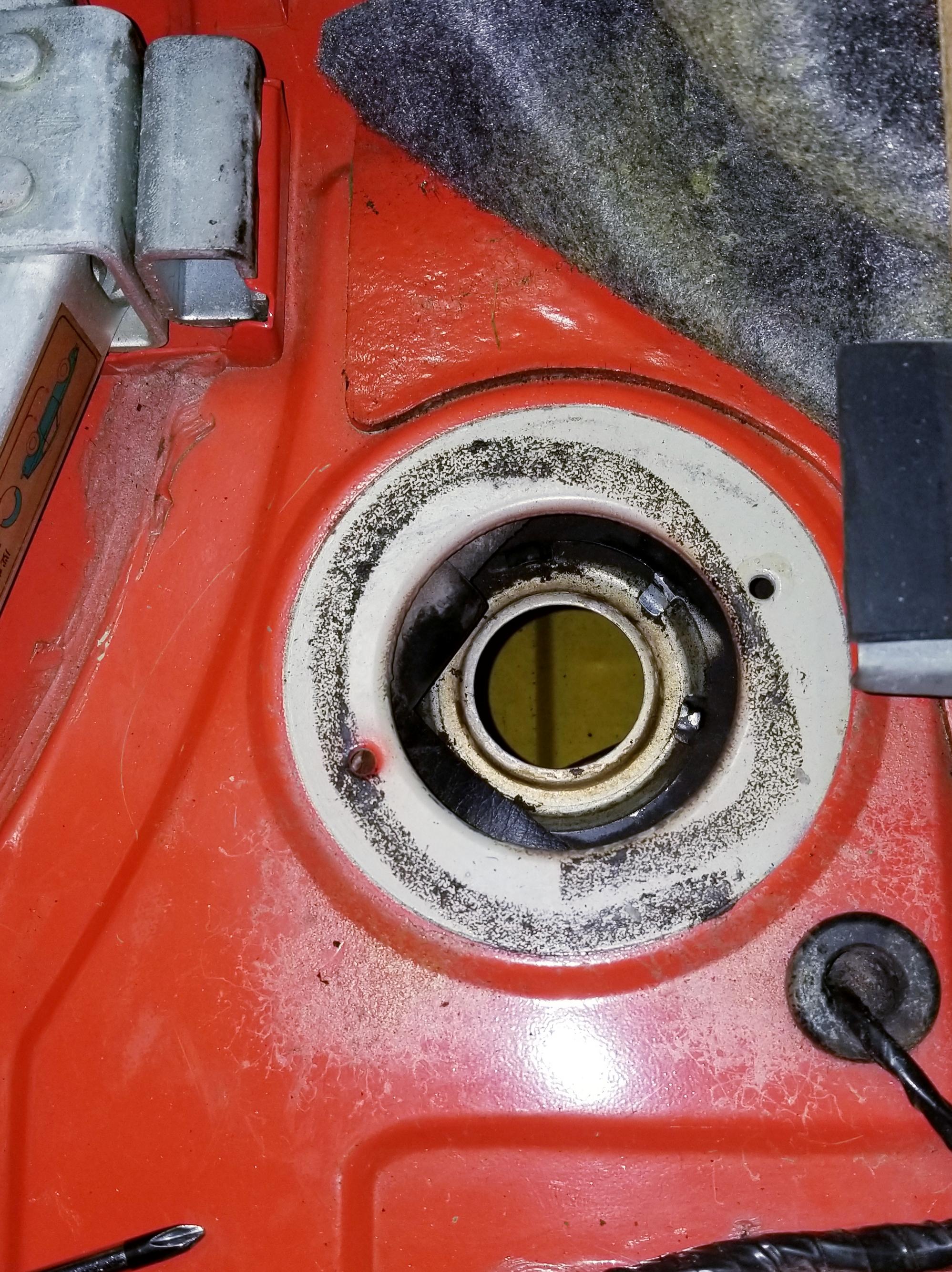

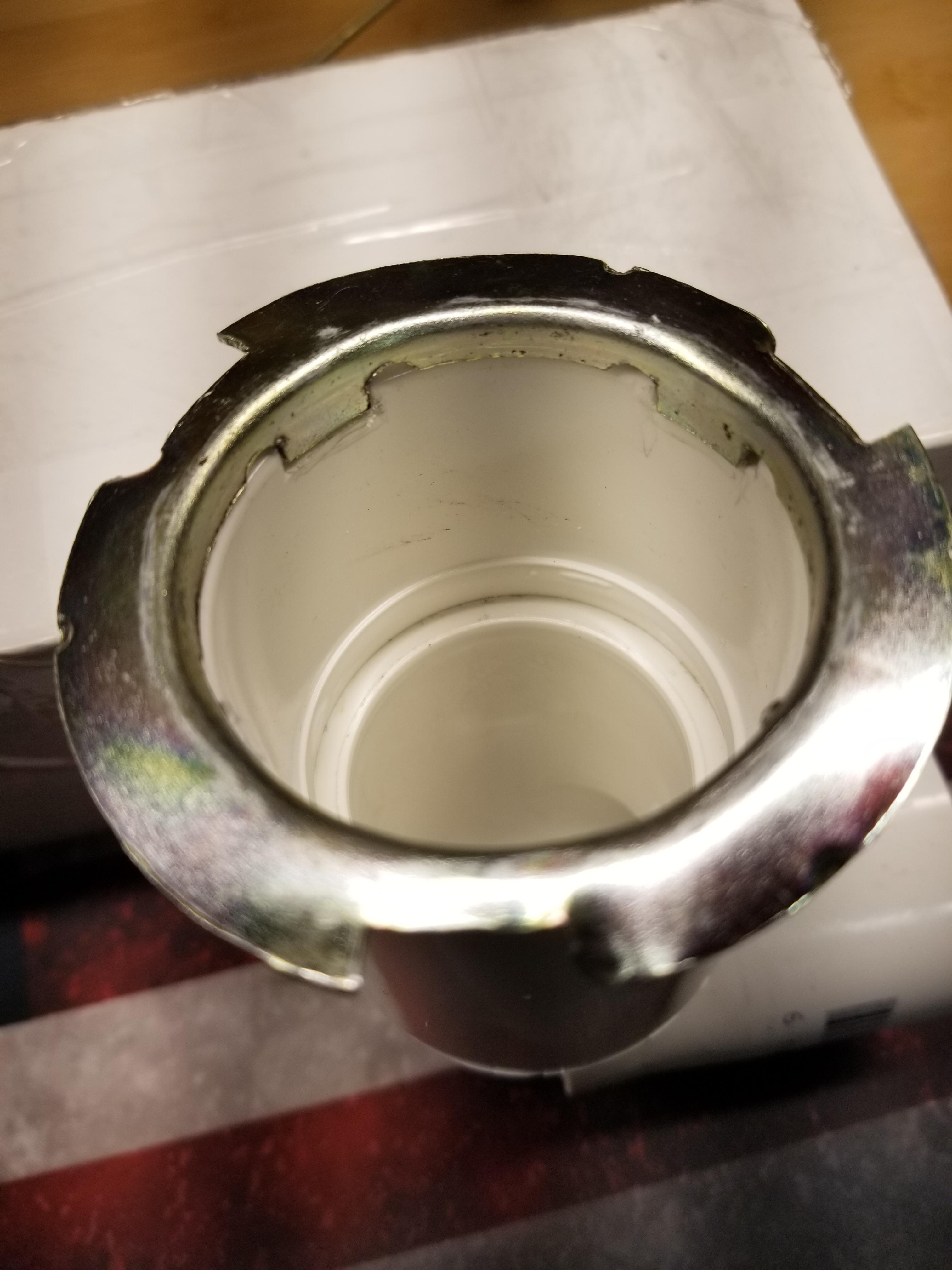

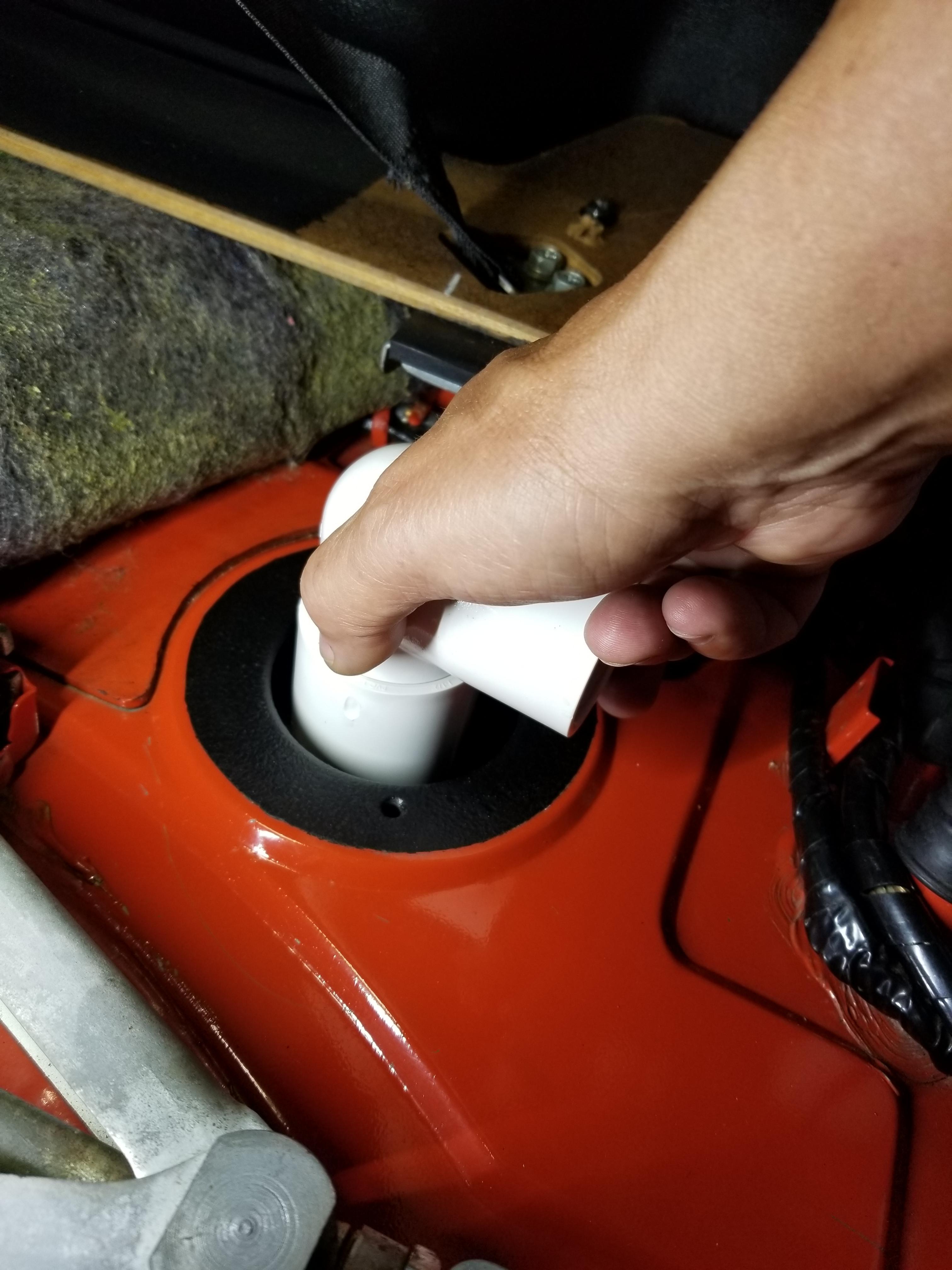

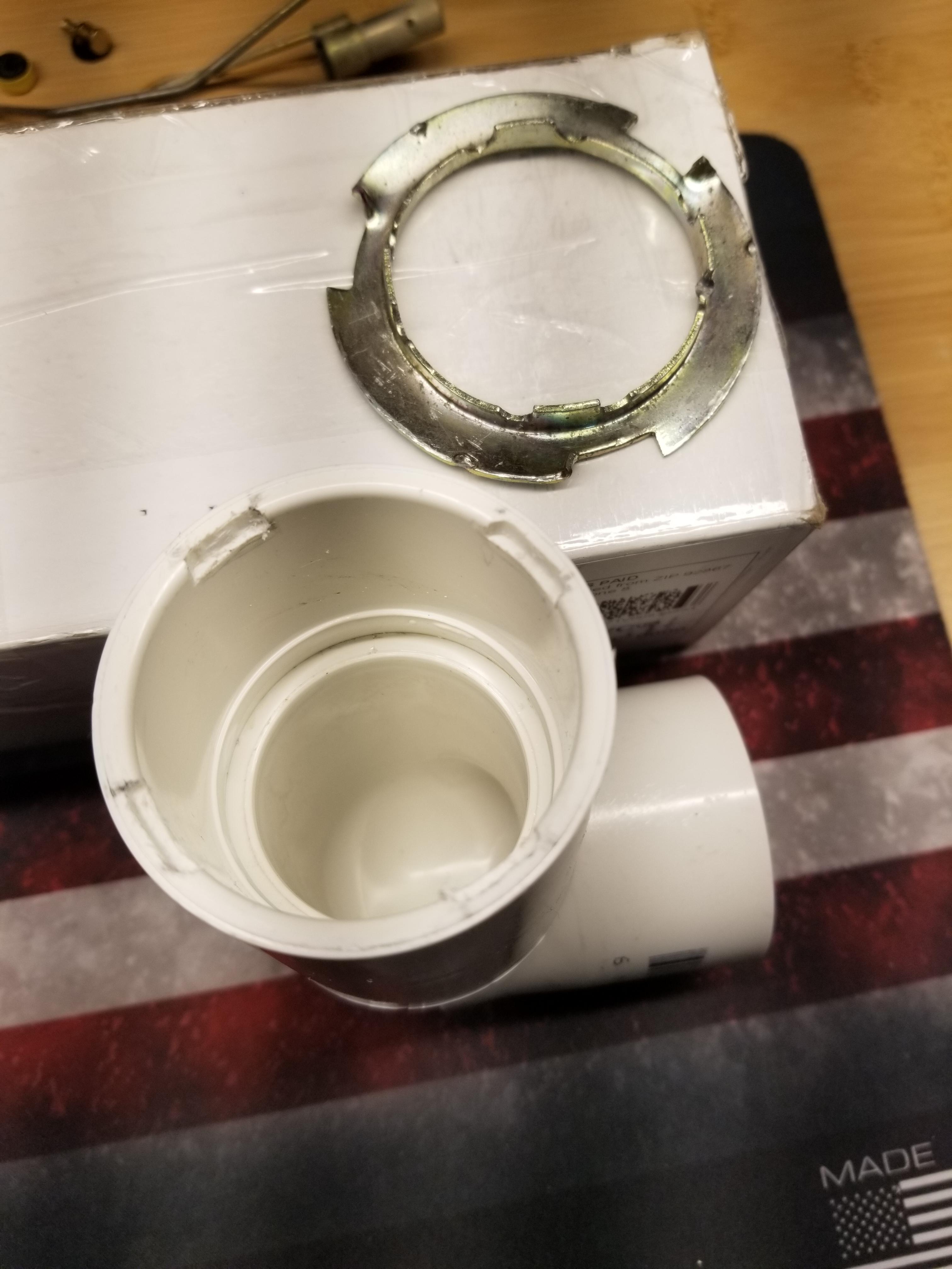

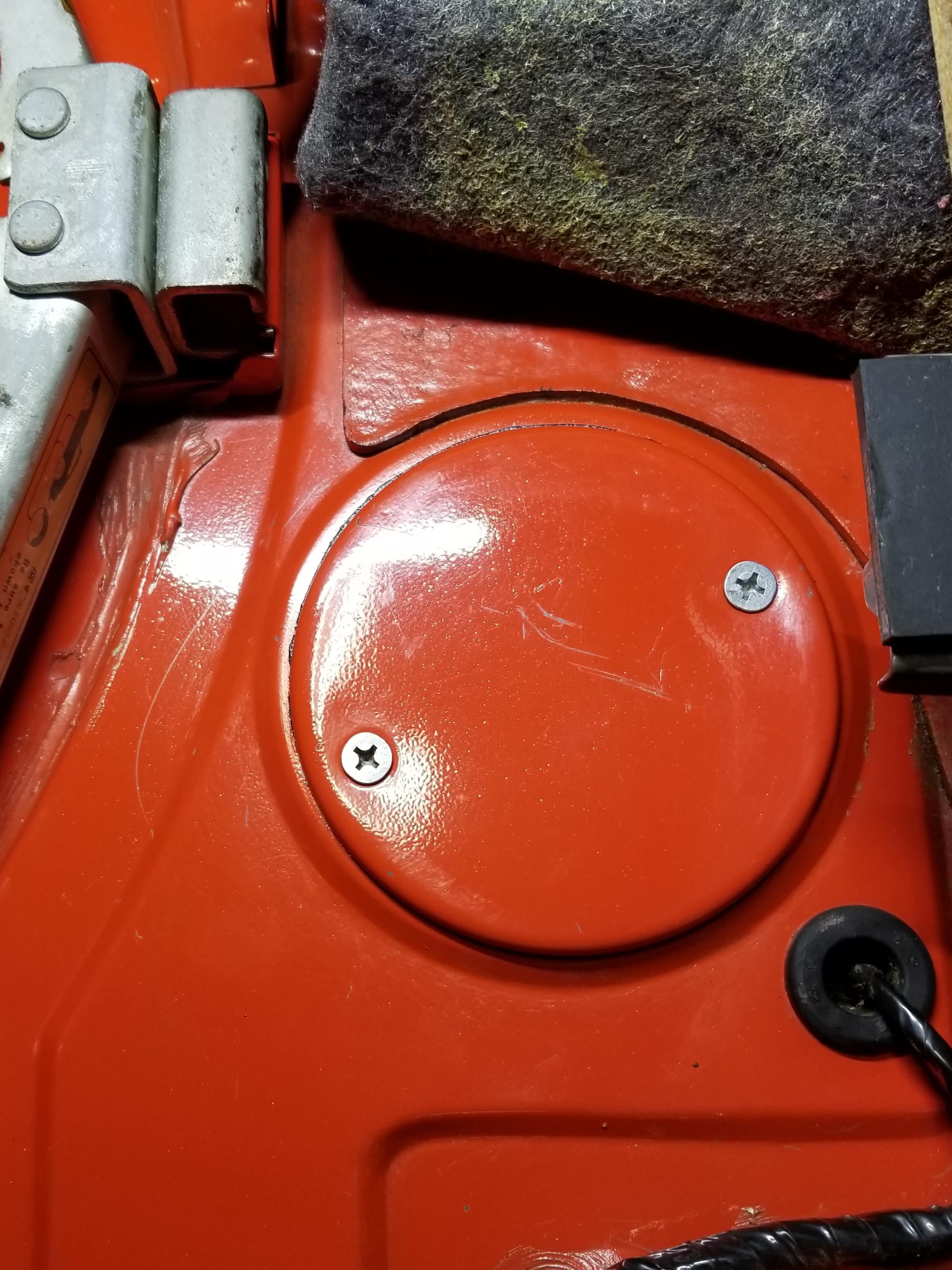

Anyways...I designed a "wrench" out of 2" PVC pipe that enabled me to very easily re-install the lock ring over the sender and that makes the job a piece of cake. By using my Dremel, I made 4 slots on the inside edge of a 6" straight piece of PVC so that the 4 crests that jut out of the lock ring would fit into those slots. A 90 degree elbow at the other end of the straight piece of pipe provides easy rotation of the lock ring in either direction. I used my original lock ring since it was in great shape and lightly sanded and coated with anticorrosive bed liner paint the area around the access port. Pics attached.

Fuel sender is in I used a very long skinny screw driver to tap out the lock ring and to tap it back in.
