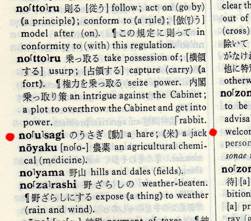

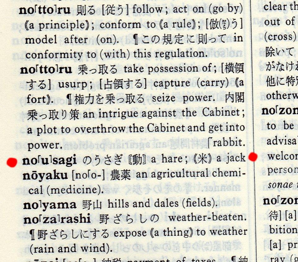

Here's a classic case of copying the mistakes of others. The Japanese word for the common Hare is 'Nousagi' (literally, 'Field Rabbit').

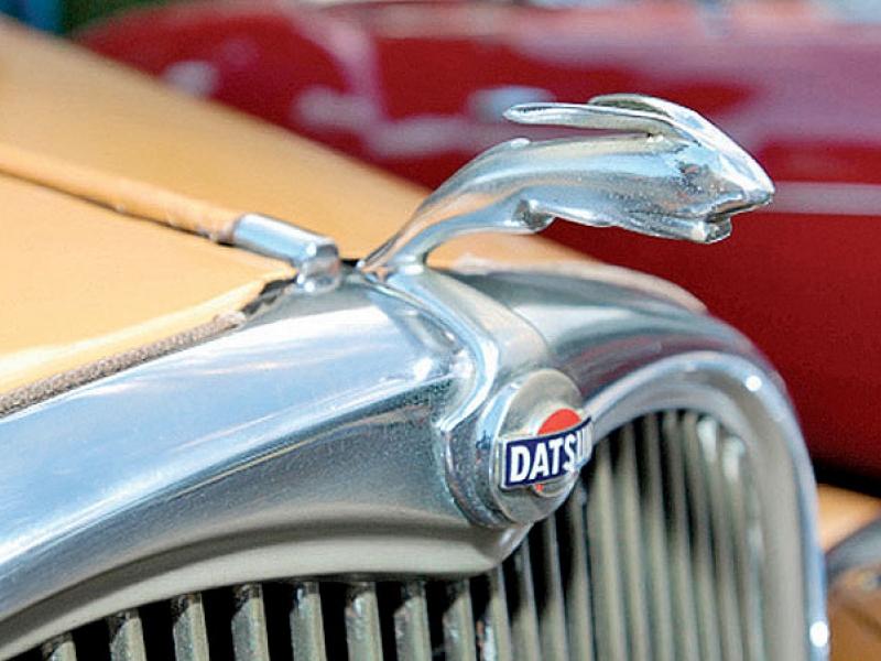

The running hare emblem on some of the early Datsun products:

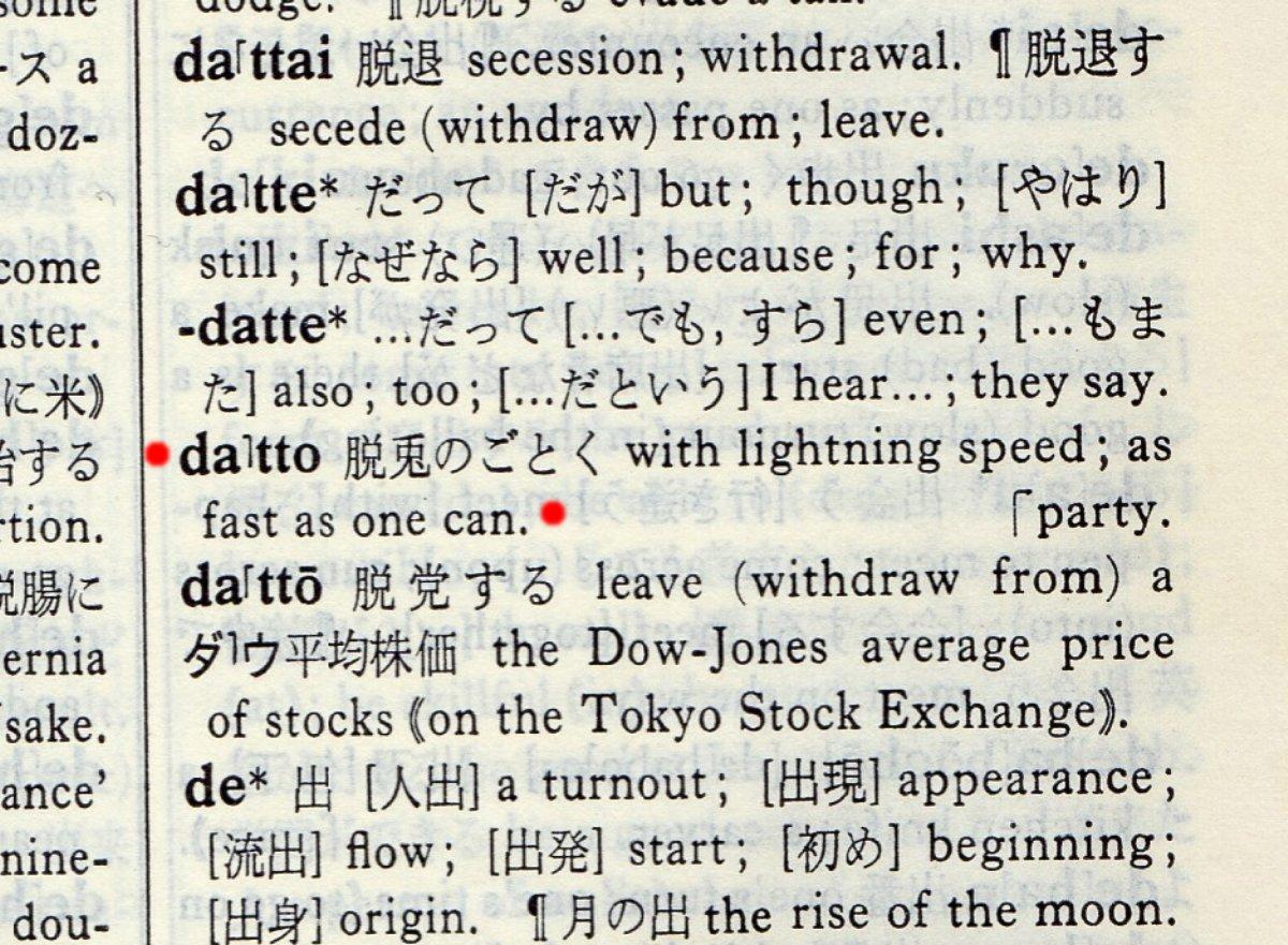

This is not 'a Dat'. In Japanese, the word which can be Romanised as 'Dat' (phonetically 'Da-tto') is a verb. Here's the Japanese dictionary again:
...so the emblem uses the wild Hare as a symbol of speed and agility (whilst still being fairly modest) and it is not 'a Dat'.
I would argue, in reference to the symbolism of the hood ornament, that "datto" is a prefix.  What we really should say about the hood ornament and the DAT / hare correlation includes the prevailing philosophy of design (in Japan) at the time.  The image of a leaping hare expresses datto - or DAT; lightning speed.  DAT / Datsun really means "lightning speed".  This is classic Japanese Art Deco.  The expression is obvious and I can see with a stretch how the DAT / hare connection could be made, by someone who doesn't understand art, perhaps an American (sarcasm intended).  The ornamental animal is posed in a way to express motion, or in this case, lightning speed, quick response, and as fast as...  It is expressed from a hare which conjures the thought of quick response or lightning speed because those are the outstanding qualities of a hare.  It is not a literal translation to "rabbit"!
Splitting Hares, 26th-Z...?  ?
It's all very well for us to wax lyrical about the symbolism of motoring ornaments - and it's a good thing - but that beautifully realised Deco figure on the top of the Datsun radiator is not a 'Dat', and 'Dat' is not Japanese for 'Hare'.

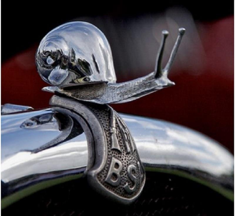

Happy 4th July, by the way. Here's an English hood ornament on the day we celebrate having got rid of the troublemakers:
