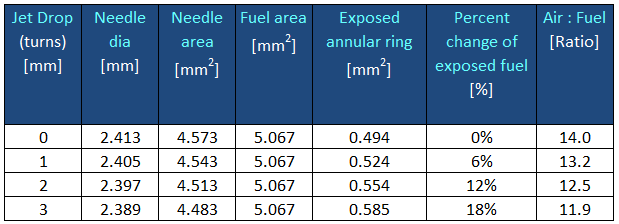

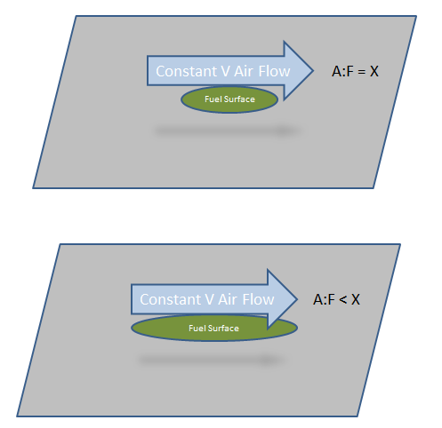

Here is a quick calculation based on the following general assumptions:
  • Air Flow over a puddle of fuel draws fuel into the air flow
  • The larger the puddle, the more fuel is drawn
  • The air does not saturate with fuel
  • Air flow is constant
  • Depression over exposed fuel  is constant
and here are the SU assumptions:
  • venturi effect of bridge is ignored
  • effect of piston raising is ignored
  • air flow is constant over exposed fuel puddle
  • fuel depth in well is ignored
  • exposed fuel puddle is proportionate to diameter of fuel well (2.54mm)  minus the area blocked by the needle's diameter at the surface.
  • Station one Top needle dia is 0.095"
  • Station one Bottom needle dia is 0.094"
Here are A:F Ratio calculations for lowering a jet for an SU carb with:
  • Top of station (Jet drop = 0) AF is 14 with N27 needle dia of 0.095" reducing to 0.094" at bottom of station.
The math seems to match observations ?

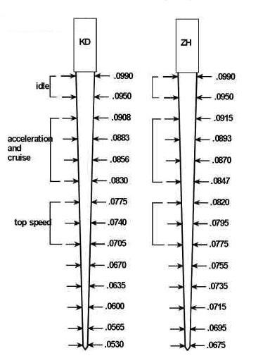

Interesting. Perhaps the root misconception is that the needle is actually more of a continuously tapered shape, it is NOT a series of 1/8” Long tubular sections. Thus you ARE changing the Needle OD continuously as you raise and lower it by small amounts.
Even though I can find drawings with both concepts, the first one here is more the correct representation of the actual shape
More like this;
Not like this:
Right. The slope of the taper (rate of change) may be different across the stations, but it's always a "slope" and not a step.
