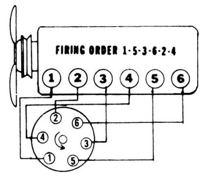

28 minutes ago, grannyknot said:
Yes, and the firing order for L series engines as far as I know.
The number #1 position is set how? Is this the position with distributor fully advance? I think not just asking.
