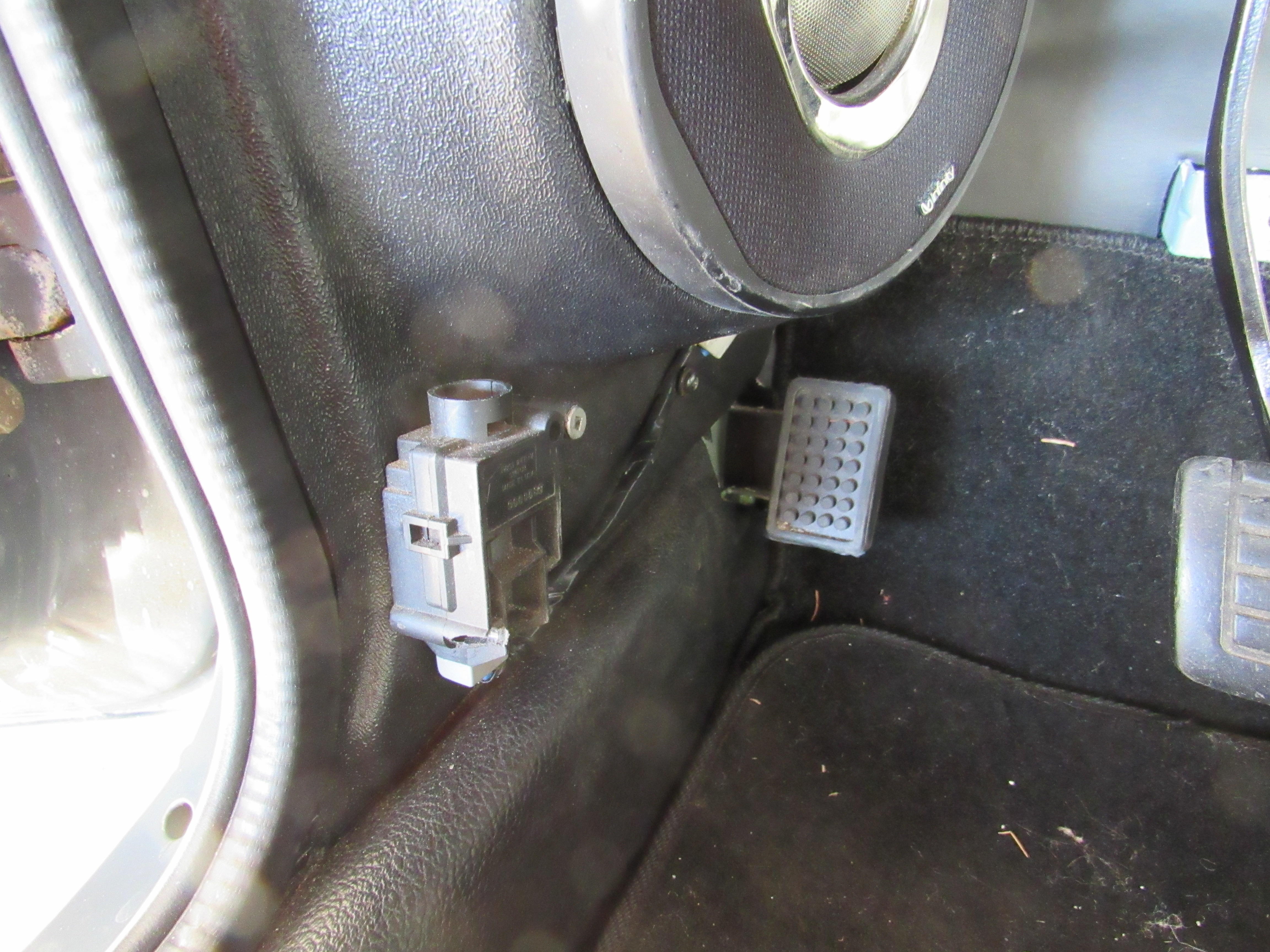

I put mine down on the driver footwell, this one is the Ford switch, it doesn't trip unless there is a major upset.  I have only triggered it once going over some train tracks driving way too fast.
Is that a reset button on top?
Looks like the one on my Mom's Grand Marquis, red button on top. Her car wouldn't crank one night so she just left it and called a friend for a ride home THEN called me. I go and push the button, cranked the car and slammed the trunk so hard it tripped it again. I was a little mad. :wub:
To add my experience with her Ford's button, when it's tripps you can see the red button up top flush with the metal body. When it's working it stays down. I'm sure it's a good, plentiful from a junkyard, switch especially if Grannyknot has one.
