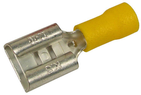

June 30, 20204 yr comment_601968 Correct me please but I'm almost positive if you touch the two sender wires together the gauge will peg on FULL. (Could be EMPTY)???? Its been a few years. Those nail head connectors are a PITA. I put female spade connectors on mine and covered them with liquid electrical tape. Link to comment https://www.classiczcars.com/forums/topic/64203-new-z-owner/#findComment-601968 Share on other sites More sharing options...
