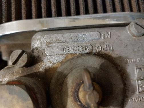

July 6, 20204 yr Author comment_602185 Yes, it helps if the No. are similar as they would be manufactured in the same runs to ensure the same internal config/machining. They are each a No 3G (?), Type 8 (Maserati 3500 GT). 2 progression holes. No visible makings on the chokes to denote size. Sent from my SM-G950W using Tapatalk Link to comment https://www.classiczcars.com/forums/topic/64214-whats-your-experience-with-textbook-settings-for-webers/#findComment-602185 Share on other sites More sharing options...
