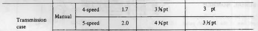

July 7, 20204 yr comment_602294 5 hours ago, chaseincats said: ok, I'll grab that. 2 quarts should fill a '78, right? Yes, if it is a 4 speed. A 5 speed takes slightly more. The Redline gear oil is very good, I have used it, however many of us have switched to AC Delco Friction Modified with great success. Something to consider ... Link to comment https://www.classiczcars.com/forums/topic/64232-transmission-fluid-weight/#findComment-602294 Share on other sites More sharing options...
July 7, 20204 yr comment_602296 15 minutes ago, S30Driver said: Yes, if it is a 4 speed. A 5 speed takes slightly more. Funny, I never really realized this. The 1978 FSM has both, for reference. I wonder where the extra capacity is. Bigger rear case? Or did they just move the fill hole up to keep the new gears covered. Edited July 7, 20204 yr by Zed Head Link to comment https://www.classiczcars.com/forums/topic/64232-transmission-fluid-weight/#findComment-602296 Share on other sites More sharing options...
July 8, 20204 yr Author comment_602297 59 minutes ago, Zed Head said: Funny, I never really realized this. The 1978 FSM has both, for reference. I wonder where the extra capacity is. Bigger rear case? Or did they just move the fill hole up to keep the new gears covered. wow ya that is interesting weird Link to comment https://www.classiczcars.com/forums/topic/64232-transmission-fluid-weight/#findComment-602297 Share on other sites More sharing options...
