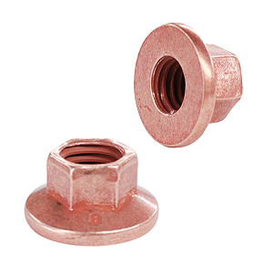

July 11, 20204 yr comment_602432 On 7/9/2020 at 1:11 AM, conedodger said: Steve, I have a new set of OEM studs in the E31 head. Help me though, ZCD? Z car depot is correct . So you have the studs and you just need nuts . I like the copper ones ZCD sells . Or some good ole nut and washers Link to comment https://www.classiczcars.com/forums/topic/64237-fasteners-for-l30-intakeexhaust/#findComment-602432 Share on other sites More sharing options...

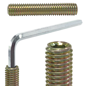

July 11, 20204 yr comment_602472 https://www.belmetric.com/hex-with-flange-c-3_51_53/ncf8x10w-copper-flange-nut-wide-flange-p-10435.html?zenid=sahrhmsei24sc6bg2gtlshqhn1 And these babies have 10mm heads! For those tight places around headers and such or at the very least https://www.belmetric.com/jis-small-wrench-c-3_58_2280/nj8x12ylw-jis-nut-yellow-zinc-p-205.html?zenid=sahrhmsei24sc6bg2gtlshqhn1 I also like these studs they have. Easy to insert and remove. https://www.belmetric.com/m8x125-coarse-thread-c-9_71_1840/s8x45fylw-allen-drive-stud-yellow-zinc-p-15201.html?zenid=sahrhmsei24sc6bg2gtlshqhn1 Edited July 11, 20204 yr by zKars Link to comment https://www.classiczcars.com/forums/topic/64237-fasteners-for-l30-intakeexhaust/#findComment-602472 Share on other sites More sharing options...
July 12, 20204 yr comment_602483 Do you not need to run lock washers with those copper nuts? Link to comment https://www.classiczcars.com/forums/topic/64237-fasteners-for-l30-intakeexhaust/#findComment-602483 Share on other sites More sharing options...
July 12, 20204 yr comment_602489 22 minutes ago, heyitsrama said: Do you not need to run lock washers with those copper nuts? No, they are deformed so that installation causes them to lock on like a stover nut. Adding a lock washer would not be harmful if you would like but it would defeat the purpose of that nice large flange I think. Edited July 12, 20204 yr by zKars Link to comment https://www.classiczcars.com/forums/topic/64237-fasteners-for-l30-intakeexhaust/#findComment-602489 Share on other sites More sharing options...
