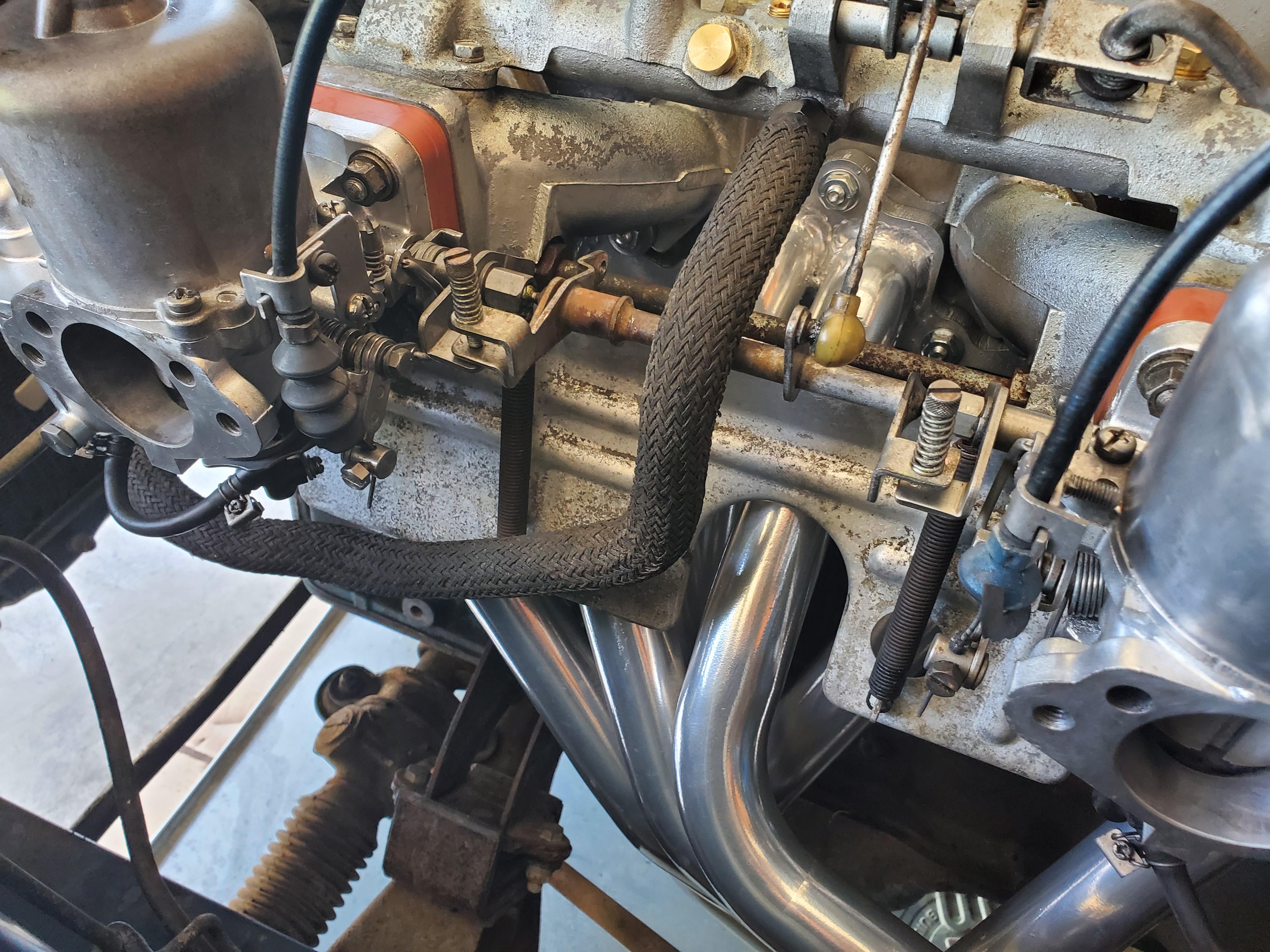

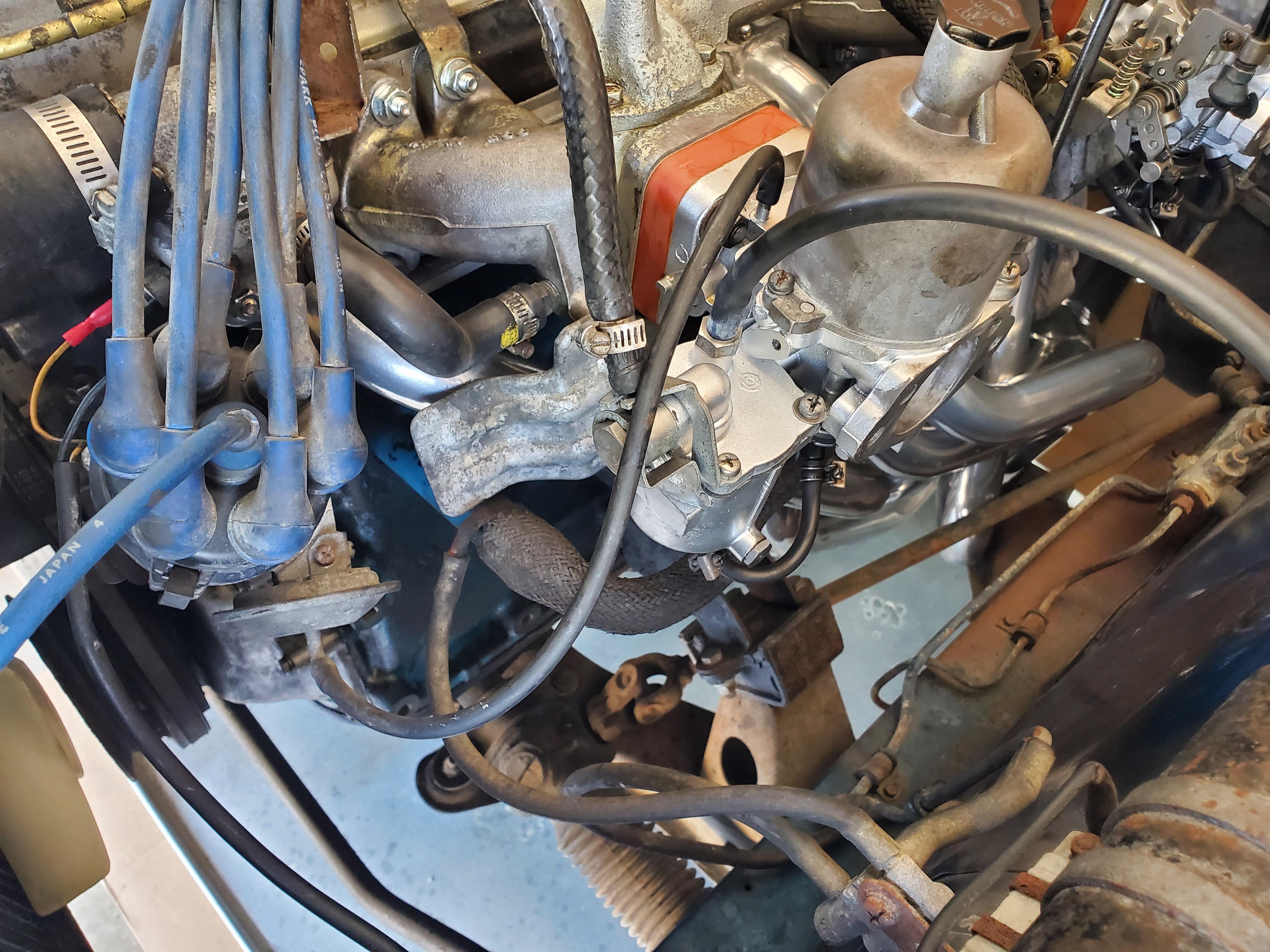

This is another one of those "i purchased "rebuilt" carbs, instead of rebuilding them myself" threads.   I've been sitting on some rebuilt carbs (purchased online), MSA 6-1 Header, and MSA exhaust for almost a year now... Finally had the opportunity to install them this past weekend.  I ended up pulling the ARA AC unit out as well.
Before I end up pulling the front carb completely, just wanted to hear more opinions.
Installed all the parts mentioned above and cleaned up anything I could as I went.  Also threw in some BSPT 1/2" and 1/4" plugs in the balance tube.  New blocks/gaskets for the carbs as well.

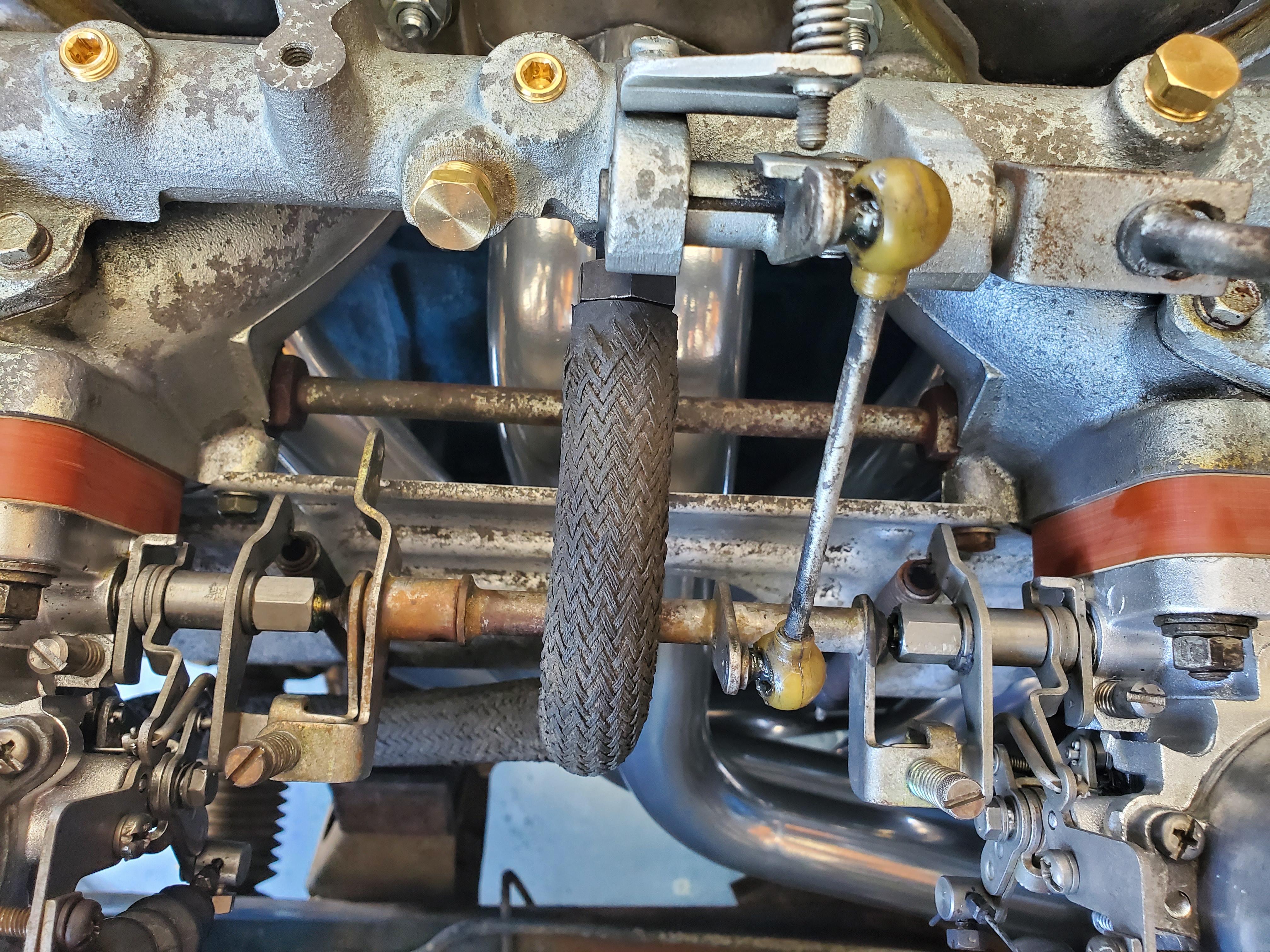

Car fires  up cold with the choke.  Then after its @ operating temp, it'll start right up each time.  Idle is about 1500ish.  I started out originally with the jets turned all the way up and then down 2 full turns and the throttle adjustment nuts all the way in and then back out 2 turns. No matter what i did with the front carb, i could only get it to increase air flow, never reduce.  The synchrometer i'm using shows 7 kg/h on the rear carb and 20-30 kg/h on the front carb.

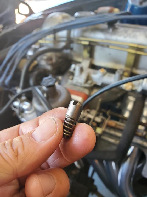

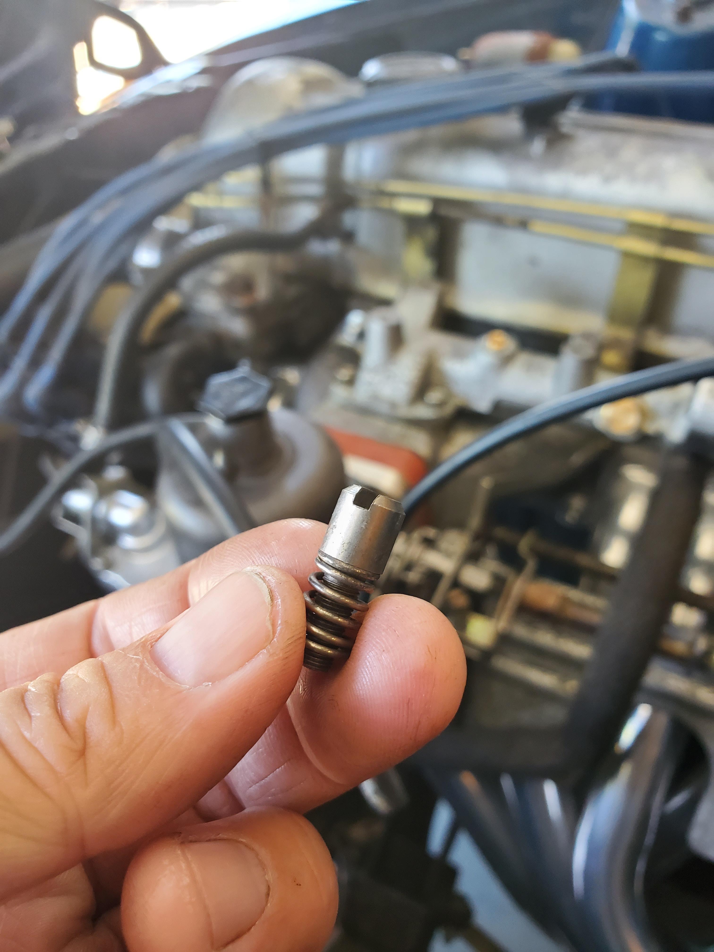

Fast idle screw is all the way back out, and I pulled the throttle adjustment screw out of the front carb completely just for the hell of it (thinking that maybe the butterfly wasnt closing completely).  I took some time last night to search on the forums and google for anything.  Everything pointed to maybe a vacuum leak somewhere.  So today, i went and checked all the vacuum lines and plugs.  I sprayed a little carb cleaner in various areas (balance tube gaskets and blocks, intake manifold where it meets the head, line that goes to the brake booster, carb blocks/gasket area etc) and never got the rpms to increase.
Also pulled the dashpots and cylinders and made sure they were clean on the inside.  I used 3 in 1 oil for the dampers.  Return springs on the throttles look good and i believe attached correctly.  Vacuum advance is plugged into the front carb.
I have new plugs, points, rotor, cap, plug wires, coil etc. and they are ready to go in but I wanted to make sure I could get the car to idle under 1000 before i started messing with any of that.  The car ran fine on the old SU carbs, compression was good, i believe the timing was at 10 degrees @ idle 700 rpms

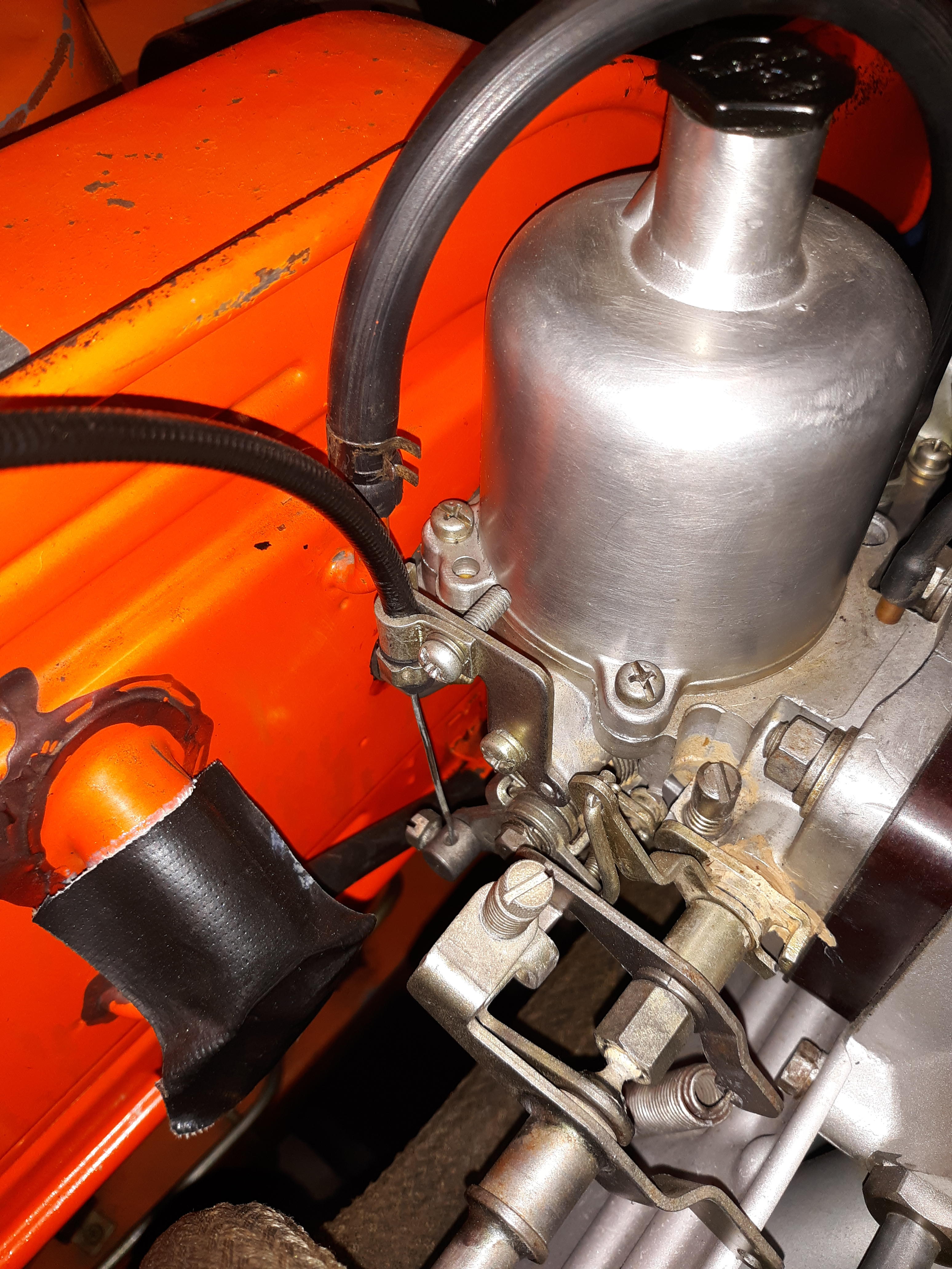

  On 7/14/2020 at 11:35 PM, siteunseen said:

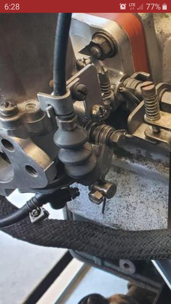

Here's mine with the choke off.
Thanks, it did seem a little stuck on the return.  I unhooked the choke cables and the air flow dropped down to between 15-20.  The throttle adjust is still basically all the way out though so still trying to mess with it.

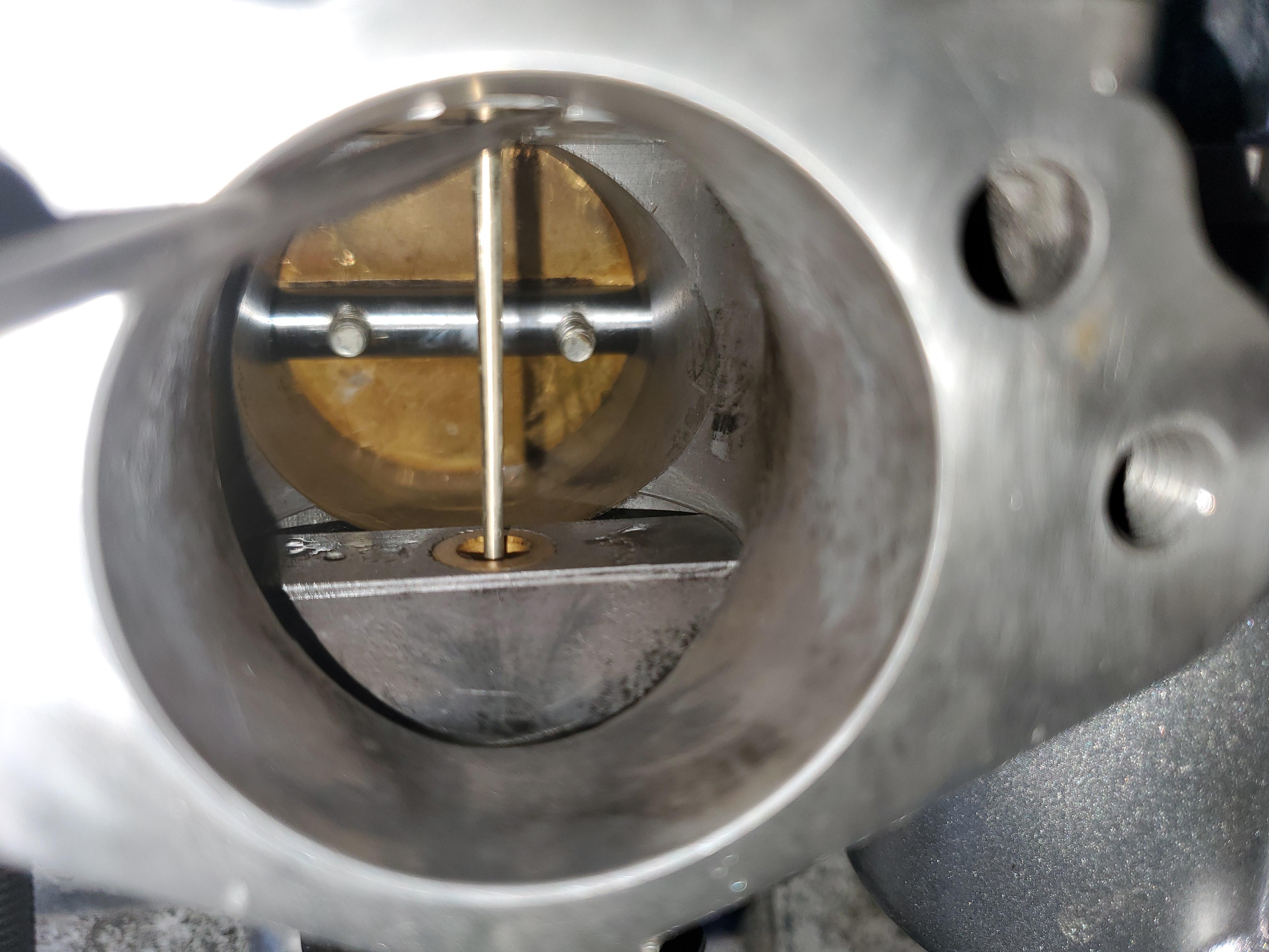

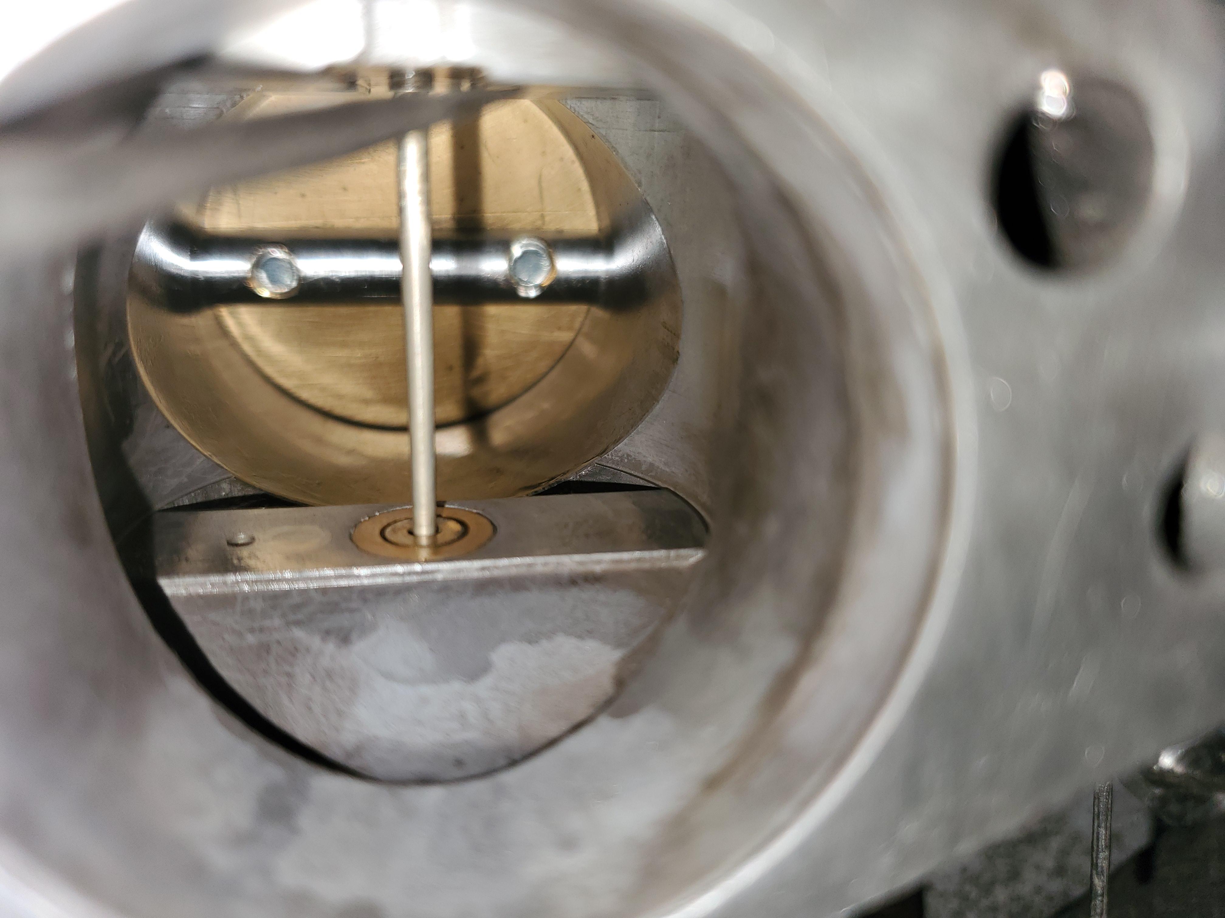

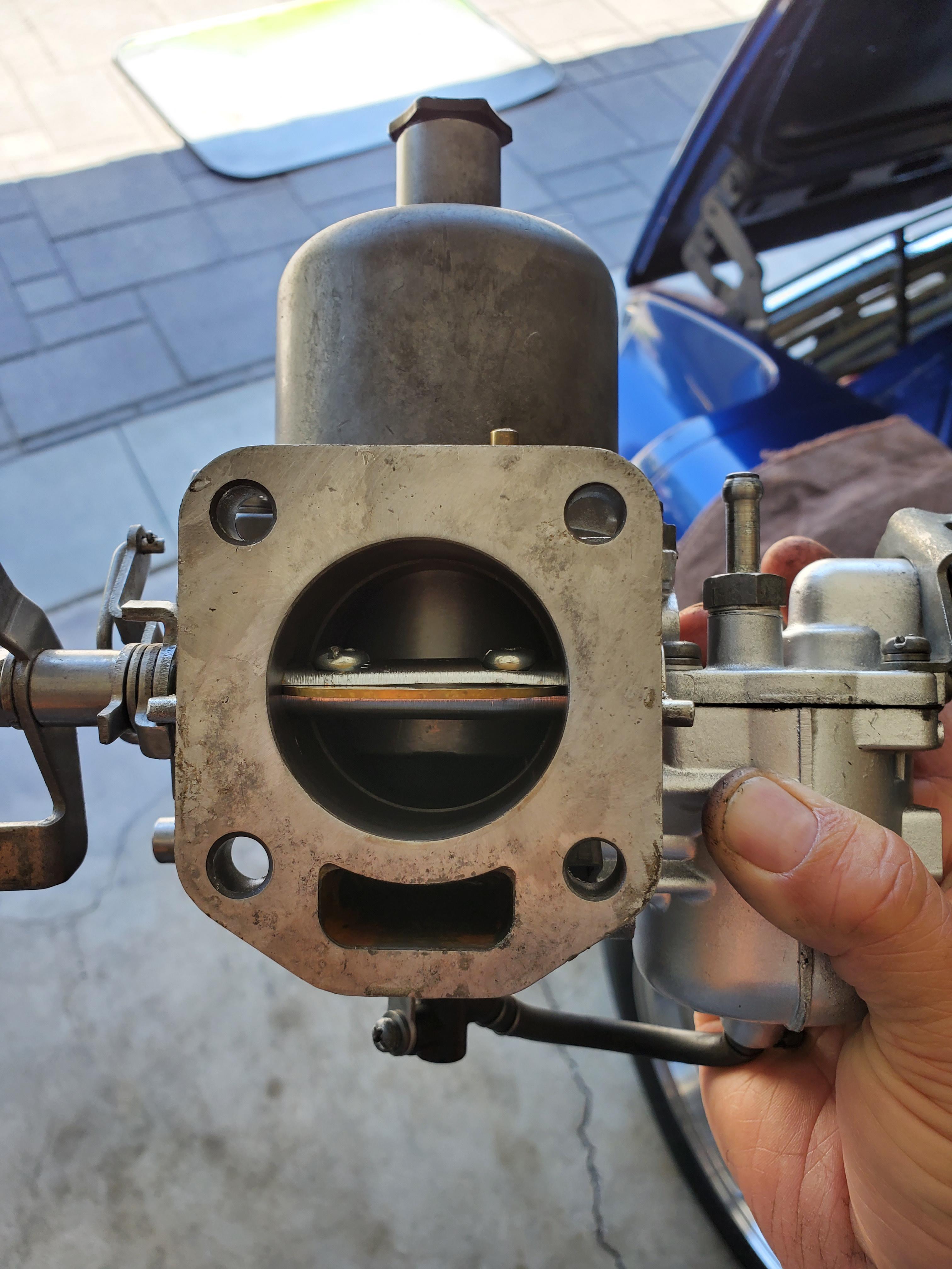

I think I found the problem.  Butterfly had ZERO play and the shaft holding it looks bent...
The shaft screws are normally staked. It looks like someone got a little carried away staking that one. the shafts bend easily...
