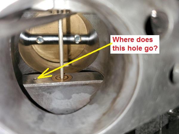

Other question is... There are small (1/8 inch-ish?) holes in the bridges that are intentional. I assume they are 72 specific.
Where do those holes go?  :

And thanks for the pics of that mystery hole, but unfortunately I'm still unclear where that hole goes. It's definitely a 72 specific thing and unfortunately I don't have a pair of those here to poke around with. Thanks again though!
