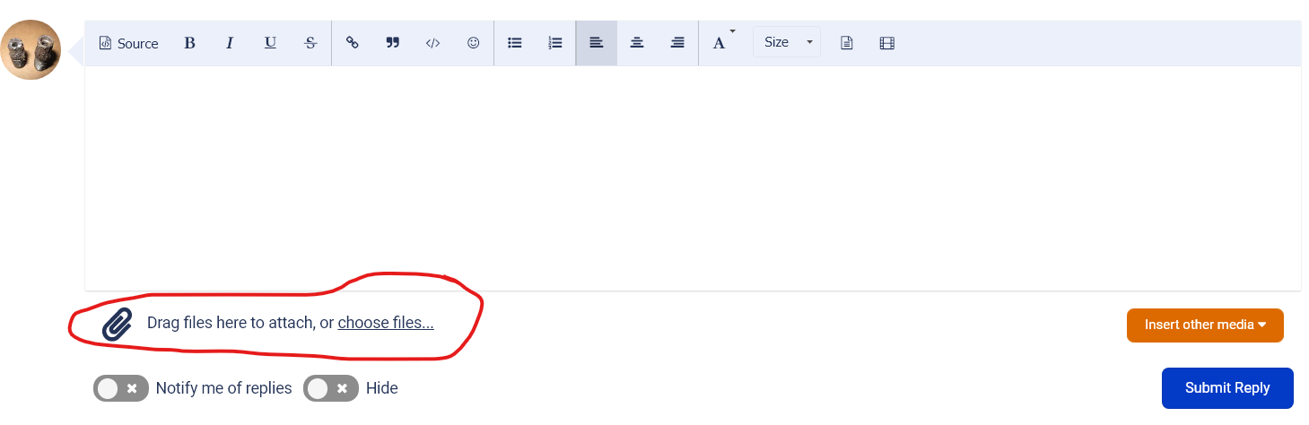

Under what ? I don't see a paperclip anywhere. I pulled all the plugs out of my white Z , cleaned them, primed the cylinder, replaced them & still won't start but it does kick a little like it is trying to start
