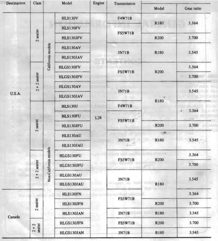

The 79 model year had a huge number of differential options, to go along with all of the trim options.  Find out if you have an R180 or an R200.  The R200 will handle it but not the R180.  You'll want to know the ratio also, there's a bunch.
It's a 180. So what would be the best swap? I have friends saying Ford 9 inch, but not wanting to do a lot of modification if i can help it.  Engine will be a 350 with not crazy horse power. We have begun the front end. Would like to keep as much stock as i can.x

Do the math on your gear ratios before you get one.  That's one of the problems with most V8 swaps,the GM automatic transmissions like "tall" diff ratios.  3.3 and lower, I think.  Hard to find in the R200.  If you're going with a manual then the 3.54 or 3.9 should work.
If all goes to plans, I will be dropping the rear end this weekend to take a look at it. After everything you all have told me, I believe it to be a R200. With that being said my plan was to use a 4 speed 700r4 trans, but this is still early stages of this restoration. I want to make this an automatic, so just looking at options for the rear end.
