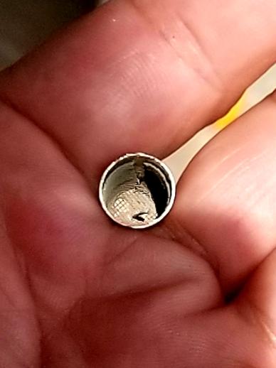

Good morning Cap'n O,
I could not manage to snap a picture inside the can that would show what was in there with artificial lighting. With the help of some diffuse sunlight "by George I've got it". (movie reference. Trying to fit in! [emoji851]).
The only thing that's in the can is a fragment of the broken wire about 3/4" long sticking straight up from the bottom where it is still attached to a point of solder. That's it.
Is there a chance some other component of the thermistor is embedded within the plastic cap?

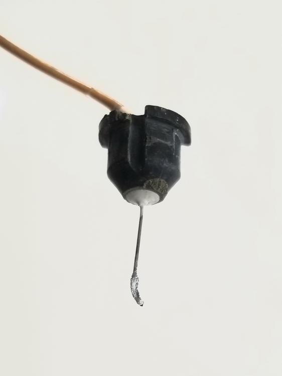

I will be doing an autopsy of my spare defective unit later and reply back with results.

Dr.Dave, Yep... There's the other end!
DaveWM, I assume there used to be some sort of discrete component in there, but honestly I don't know enough about thermistors to answer your good question about just a length of wire that changed it's resistance with temperature. I guess it's a possibility? Maybe?

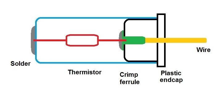

I think it used to look something like this and the thermistor turned to dust:
I also don't think there is anything buried inside the plastic end cap. I think that's just a device to transition from the thermistor lead to the flexible wire.
Edited by Captain Obvious
Updated sketch to show ferrule
You ought to be able to de-solder the lead from the can and then just pull the plastic cap out with the thermistor along with it. (If the whole thing isn't too fragile by now...)
