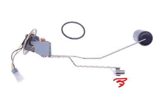

It's "new".  I assume that the offending part is shown here.  Maybe it has numbers on it.  Just noticed that they put "copy of" in the url.
https://zcardepot.com/products/copy-of-fuel-tank-gauge-sending-unit-sender-240z-260z-280z-70-78?_pos=3&_sid=b7ce84965&_ss=r

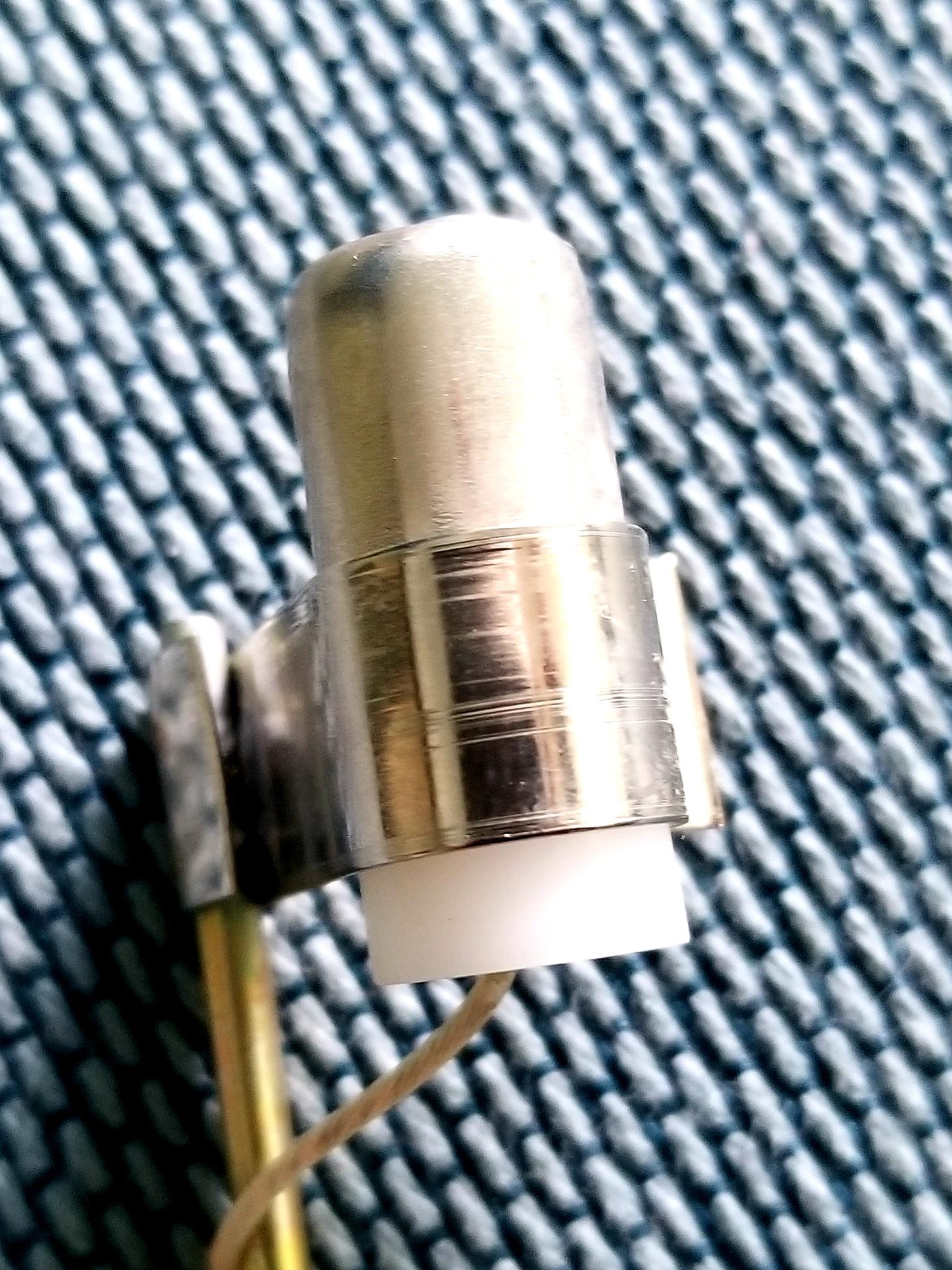

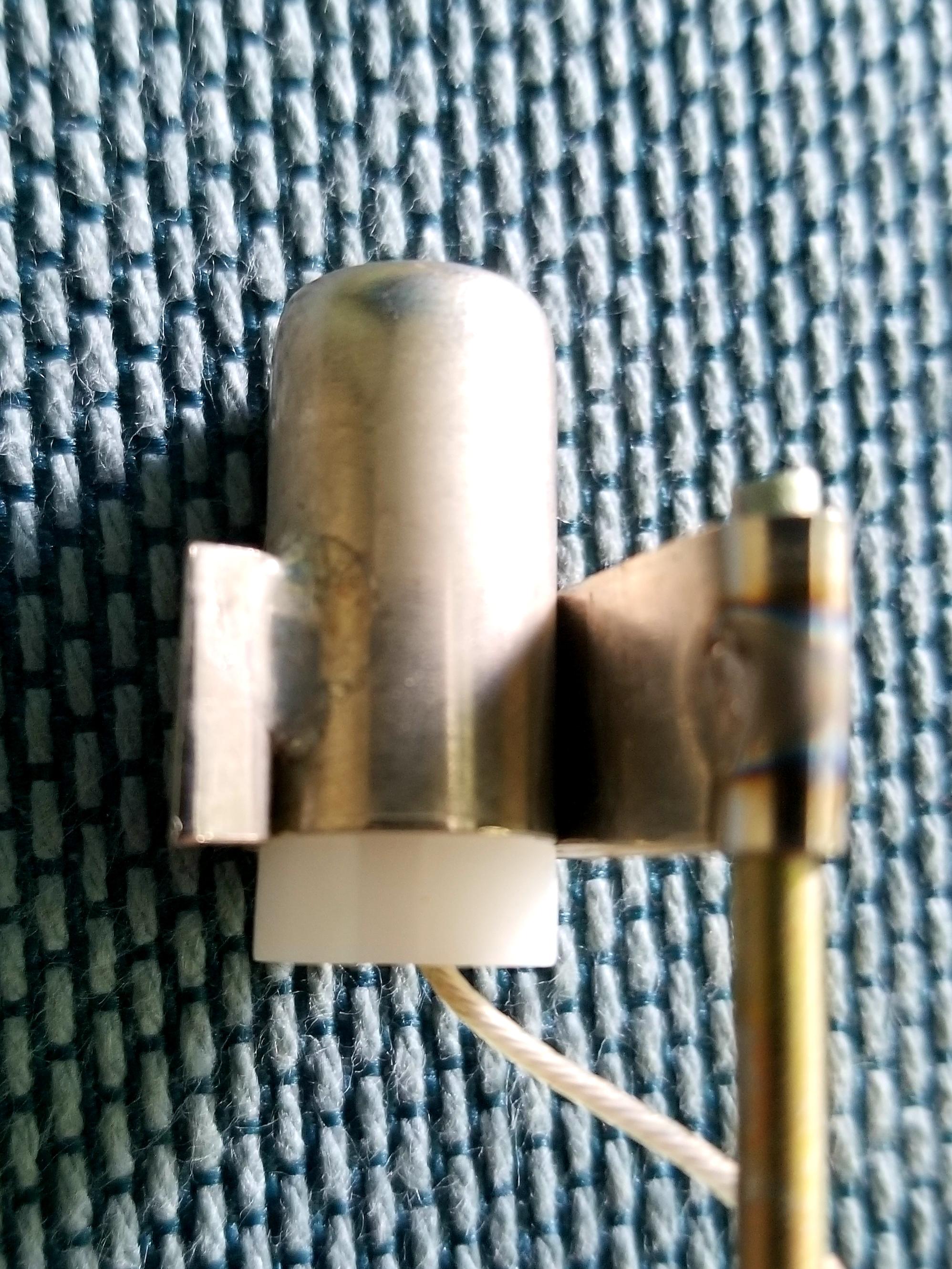

Here are are couple of pics of the Z Car Depot thermistor. It has no markings on it whatsoever. I must say that the whole sender unit seems to be a high quality reproduction. This thermistor issue is unfortunate.
BTW, the pics are from the first sender I received from them which is out of the car. When I notified them of the malfunction they immediately sent out another one which is currently installed in the tank. They are both identical.
If they're the same you have one to experiment on.  Results should translate.  Today's electronics manufacturing processes are all about process control to produce identical parts.  For that type of part you really shouldn't see a defect.  I wonder how many they have sold, and how many have actually been installed.  You might be the first.  p.s. I say they but I think it's just one guy.
I wonder if some of the delay is due to all of the metal surrounding it.  Might be fun to hook it up to a battery and see how warm it gets.
