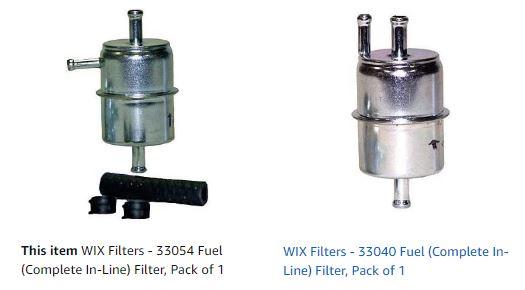

 Getting back to vapor lock, has anyone ever tried installing a Vapor Separator Fuel Filter under the hood?  One inlet and two outlets. One outlet to the carbs and one to the return line. Good up to 75 psi. They were OEM parts on many American cars back in the 1960s and 1970's.Wix 33040 is the one I looked at. I've yet to find one negative review when it comes to solving vapor lock.
The filter Mark is referring to is on the right.  Appears to be for horizontal mounting, as it is important to have the offset return line in the 12 o'clock position.  The left one looks like it is intended to be mounted vertically.   In & out are 5/16"  the return is 1/4".    Amazon,  about 7 bucks.
Thanks Mark,  I think you're on to something!
