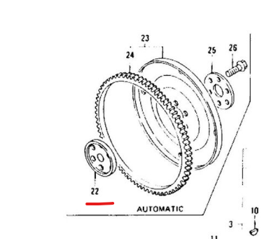

Did the flex plate and spacer/adapters come with the transmission, or did you get them separately?
Did the bolts come with the flex plate and spacer/adapters?  How much thread engagement is there for the bolts?  If the flex plate is too toward the engine the bolts should be too long.

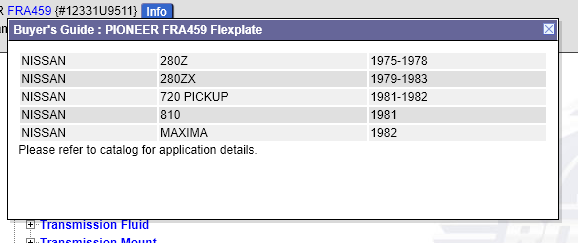

I can't find a distinct break point or how the various parts go together or what the difference is but Rockauto seems to indicate that there was a different flex plate before 1975, and after 1982/1983.
